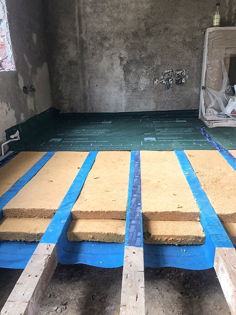

Iceverge Posted April 10, 2023 Share Posted April 10, 2023 (edited) Look at the above picture from the ecological building systems website. It's a good system in my opinion. The thermal resistance of a material is mute until you make sure you can install it properly. The above system makes sure no wind can blow through or around the insulation. PIR will perform worse than the cheapest mineral wool if it's not installed well and the mineral wool is. I would put. Breather membrane draped between joists. Stapled square to the bottom of the joists with all joints taped and returned to the external walls and sealed here too. Good performance mineral wool fitted between the joists. T*G chipboard glued and screwed over the top. If you have space put a layer of PIR over the top of the joists under the chipboard. This will need to be between battens and all joints foamed and taped. Edited April 10, 2023 by Iceverge 2 Link to comment Share on other sites More sharing options...

osprey Posted April 10, 2023 Author Share Posted April 10, 2023 Iceverge, yes I have seen that. My suggestion would be as wind-proof as that, using the same membrane approach. Just with PIR instead of the mineral wool. Incidently, wonder if, with 100mm joists, it would be worth letting the membrane go 20mm below the joist (while still stapling as shown) and fill to joist top.. This would allow mineral wool to achieve U value to closer to 100mm PIR. Link to comment Share on other sites More sharing options...
Iceverge Posted April 10, 2023 Share Posted April 10, 2023 40 minutes ago, osprey said: Iceverge, yes I have seen that. My suggestion would be as wind-proof as that, using the same membrane approach. Just with PIR instead of the mineral wool. Mineral wool and other batt products is that they will fluff out against the sides and each other, really reducing any convection within the insulation layer. Similarly the timber will expand and contract with changes in humidity and temperature and a flexible material will accommodate. With PIR, on the other hand, if you have a 5mm gap at install this will remain for all of time so I would make sure it was foamed with a permanently elastic foam in any case. 45 minutes ago, osprey said: Incidently, wonder if, with 100mm joists, it would be worth letting the membrane go 20mm below the joist (while still stapling as shown) and fill to joist top.. This would allow mineral wool to achieve U value to closer to 100mm PIR. Yes no issues with this so long as you still have a clear ventilation path below of say 50-100mm. If you wanted to do a small bit of woodwork you could go as deeper with a few rips of 9mm OSB tacked onto the sides of the joists to keep it all in place. Link to comment Share on other sites More sharing options...
