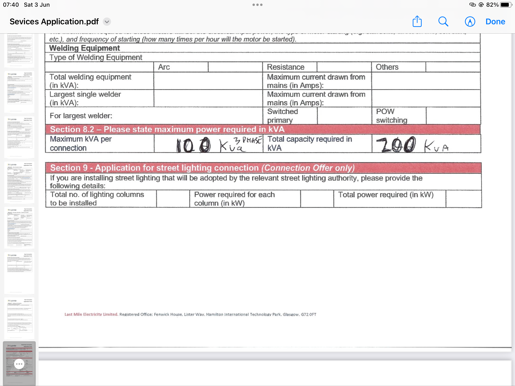

Canski Posted June 3, 2023 Author Share Posted June 3, 2023 (edited) This is what was on the application form. Is this correct ? remember this is for 2 properties. One for me one for my friend. Edited June 3, 2023 by Canski Link to comment Share on other sites More sharing options...
ProDave Posted June 3, 2023 Share Posted June 3, 2023 So you are asking for 200KVA total capacity, 100KVA per house. At 3 phase that is 100A per phase. That's 3 times the maximum that most UK houses have. WHAT was on the quote from 2 years ago? Re car chargers, you need supply capacity for ONE per house. The fact you may install cable for more is irelevant. To out this into contect my house has a 12KVA supply and everything works fine. Link to comment Share on other sites More sharing options...

TonyT Posted June 3, 2023 Share Posted June 3, 2023 Christ, the DNO allow approx 3.5kW per house that enough for a whole estate based in their diversity calculations Link to comment Share on other sites More sharing options...
Canski Posted June 3, 2023 Author Share Posted June 3, 2023 10 hours ago, ProDave said: So you are asking for 200KVA total capacity, 100KVA per house. At 3 phase that is 100A per phase. That's 3 times the maximum that most UK houses have. WHAT was on the quote from 2 years ago? Re car chargers, you need supply capacity for ONE per house. The fact you may install cable for more is irelevant. To out this into contect my house has a 12KVA supply and everything works fine. I resent the original application form because they had ‘lost’ it. Link to comment Share on other sites More sharing options...
