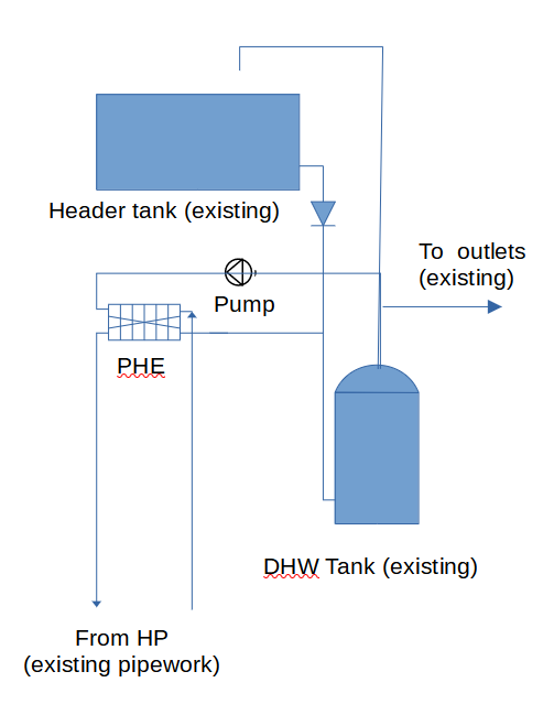

JamesPa Posted April 5, 2023 Share Posted April 5, 2023 Over on the thread about Chelmer Heating there has been a lively (albeit off-topic) discussion about uses for plate heat exchangers. The Mixergy tank (for heat pumps) uses a plate heat exchanger external to the DHW tank, through which is pumped the DHW, thus exchanging heat with the HP flow efficiently without using a coil or taking up volume in the tank. They claim that their cylinder can be configured vented or unvented. Using a PHE instead of an internal coil has a number of interesting effects, some of which may be good and some bad. The way Mixergy have it configured seems to eliminate stratification the DHW tank, which may be good or bad! Like many, I suspect, I have an exiting, fairly new, vented cylinder, which is otherwise perfectly satisfactory but has a coil which is insufficiently large for a heat pump. I am thus faced with replacing it for a new unvented cylinder, involving lots of disruption and cost. So, following the Mixergy example, I came up with this idea which reuses the tank and existing pipework and involves minimal disturbance. I fear it wont work, because the pump will just draw air in from the vent (although I also feel there should be a way to prevent this) and/or from the outlets if they are switched on whilst the pump is on (I could perhaps defeat this by putting the pump upstream of the feed to the outlets rather than downstream as illustrated). The Mixergy has dedicated tappings for the PHE circulator, unfortunately in a retrofit situation the use of existing cylinder tapings is mandatory. Is it completely mad or worth considering? I'm not a fan of throwing away perfectly functional components! Link to comment Share on other sites More sharing options...

JohnMo Posted April 5, 2023 Share Posted April 5, 2023 I would put the pump on the cold side instead of hot, it will always be flooded and less chance of air and get the head available to the fluid level in the header tank. You will need a DHW pump not CH pump. If I get time I will get my set up running at a boiler flow of 50 deg and let you know the temps across the PHE. I need to know for when I get my ASHP fully connected anyway. Link to comment Share on other sites More sharing options...
sharpener Posted April 5, 2023 Share Posted April 5, 2023 33 minutes ago, JohnMo said: I would put the pump on the cold side instead of hot, it will always be flooded and less chance of air and get the head available to the fluid level in the header tank. +1 from me. Have had "pumping over" probs before, this was the solution IIRC. Link to comment Share on other sites More sharing options...

JamesPa Posted April 5, 2023 Author Share Posted April 5, 2023 (edited) 2 hours ago, JohnMo said: I would put the pump on the cold side instead of hot, it will always be flooded and less chance of air and get the head available to the fluid level in the header tank. You will need a DHW pump not CH pump. If I get time I will get my set up running at a boiler flow of 50 deg and let you know the temps across the PHE. I need to know for when I get my ASHP fully connected anyway. Thanks, that's very helpful, I will rethink. On a related, but more philosophical, point, this (interesting but very painful) exercise to retrofit ashp to my house has convinced me that the current 'rip it out and start again according to rigid rules' approach to ASHP won't cut it for much of the retrofit market. Government subsidies can't last forever, and many people either won't, or can't, afford the cost of a complete system rework essentially to replace the boiler. Interestingly upgrading radiators, vitally important in many cases but perceived as difficult, is both cheap and easy, it's the 'peripheral' issues that seem to bug. I think the ASHP manufacturers may be pinning their hopes on high temperature designs which are a drop in replacement, and perhaps the efficiency sacrifice is justified (I personally think they also need to sort modulation ratio, buffer tanks are simply not going to be fitted in many retrofit scenarios or smaller houses). However I suspect we need also both more tools in the armoury (such as the one contemplated in this thread), and a more enlightened workforce, to deal with the myriad of retrofit situations in a way the public can afford/tolerate. On this forum people _are_ themselves experimenting with out of the box things to deal with their specific circumstances, but we need plumbers and heating engineers who can do this for the majority who don't have the design skills themselves. As if to demonstrate this point, today a very nice and clearly intelligent surveyor informed me that the mains water feed to the new UVC they want to put will probably need to be upgraded from 15 mm to 22mm (involving considerable disruption and cost). When I told her that the incoming mains pressure was 9 bar, so flow rate is certainly not a problem, she offered to note it, but told me it would still quite possibly need to be done because 'the cylinder manufacturer recommends it'. I don't doubt this is true, because I have read it myself, but its another example where backside-covering rules-based over specification (I refuse to call it engineering, because it isn't) risks absurd and costly results. Inevitably, unnecessary cost deters many, and unnecessary disposal of perfectly functional equipment is unlikely to be environmentally friendly. More innovation, much better training, more flexibility and just a bit of risk taking is needed if we are to crack this. How to make happen though? Just ramblings for a Wednesday evening, now back to the engineering! Edited April 5, 2023 by JamesPa Typo Link to comment Share on other sites More sharing options...

JamesPa Posted April 6, 2023 Author Share Posted April 6, 2023 (edited) 12 hours ago, JohnMo said: I would put the pump on the cold side instead of hot, it will always be flooded and less chance of air and get the head available to the fluid level in the header tank. Like this? Actually I drew it this way at first, but then got worried that the pump would draw water from the header tank not the DHW tank. I cant quite fathom how to ensure that this doesn't happen Edited April 6, 2023 by JamesPa Link to comment Share on other sites More sharing options...

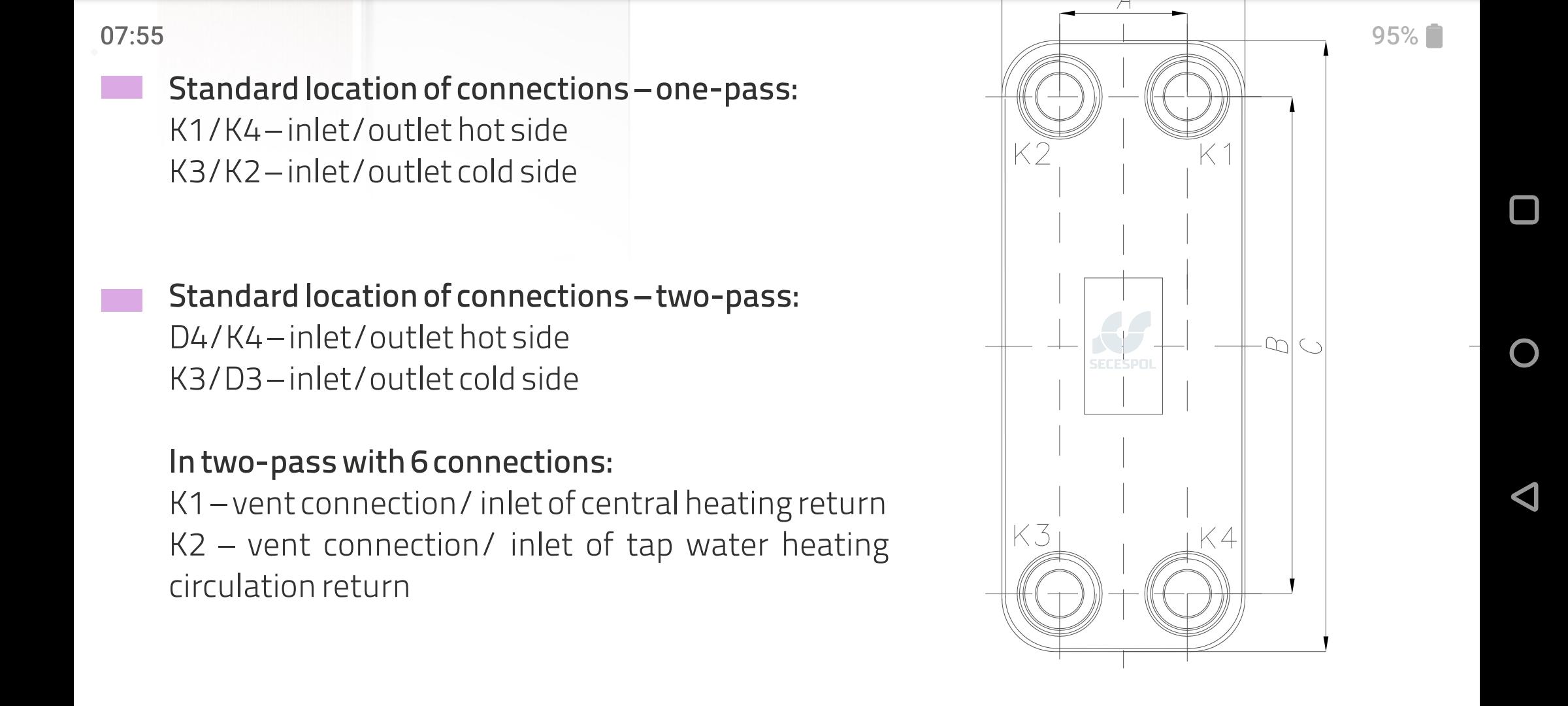

JohnMo Posted April 6, 2023 Share Posted April 6, 2023 Yes for the pump, but mount the pump as low as you can, just above the bottom elbow by the cylinder, this will give the pump the best suction pressure and keep it away from cavitation. For the PHE flows hot from ASHP, need to be on the same side as the hot water going to the cylinder. So you HP flows swop sides. See attached Link to comment Share on other sites More sharing options...

sharpener Posted April 6, 2023 Share Posted April 6, 2023 (edited) 15 hours ago, JohnMo said: Yes for the pump, but mount the pump as low as you can, just above the bottom elbow by the cylinder, this will give the pump the best suction pressure and keep it away from cavitation. +1, This also stops it sucking in air through the shaft gland. 15 hours ago, JamesPa said: Like this? Actually I drew it this way at first, but then got worried that the pump would draw water from the header tank not the DHW tank. I cant quite fathom how to ensure that this doesn't happen It is a puzzle isn't it! Helpful perhaps to draw a diagram with the elements positioned to show the correct relative pressures. As @JohnMo implies upthread, the baseline is the static head at the bottom of the tank i.e. suction side of the pump. From there the pressure rises across the pump and falls again across the HX, leaving a residual delta P as the motive force for the flow through the tank, and this last term will also raise the level in the overflow pipe. If it is less than the height from the water level in the header tank to the top of the overflow bend the pump will push the water through the DHW tank, if it is more then it will pump over into the header tank. In one house that had a vented system I remember increasing the height of the overflow bend by a foot or so to cope with turning the pump up a notch. In your setup however I expect most of the resistance and hence most of the pressure drop will be across the HX and not much needed for the tank. As a further puzzle, does it help if instead of abandoning the coil you put it in series with the HP feed to the HX (or possibly the return)? After scratching my head I can't be sure which if either will give an advantage. But from first principles increasing the total heat exchange surface area can only be a good thing. I guess its actual usefulness will depend on the relative areas of the two. Also, from my previous work on MVHR air-to-air HXs I recall that the dwell time in the system is some kind of figure of merit, and this would increase as well. Edited April 6, 2023 by sharpener Link to comment Share on other sites More sharing options...

JohnMo Posted April 7, 2023 Share Posted April 7, 2023 7 hours ago, Nickfromwales said: Doesn't the above schematic omit the flow switch? Not sure I would use one, mine failed in less than a week. Use the thermostat to open/close a relay, use the relay to call for heat and start/stop the pump. No need to open the wet parts of the system to fix anything, if/when it does go wrong. Link to comment Share on other sites More sharing options...
