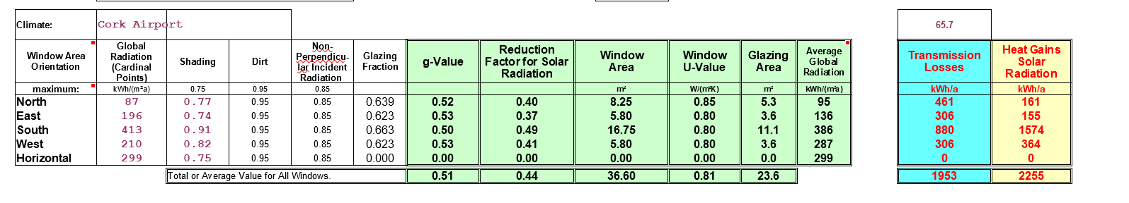

Radian Posted April 3, 2023 Share Posted April 3, 2023 4 hours ago, Iceverge said: However at night or in winter it'll require a lot of heating to stay hot. Let's assume you have an outdoor temp of 5 Deg and want 20 deg inside. You spec really really top class windows with an installed U value of 1w/m2K. Now let's say the extension has a glass area of 50m2 and a floor of say 16m2 at a U value of 0.15 w/m2K. Heat loss floor is 16m2 X 0.1w/m2K X (20deg-5deg) = 36w Heat loss glass box is 50m2 X 1W/m2K X (20deg-5deg) = 750w. For context this about half the heat load of our entire 185m² passive house for your 16m². Ok in California or the Mediterranean with warm temps all year around. Elsewhere its costly to run. I've run all the numbers like that on our garden room as well, although the glazed are is only 30m2 and you're right - it does look pretty terrifying. But the one thing missing from your calculation is the annual heat gain available. When this is taken into account, the added amenity of having large areas of glazing (if the plot suits it) can make it very much worth it IMO. While it's easy to do the heat loss calculation, in practice it seems a lot more difficult to work out the overall figure when offsetting by the gains. Empirically, taken over the full year, I can't even say it's obvious that a nett loss is involved (although it probably is). The potential for overheating seems considerably greater, but if the orientation and other things that can be done to manage the issue are in place, I don't think the option to use large amounts of glazing should be automatically discounted. Just as overhangs and Brise Soleil can play a part in keeping the space cool in Summer, so thermal blinds or curtains can reduce losses in the winter. Both are desirable for optical reasons as well. Link to comment Share on other sites More sharing options...

Iceverge Posted April 3, 2023 Share Posted April 3, 2023 (edited) 6 hours ago, Radian said: I've run all the numbers like that on our garden room as well, although the glazed are is only 30m2 and you're right - it does look pretty terrifying. But the one thing missing from your calculation is the annual heat gain available. When this is taken into account, the added amenity of having large areas of glazing (if the plot suits it) can make it very much worth it IMO. While it's easy to do the heat loss calculation, in practice it seems a lot more difficult to work out the overall figure when offsetting by the gains. Empirically, taken over the full year, I can't even say it's obvious that a nett loss is involved (although it probably is). From our own PHPP Losses are indeed offset by gains but we have pretty good windows. However without the South facing glazing it would be a loss. 6 hours ago, Radian said: I don't think the option to use large amounts of glazing should be automatically discounted. Just as overhangs and Brise Soleil can play a part in keeping the space cool in Summer, so thermal blinds or curtains can reduce losses in the winter. Both are desirable for optical reasons as well. Sadly with this it's lightly that it'll loose the simple beautiful glass boxiness of the design as there'll be too many add ons. You may end up at a place where aesthetically you'd be better off with less glazing. @Radian is your garden room above inside the heated envelope? I think there's a place for a highly glazed room outside the main body of the house to be used as a solar air heater amongst other things like below. Edited April 3, 2023 by Iceverge 1 Link to comment Share on other sites More sharing options...

Radian Posted April 4, 2023 Share Posted April 4, 2023 20 hours ago, Iceverge said: is your garden room above inside the heated envelope? A bit of both really. It's built as an extension on the back of the house and retains the original DG French Windows so we can close it off thermally - but it has a dedicated UFH zone that's fed from the gas boiler . I'm aware that this needs frost protection if we were to close it off but that's not how it's used. 20 hours ago, Iceverge said: Losses are indeed offset by gains but we have pretty good windows. Your windows are much better than mine! But thanks for posting your PHPP figures. Do they not confirm my contention that "excess glazing" can be a benefit if managed correctly? Link to comment Share on other sites More sharing options...
Iceverge Posted April 4, 2023 Share Posted April 4, 2023 @joe90 SOLAR CONSERVATORY PASSIVE HOUSE GLENGARIFFE IRELAND VIKING (cherrymortgages.com) this one? 3 hours ago, Radian said: Do they not confirm my contention that "excess glazing" can be a benefit if managed correctly? Yes, the issue becomes cold weather I think. There will be days that you have little sunshine and low temperatures so an over glazed heated envelope will need lots of heat input. A hypothetical house with no window's in the main body, just super insulated shutters opening onto a south facing conservatory could perform very well. Try selling that idea to a human however and they'll tell you where to shove it! 1 Link to comment Share on other sites More sharing options...
