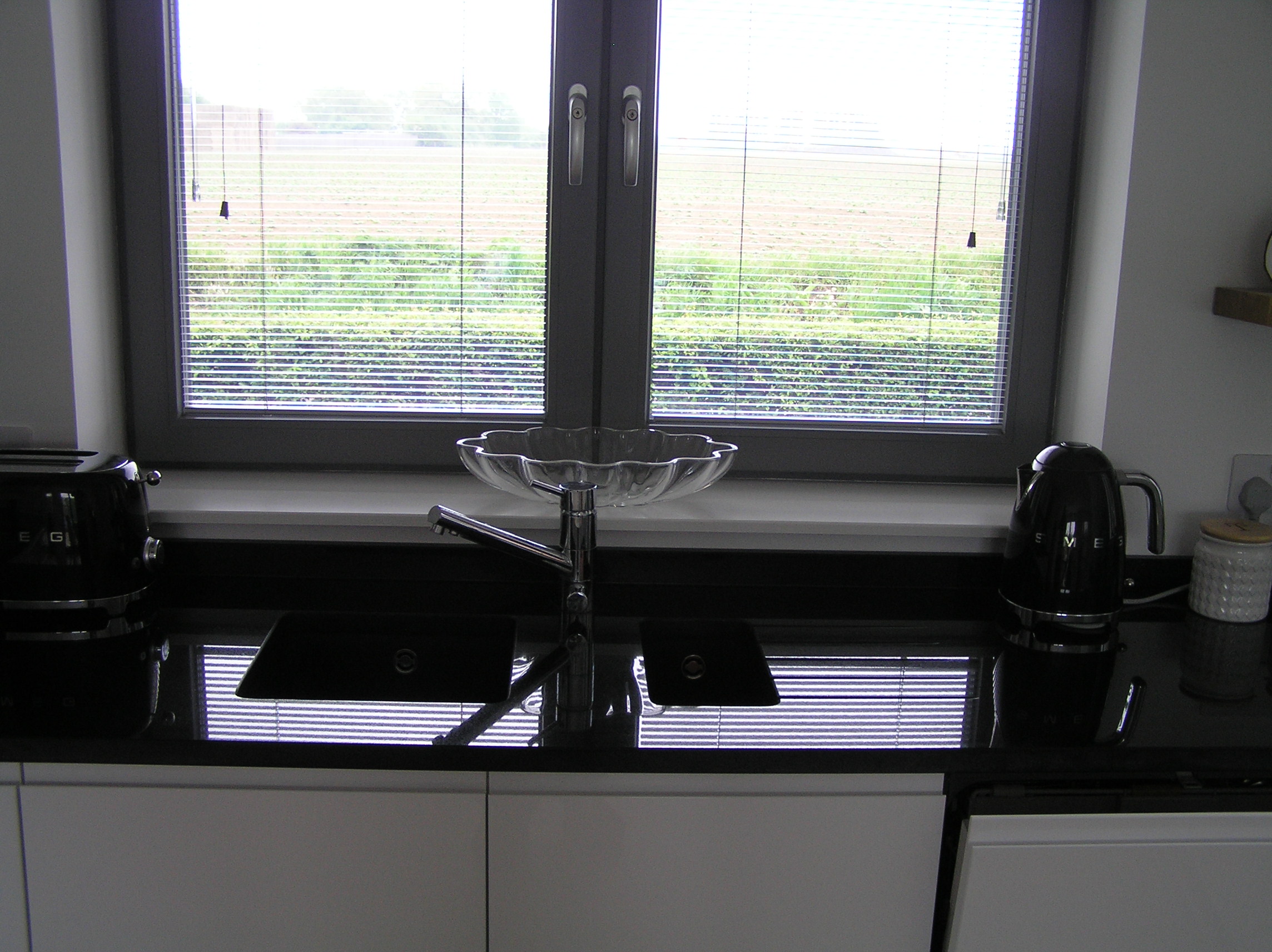

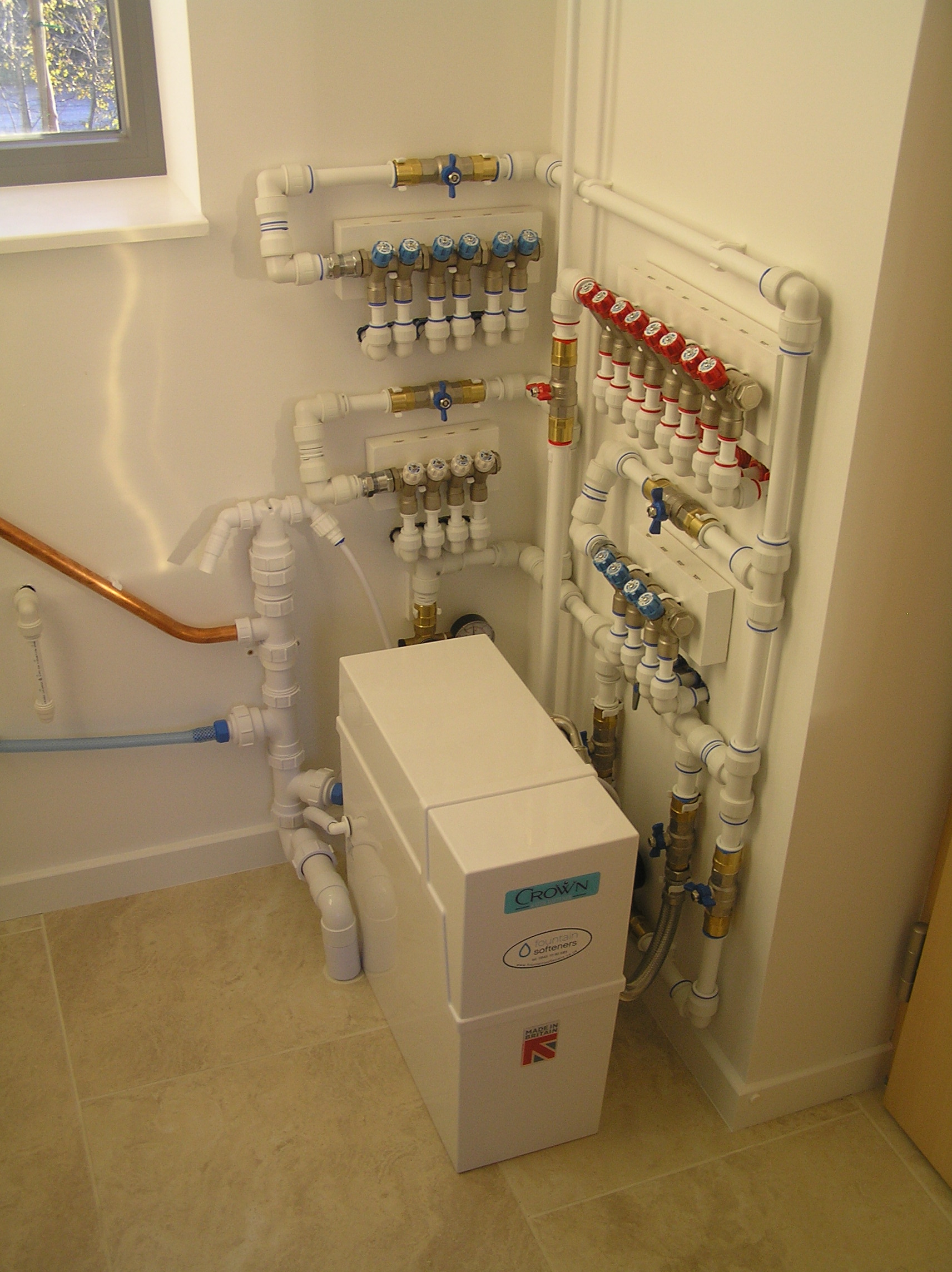

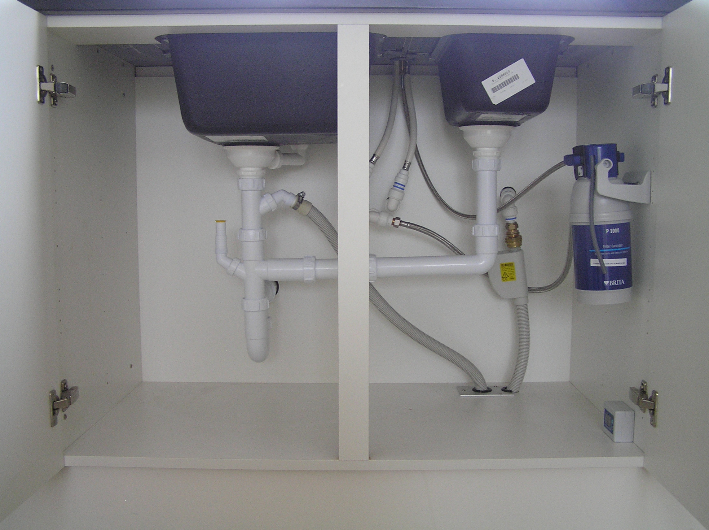

I fitted a water softener on our mains supply but fitted it after a seperate supply for drinking water and toilet cisterns. I fitted a water filter under the sink supplying a three way tap. In the first picture, the manifold with the white taps is hard water.

In our case our private water supply is moderately hard so border line whether it needed softened or not. I’ve decided to fit one. We have two supplies coming from the treatment plant room to the house. Softened and raw for drinking.
You have a serious set up.  My plumber hasn't been as through as that.   I think having a sink filter before the tap is the way to go on this.  Will what you have remove salt?
Link to comment
Share on other sites
I'm not sure about that, but I've attached the PDF. The P1000 filter is supposed to remove water hardness but it would probably be an expensive way of doing it if your water hardness is high. Our hardness was very high hence why we had a softener.
