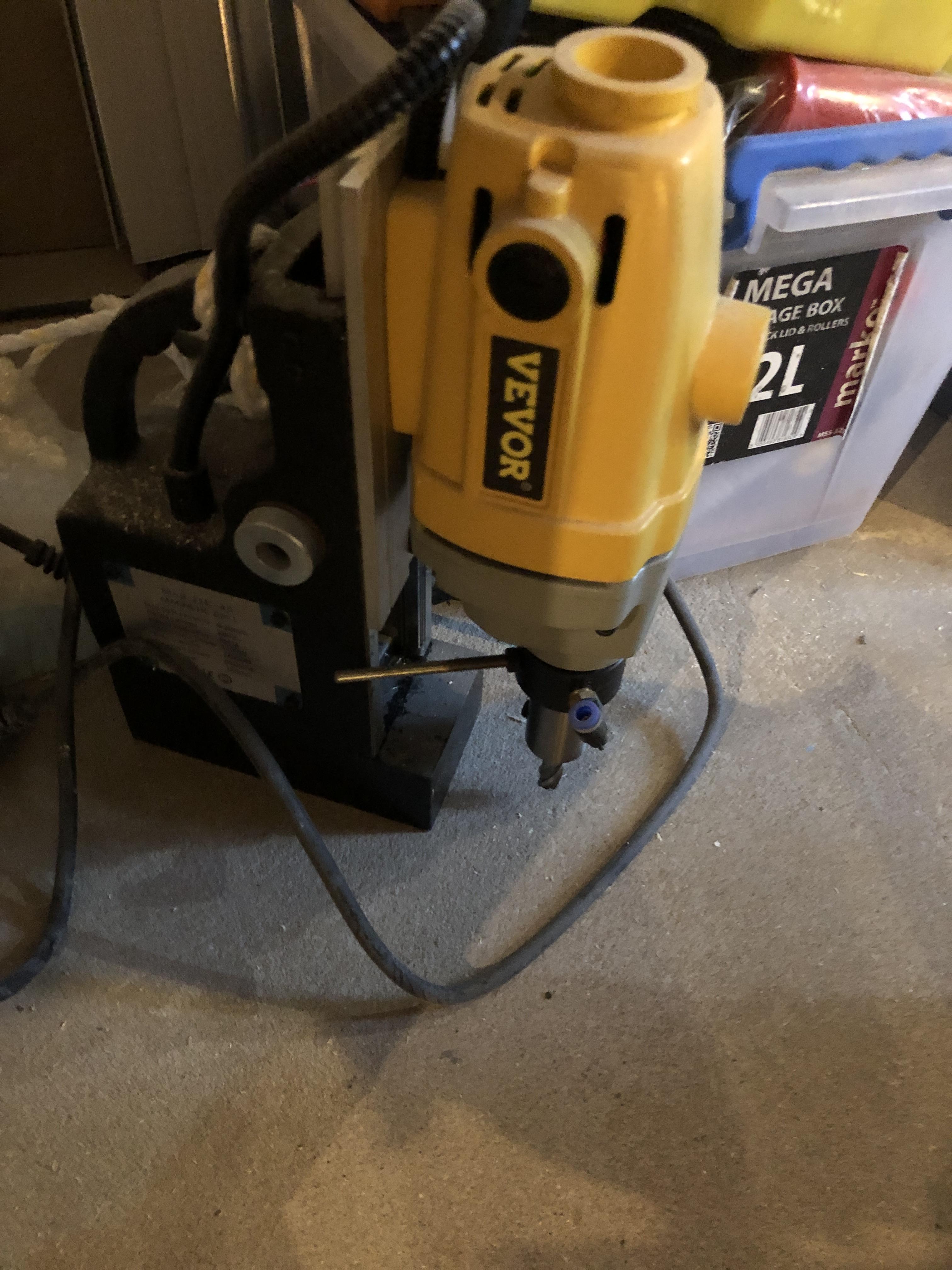

Pocster Posted March 18, 2023 Share Posted March 18, 2023 (edited) Wow ! What timing ! Monday I will be drilling my steel !! Bought from Amazon ; plan to sell it when done . Tested ages ago on 1 hole . Slow and steady no issues . Edited March 18, 2023 by pocster Link to comment Share on other sites More sharing options...

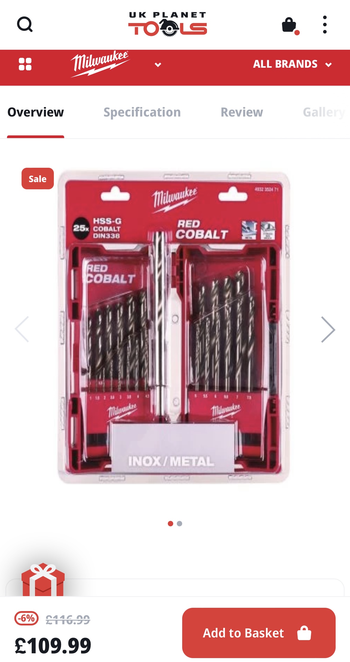

Cpd Posted March 19, 2023 Share Posted March 19, 2023 I am just about to buy a new set, as my old ones are pretty knackered, after a bit of research I am heading for the following. We will see…. Link to comment Share on other sites More sharing options...
JohnMo Posted March 19, 2023 Share Posted March 19, 2023 Any HSS drill bit will do it, as long as it's a real one, not cheap Chinese ones. The import bit is applying the correct pressure, this doesn't come from a hand drill, unless you are drill small holes. You need coolant also. 1 Link to comment Share on other sites More sharing options...

Pocster Posted March 19, 2023 Share Posted March 19, 2023 Nice and steady with mag drill . Occasional wd40 on tip . No worries Link to comment Share on other sites More sharing options...
Pocster Posted March 20, 2023 Share Posted March 20, 2023 Near accident … I wear gloves and proper goggles as this drill spits the metal out . I wear glasses and the goggles won’t fit over them . So I drill semi blind …. Decided to turn the drill off but couldn’t see the writing in it which said “ electromagnetic “ . Shit me up a bit when it fell …. 🙄 1 Link to comment Share on other sites More sharing options...
Pocster Posted March 20, 2023 Share Posted March 20, 2023 Before anyone asks no where to tie drill to in event of this or power failure . Anyway who wants a 20 kg drill swing into their face . Link to comment Share on other sites More sharing options...

Pocster Posted March 20, 2023 Share Posted March 20, 2023 22 minutes ago, saveasteading said: You should have drilled another hole above first, to hook the safety line. There are goggles that fit over specs. Worth looking for. I think mind came off some official "look at our project" site visit. But where are they? Yeah , I’ve got a full face mask ( fine with glasses ) but steams up in 1 second . Done the other holes now . Once each is done ; I leave the drill and magnet running then change glasses . Tbh I think even blind folded I know which switch not to touch . Link to comment Share on other sites More sharing options...
saveasteading Posted March 20, 2023 Share Posted March 20, 2023 For the record. Size of hole and thickness of steel, and how long to cut including setting up? Link to comment Share on other sites More sharing options...
Pocster Posted March 20, 2023 Share Posted March 20, 2023 (edited) 1 hour ago, saveasteading said: For the record. Size of hole and thickness of steel, and how long to cut including setting up? Hole 10mm . Depth of steel 20mm Probably once going ( I take it steady ) 3 minutes to cut hole . Cleaning up the metal ‘ splinters ‘ ( they go everywhere- 20 mins . Setting up a few minutes . Turning off magnetic when you shouldn’t means shutting down takes 5 seconds . 😁 Edited March 20, 2023 by pocster 1 Link to comment Share on other sites More sharing options...
Pocster Posted March 20, 2023 Share Posted March 20, 2023 I’m working around stuff as we live on site I.e everything gets in the (expletive deleted)ing way . If a complete empty room I could probably do 20 holes an hour maybe by pushing the bit in harder and not fannying around . Link to comment Share on other sites More sharing options...
