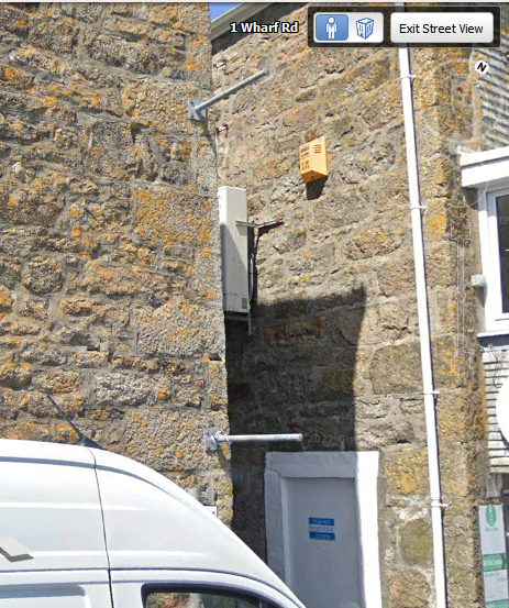

SteamyTea Posted March 16, 2023 Posted March 16, 2023 Loads of ASHP down on the harbour side at St. Ives. They often get a good soaking from a decent south west hoolie. To be honest, I can't think of one that is showing signs of corrosion. Here is one that has been there years. 1
