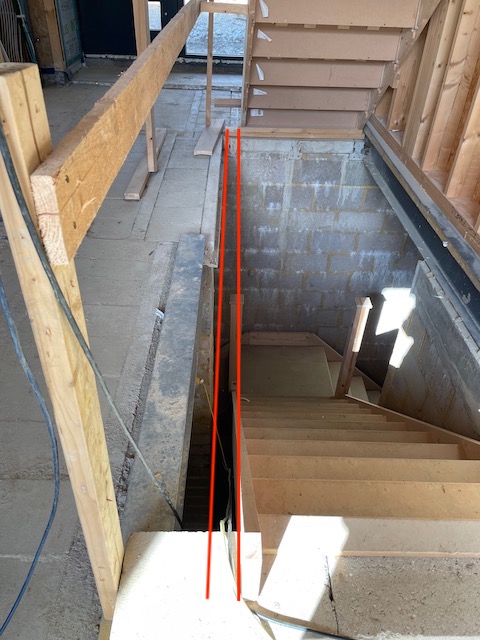

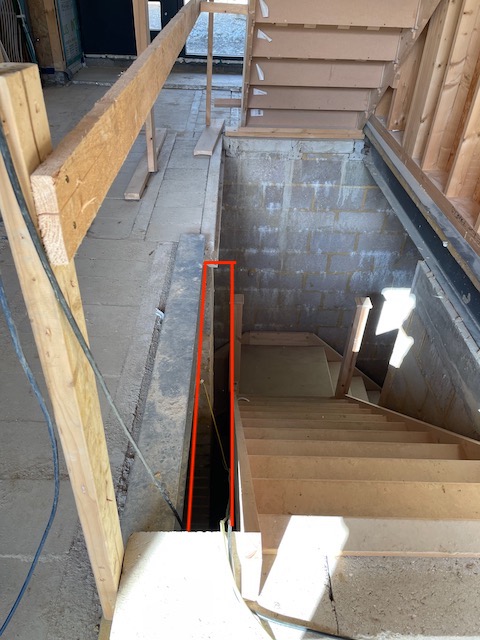

Thorfun Posted March 14, 2023 Share Posted March 14, 2023 I need to figure out how to widen my hallway to fill in a bit of void down to the basement where the red lines are shown below. so the hallway need to come out by about 120mm. I discussed this with a friend and he suggested getting another beam to sit alongside the existing one (pretty much where the red lines are) which I thought was a good idea although I'd still need to fill in the gap between the steel and the new beam. one end of the beam could sit in an existing steel in this area circled red: which you can see if I look down the existing beam but the other end doesn't have any where to sit or be supported: my friend suggested a steel 'hanger' of some kind bolted/fitted to the existing beam but I didn't find anything like that on a Google search so guess it'd have to be bespoke? I will need to build a wall going down to the basement floor to stop sound coming up the stairs as shown below: so that could also help to support the beam as it goes in to the steel but that wall would only go to about here and half the beam would be unsupported. so, after all those pictures finally some questions: 1. how would be best to support the other end of the beam? 2. can anyone think of a better solution? Link to comment Share on other sites More sharing options...
Canski Posted March 14, 2023 Share Posted March 14, 2023 I’m sure I have seen some sort of shoe in the past that hangs down off a beam. Have you spoken to the beam manufacturers ? If not I’m sure one could be made. Or … timber? Link to comment Share on other sites More sharing options...

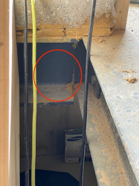

Temp Posted March 14, 2023 Share Posted March 14, 2023 It's only 120mm. Im thinking fill in the web on the steel and concrete with timber. Then bolt several joists together to make up 120mm and fix to the infill. Might need some steel straps wrapped around and fixed to the blocks to keep everything tight up against the beams. At the unsupported end it might be possible to push the tails of a long tailed joist hanger under what's there and fold it down and fix to the other side of the wall. Or fix a wall plate to the wall across the stairs and fix to that. . 1 Link to comment Share on other sites More sharing options...
Thorfun Posted March 14, 2023 Author Share Posted March 14, 2023 1 hour ago, Canski said: I’m sure I have seen some sort of shoe in the past that hangs down off a beam. Have you spoken to the beam manufacturers ? If not I’m sure one could be made. not spoken to the beam manufacturers. it's worth a shout, thanks. 1 hour ago, Canski said: Or … timber? 57 minutes ago, Temp said: It's only 120mm. Im thinking fill in the web on the steel and concrete with timber. Then bolt several joists together to make up 120mm and fix to the infill. Might need some steel straps wrapped around and fixed to the blocks to keep everything tight up against the beams. At the unsupported end it might be possible to push the tails of a long tailed joist hanger under what's there and fold it down and fix to the other side of the wall. Or fix a wall plate to the wall across the stairs and fix to that. . interesting, hadn't really thought about using timber as there'll be screed going on top and figured a concrete beam would be stronger to take that weight than timber. I could build that wall in the basement in timber as well and make the verticals double/triple thick to take most of the weight of the timber joists as well. interesting and worth thinking about. I'll investigate joist hangers or wall plates. thanks for the tips. Link to comment Share on other sites More sharing options...

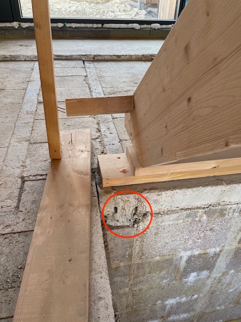

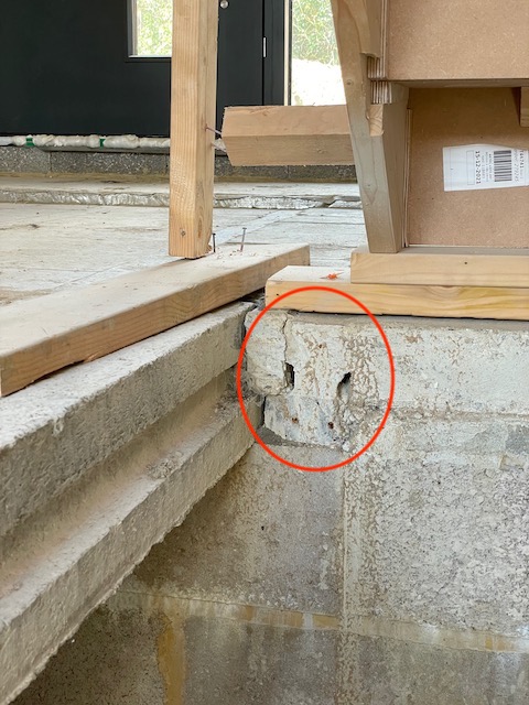

Thorfun Posted March 15, 2023 Author Share Posted March 15, 2023 so, an apology is required from me for this for being a d**k! I got a laser out and lined it up with where I needed to bring the hallway in to and it appears I've already done the work on the end where the beam is and simply forgot about it! for some reason I still thought I had to bring that in a bit. I remember doing it now. I removed the blocks and moved the beam to the right (which is why it's overhanging the wall below slightly) and then infilled with new blocks. all done well over a year ago so I could be forgiven for forgetting as so much else has happened since. anyway, so I'm now down to having to build out from the steel to line up with the beam. what do you think? shot fire timber through the steel and build out with timber from there with it also sitting in the horizontal steel? then I'll build a timber wall below it to fill the gap from below and the staircase will eventually be made wider to fully fit the stairwell. Link to comment Share on other sites More sharing options...
Dave Jones Posted March 15, 2023 Share Posted March 15, 2023 stud/timber. Link to comment Share on other sites More sharing options...
Thorfun Posted March 15, 2023 Author Share Posted March 15, 2023 5 minutes ago, Dave Jones said: stud/timber. yeah. that's what i've done before for fixing to steels. shot fired timber through the steel and then build out from that timber with more timber. figured i could do the same here now. Link to comment Share on other sites More sharing options...
Canski Posted March 15, 2023 Share Posted March 15, 2023 3 hours ago, Thorfun said: yeah. that's what i've done before for fixing to steels. shot fired timber through the steel and then build out from that timber with more timber. figured i could do the same here now. I'd drill and bolt if you can or tek screw. We used to shot fire to steels but not anymore due to the nails corroding and breaking off. Pity really because it was fast and made the site managers jump out of their skin if they were hovering around us. Link to comment Share on other sites More sharing options...

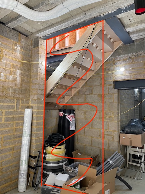

ProDave Posted March 15, 2023 Share Posted March 15, 2023 Are you not building some form of wall to fill the gap between the stair and the edge of the opening? If so the wall you build would support the extra beam? Link to comment Share on other sites More sharing options...
Thorfun Posted March 15, 2023 Author Share Posted March 15, 2023 9 minutes ago, Canski said: I'd drill and bolt if you can or tek screw. We used to shot fire to steels but not anymore due to the nails corroding and breaking off. Pity really because it was fast and made the site managers jump out of their skin if they were hovering around us. corroding even internally? Link to comment Share on other sites More sharing options...
Thorfun Posted March 15, 2023 Author Share Posted March 15, 2023 1 minute ago, ProDave said: Are you not building some form of wall to fill the gap between the stair and the edge of the opening? If so the wall you build would support the extra beam? yes but the stairs are temporary and the final stairs will be wider to fill the gap. the wall below in the basement will be built up to be level with the existing beam so it ends up being vertical all along. so the new wall will support some of the beam. as such, I'm now not worried at all. 🙂 I just need to build the wall, fill in between the steel and the wall and then shutter it for when the screed goes down so that doesn't pour down the stairwell! (I hope that makes sense) Link to comment Share on other sites More sharing options...

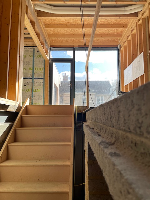

Conor Posted March 21, 2023 Share Posted March 21, 2023 We had exactly the same scenario. I fixed a 6x2" to the side of the slab using 180mm concrete screws, then fixed another on top with just woodscrews. A bit of ply on the face to act as shuttering for the screed. No issues and job done in an hour. The plasterboard fitted to the edge and then shoe rail for the ballustrading. 1 Link to comment Share on other sites More sharing options...
