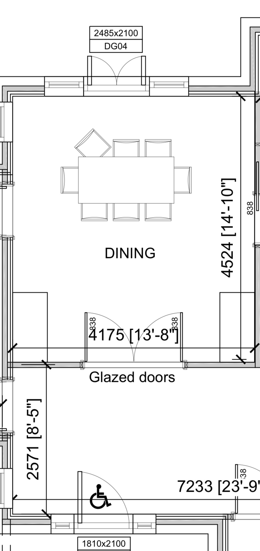

Selfbuildsarah Posted March 9, 2023 Share Posted March 9, 2023 Should we centre the glazed doors into the hall with the French windows? Originally felt the glazed doors should be centred on the wall into the hall, particularly as we have the 2 identical sideboards both sides, where they have to be positioned. They are probably going to be sliding, all glass (part etched) doors rather than opening doors as shown. I find it difficult picturing myself in either the dining room or hall and deciding which will be the least jarring. Link to comment Share on other sites More sharing options...
Wumpus Posted March 9, 2023 Share Posted March 9, 2023 Just my take, without understanding how it looks from the outside, but I would centre all three on the same line - front door, French doors and glazed doors? Centre on the dining room/table so you can see through the side windows front to back. 2 Link to comment Share on other sites More sharing options...

Conor Posted March 9, 2023 Share Posted March 9, 2023 Centre it. Our architect taught us to prioritise the feel and look room by room, rather than the building as a whole from the outside.yoy spend a lot, lot more time living in a space, than looking at it from the outside. We positioned skylights to be central within rooms, rather than uniform across the roof from the outside. Best approach as hardly noticeable from the outside. 3 Link to comment Share on other sites More sharing options...

Temp Posted March 9, 2023 Share Posted March 9, 2023 For me the issue would be having to walking around the dining table if this is a frequent route. So I might move both doors to one side. But that's just me. Link to comment Share on other sites More sharing options...
Papillon Posted March 10, 2023 Share Posted March 10, 2023 Can you split the difference? the glazed doors inside look good, it would irk me if they weren’t inline with the back doors. It’s possible this won’t show in the rear elevation but we can’t tell without you showing it to us. The glazed doors on the outside look tiny are you sure they are all in proportion. Link to comment Share on other sites More sharing options...

SimonD Posted March 11, 2023 Share Posted March 11, 2023 On 09/03/2023 at 12:07, Selfbuildsarah said: I find it difficult picturing myself in either the dining room or hall and deciding which will be the least jarring. I think it's almost impossible to picture how the space will be, even with 3d rendering. I would suggest that if you can (e.g you're having stud walls), you delay the decision until the space has actually been built then you can properly get a feel for it. However, something that jars with me looking at the drawing is the positioning of both the french doors and the accessible doorway - there's something very odd about the flow and balance of these together with the french doors. It makes me wonder who has designed the layout and their experience in design as it may affect the balance and function of the rooms as a whole. Just a thought.. 1 Link to comment Share on other sites More sharing options...
Pocster Posted March 11, 2023 Share Posted March 11, 2023 One of those chairs isn’t straight . Upsetting me more than door placement Link to comment Share on other sites More sharing options...

mattman Posted April 4, 2023 Share Posted April 4, 2023 Definitely line all three up so as you walk in the front door you see all the way through the house (so the centre of the front door, centre of the glazed doors and centre of french doors is all lined up). I would leave the internal glazed doors as they are (because it works practically for you) and shift the french doors and front door slightly so all three line up. One thing possibly to bear in mind is if you shift the position of the french doors or front door, I would try and ensure any first floor windows directly above them are also shifted so they remain centred directly above the french doors / front door (as long as it remains practical inside). That's my opinion. I'm no architect though. 1 Link to comment Share on other sites More sharing options...
LaCurandera Posted April 9, 2023 Share Posted April 9, 2023 (edited) I don't think they have to be automatically centred, but I do think that it feels that's nothing intentional at the moment. It might be a trick of the eye, but the front door doesn't look centred in that nook, slightly too far left. The glazed doors are in the middle of that wall when you're inside the room, but if the hallway had any storage (where the 2571 numbers are) then glazed doors would feel "pushed over" towards the right corner. Then the external French doors just feel like they're made up. Are they in the middle externally? As others have said, 100% focus from the inside, as they feel too far left to me, regardless of the other doors. Edit: And I would say of the three, get the glazed and french doors correct is first priority. Also, remember that while the front door opens, there'll be a natural tendency for eyeline to be affected by the door. So if you were stood at the door and entering, you'll likely be looking/walking more like 1 o'clock, than perfectly straight ahead. So I would move the external french doors over to the right, then have the front door line up with the glazed doors aperture on the left side (it roughly does now if you look at the doors, maybe a smidge to the right). Edited April 9, 2023 by LaCurandera Link to comment Share on other sites More sharing options...
