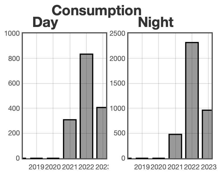

Conor Posted March 7, 2023 Posted March 7, 2023 We're on economy 7 overnight tariff. Approaching a full year and I've it setup to run only in this time. I'll take some meter readings and see how it's working out. However, I know most of our use is likes of the dishwasher and washer dryer. It's more of a challenge to used that stuff off peak than the heating. If you go down this route, you have to shift most of your usage to the off-peak time. Think about how this would work for you. If you've an electric car tho, no brainer.

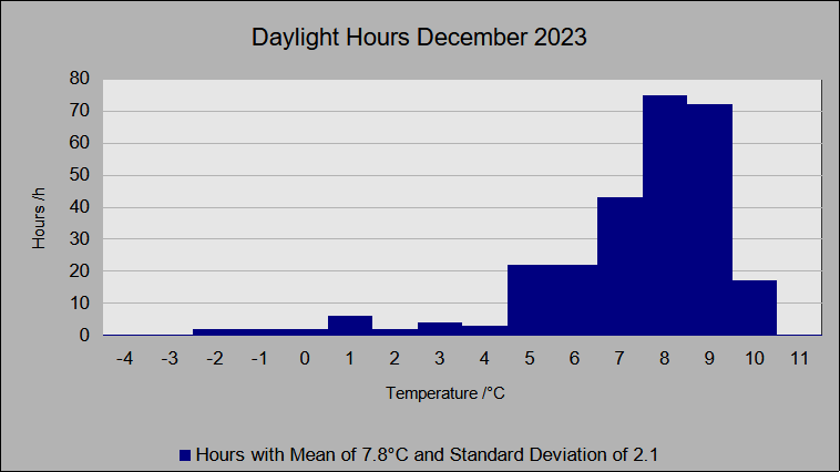

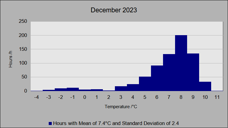

HughF Posted December 30, 2023 Posted December 30, 2023 Very mild in the south west too… 12 degrees the other day.
SteamyTea Posted December 31, 2023 Posted December 31, 2023 11 hours ago, HughF said: Very mild in the south west too… 12 degrees the other day. I am quite high up, so a bit cooler. This is until today. And this is daylight hours.
