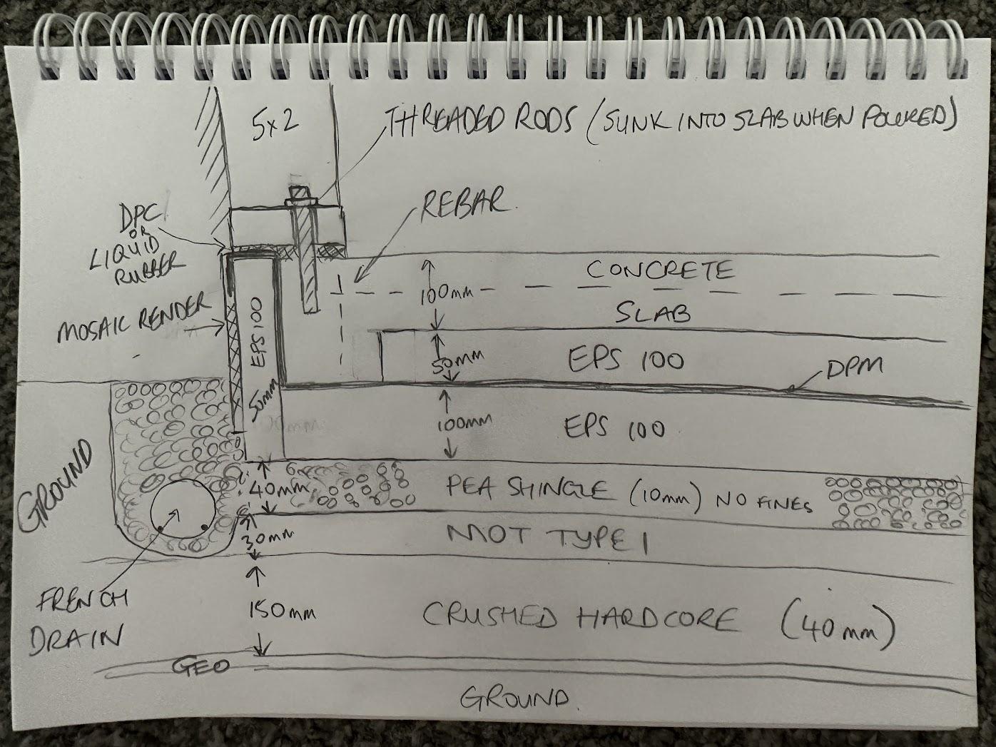

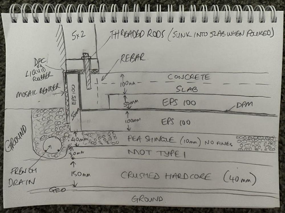

Ticky Posted April 30, 2023 Author Share Posted April 30, 2023 So, how does this look? Any tips on the size of the piping used for the drain? Link to comment Share on other sites More sharing options...
Iceverge Posted April 30, 2023 Share Posted April 30, 2023 Looks fine. Mesh will be easier than Rebar I would say. Link to comment Share on other sites More sharing options...
Ticky Posted April 30, 2023 Author Share Posted April 30, 2023 26 minutes ago, Iceverge said: Looks fine. Mesh will be easier than Rebar I would say. Thanks, I actually thought they were the same thing. What should I be looking at is it the A142 type? with mesh spacers to hold them up? Link to comment Share on other sites More sharing options...
Ticky Posted April 30, 2023 Author Share Posted April 30, 2023 Also, not sure I got the question about levelling/compacting the pea shingle. This is the bit that I’m most nervous about as most other concrete slab foundations look like they sit on type1 and sand. Paranoid as I don’t want to mess this bit up obviously. Link to comment Share on other sites More sharing options...

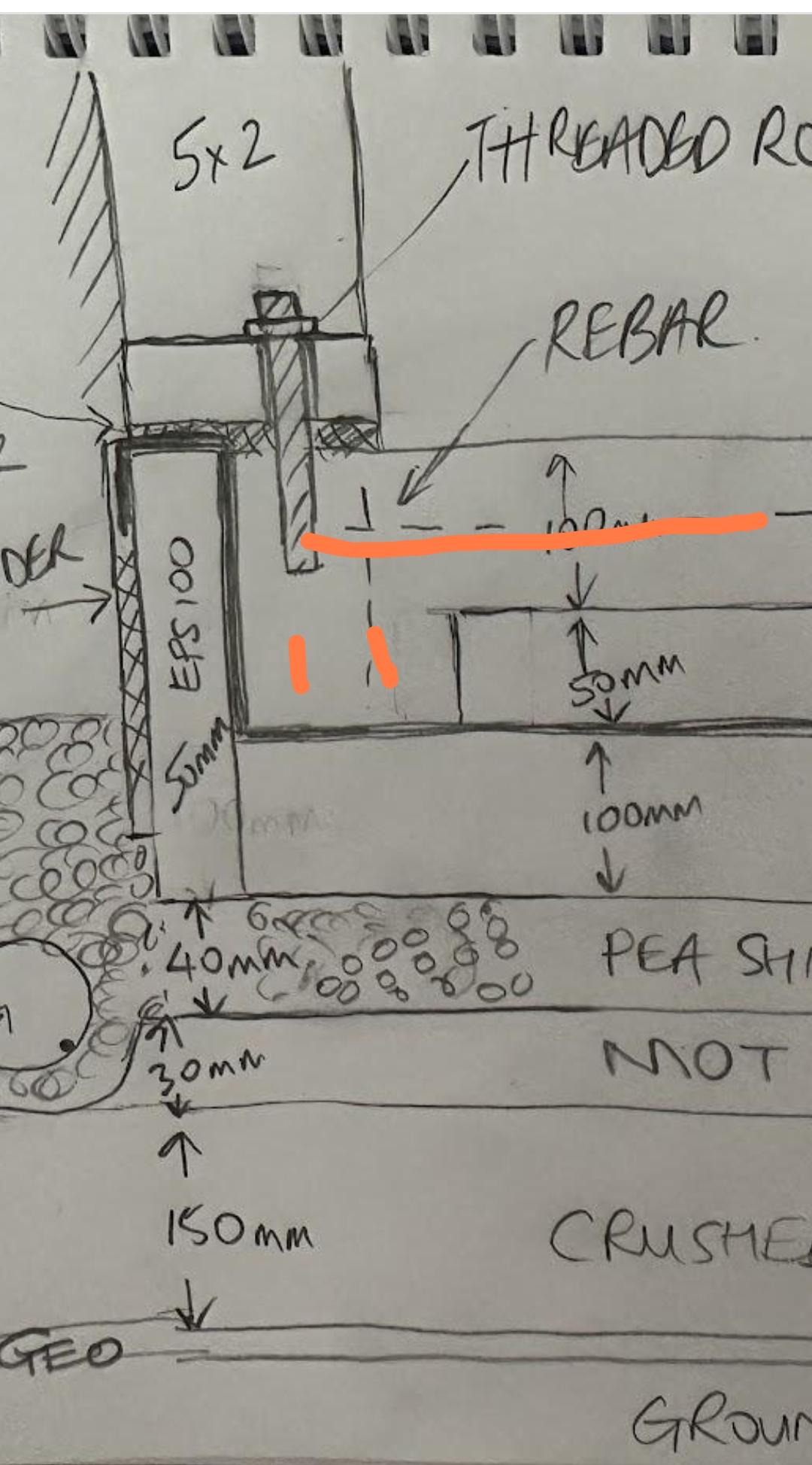

IanR Posted April 30, 2023 Share Posted April 30, 2023 No need to compact the pea shingle, just rake it level. I'd say you don't need 150mm of hardcore, 100mm - 120mm is enough with the type 1 you have on top (save the dig). A142 mesh is fine for horizontal, but I'd use 6mm or 8mm rebar vertically in the ring beam at 300 centres, tied to the mesh, then a long horizontal rebar 25mm from the bottom of the ring beam tied to the verticals. You could pierce the DPM and push the verticals into the EPS, and stick some Duct tape around the holes you've made. It would help stabilise the rebar for the pour. 1 Link to comment Share on other sites More sharing options...
Ticky Posted April 30, 2023 Author Share Posted April 30, 2023 34 minutes ago, IanR said: No need to compact the pea shingle, just rake it level Why is that? Is that because it should 'self level' in a way? 35 minutes ago, IanR said: use 6mm or 8mm rebar vertically in the ring beam at 300 centres, tied to the mesh, then a long horizontal rebar 25mm from the bottom of the ring beam tied to the verticals. I'm struggling to visualise that.... would that be 1 row of verticals? and then 4 long horizontals going round the perimeter to make a rectangle? Link to comment Share on other sites More sharing options...
saveasteading Posted April 30, 2023 Share Posted April 30, 2023 The layer of gravel confuses me. Am I forgetting some need for it? Gravel moves all over the place so can't be walked on. Rebar is jargon for steel reinforcing bars. Mesh is made of bars at preset centres for convenience in slabs. If the bars are different sizes, remember that the big ones may have to go in a certain direction. My other concern is that the floor plate sits on a narrow strip of concrete. Also the fixing is very near the edge and likely to fail. And take it deeper....the first 25mm doesn't provide worthwhile resistance. With that tiny amount of side insulation, I'm not sure that the 200mm under the slab is necessary. It's just all a bit weird. Sorry I don't have time to draw something else up. On the other hand, I assume it won't be used an awful lot, and nobody is sleeping in it, so it is somewhere between a garden shed and a house. Link to comment Share on other sites More sharing options...

saveasteading Posted April 30, 2023 Share Posted April 30, 2023 17 minutes ago, Nickfromwales said: threaded bar in whilst pouring I prefer threaded bar in epoxy, at least a week after pouring. 1 Link to comment Share on other sites More sharing options...
Iceverge Posted April 30, 2023 Share Posted April 30, 2023 4 hours ago, Ticky said: Thanks, I actually thought they were the same thing. What should I be looking at is it the A142 type? with mesh spacers to hold them up? A142 might be a small bit weedy. Maybe a sheet of A252 would be better I would happily place it in the slab as shown. One or two pieces of rebar around the perimeter would make a good job out of it. As shown by the dots below. Frankly it's a lightweight garden room. It ain't goin anywhere MR. Link to comment Share on other sites More sharing options...

IanR Posted April 30, 2023 Share Posted April 30, 2023 (edited) 4 hours ago, Ticky said: Why is that? Is that because it should 'self level' in a way? You are compacting the other layers to get rid of any voids, but pea shingle won't have any. If you did compact you'd push the pea shingle down into the Type 1 and then it would not do its job, which is to be free draining so that it clears any water to the French drain. It's not self levelling, so you are going to have to set yourself up some levels and then rake it to those levels. 4 hours ago, Ticky said: I'm struggling to visualise that.... would that be 1 row of verticals? and then 4 long horizontals going round the perimeter to make a rectangle? Yes, I believe you've understood my description. Hopefully this sketch doesn't make it worse. Black is mesh, blue is rebar: 1 hour ago, LA3222 said: Is it just me or is drifting into the realms of OTT? It's not just you, my first post in this thread, the third post of the thread started with: Quote Here's my go at an over-engineered insulated raft, for a Garden Office. When I posted my original sketch. But, while we now have a view on the wall construction, we don't know the roof structure or finishes, it could be tile. In the future maybe there could be some PV. Maybe the floor finishes will be unforgiving to any movement, such as a ceramic or porcelain tile straight on to the slab. As part of an insulated slab (the title of the thread) the integrated ring beam is a very simple solution to de-risk the floor in my view. 4 hours ago, saveasteading said: With that tiny amount of side insulation, I'm not sure that the 200mm under the slab is necessary I believe we established it's an unheated floor, or at least I made that assumption in an earlier post. It would be nice to see more, but for an occasional use room with an unheated floor, I think what is shown is better than most. Edited April 30, 2023 by IanR Link to comment Share on other sites More sharing options...
