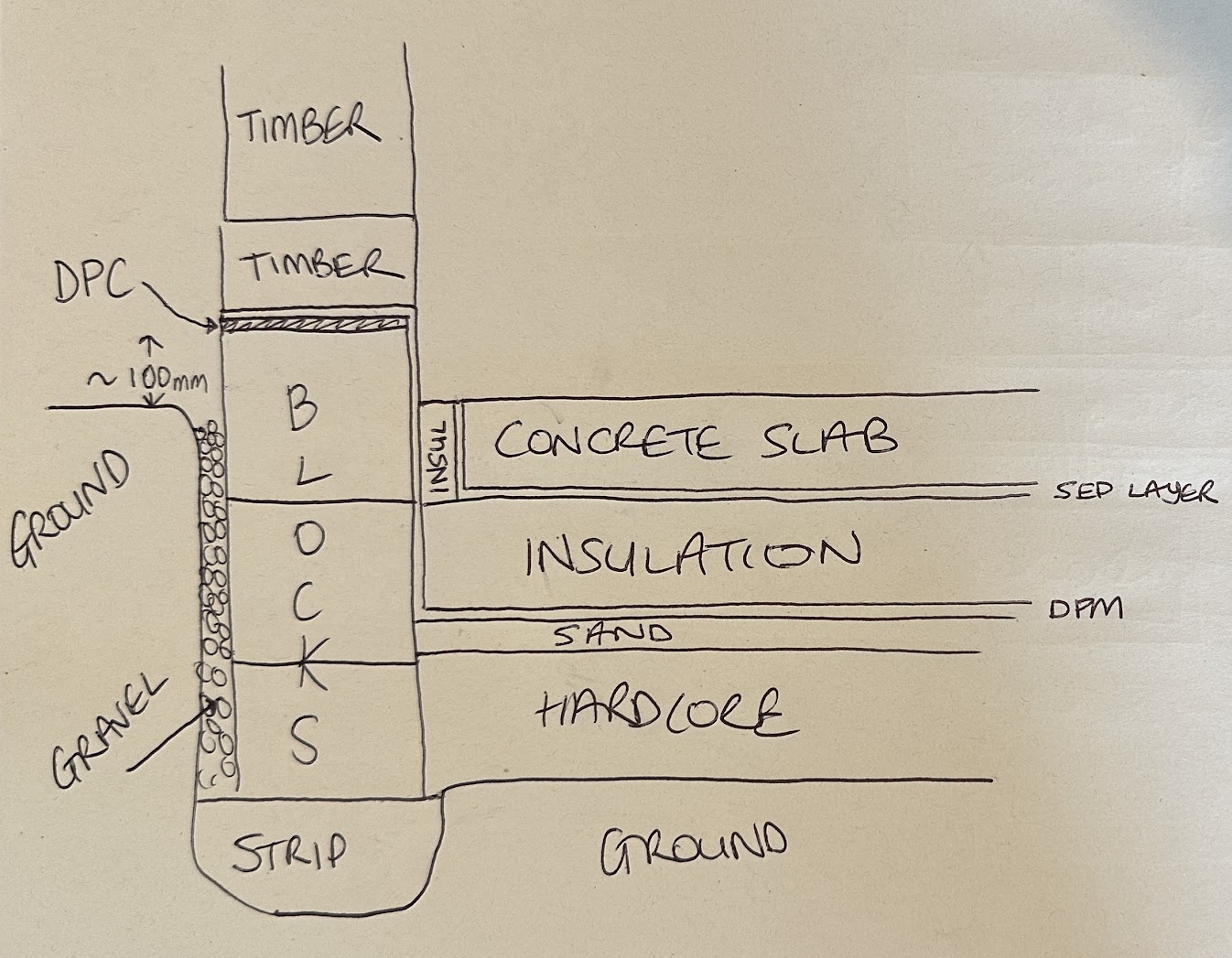

Why not a simple strip foundation blocks on that, nothing to complex needed inside the blocks, harcore,  sand DPM, insulation with upstand around perimeter, with concrete screed or floating wood on PIR.
Do the blocks below ground mostly, have 50 to 100mm showing above ground, build from there.  Gravel around the external perimeter to limit rain splash. Job done. It's not a 100 year design life, like a house.
Something like this @JohnMo ?
Am i right in thinking that the blocks would be the same depth as the timber that would be fixed on top of it?
In my head this seems like a much simpler approach and less to worry about regarding exposing the insulation to heavy load/moisture
You can get the blocks 100 or 140/150 wide. But you may be able to have block less wide than the wall and carry up the perimeter strip to the base of the wooden walls, to remove the thermal bridge as the block comes out of the ground.
Yep, I had that as an after thought about the perimeter strip. Thanks @JohnMo
I guess with this strip foundation design I could interchange the position of the slab and insulation?
@Iceverge does this help me overcome the concerns you were pointing out? as my floor level will remain close to ground level.

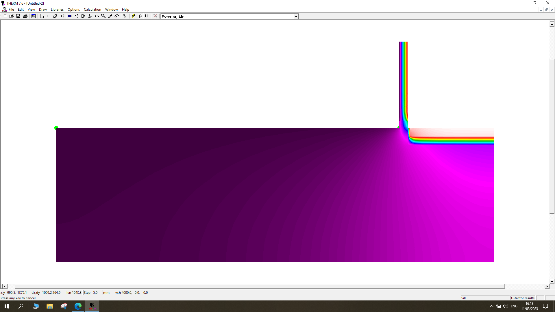

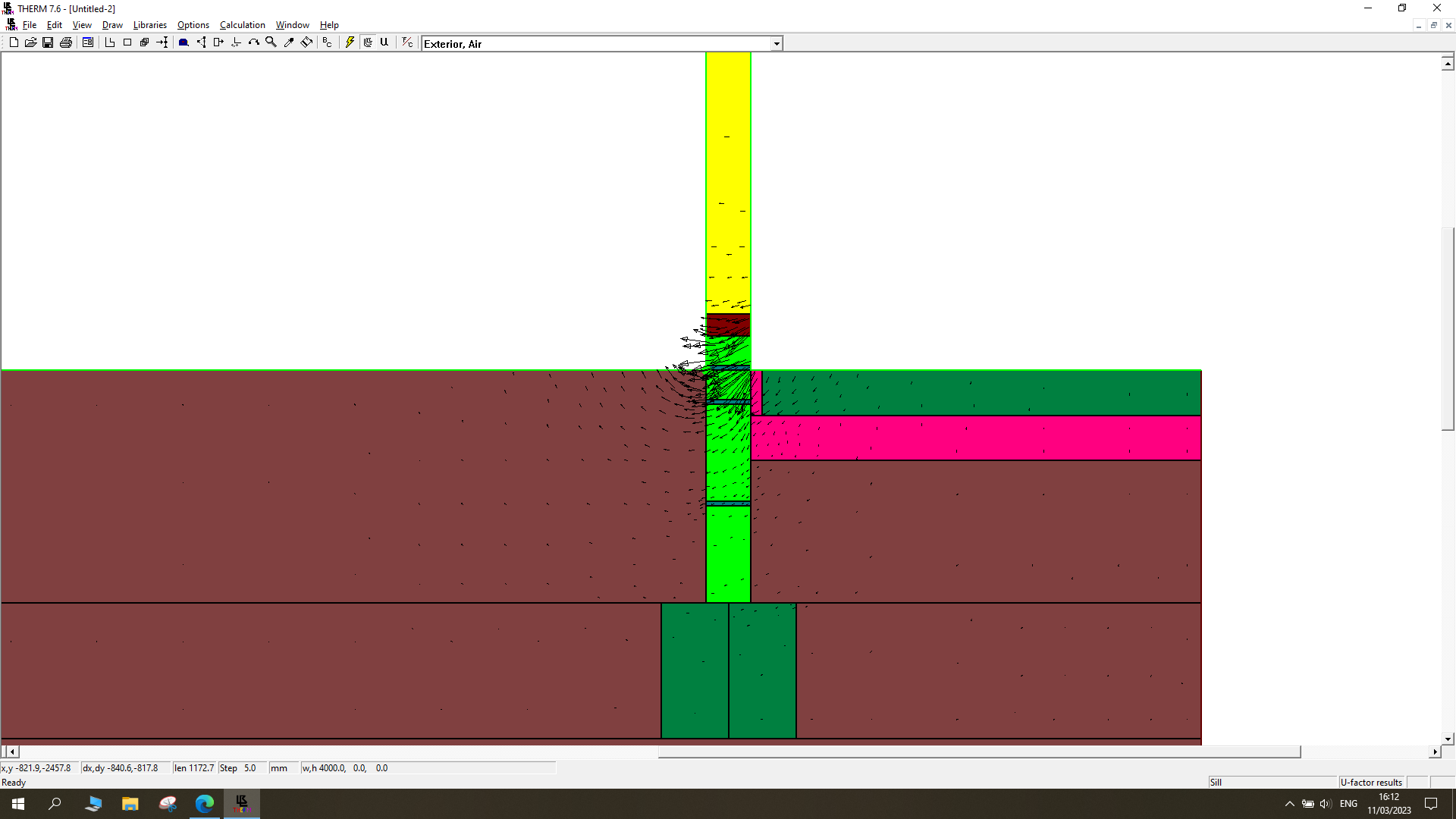

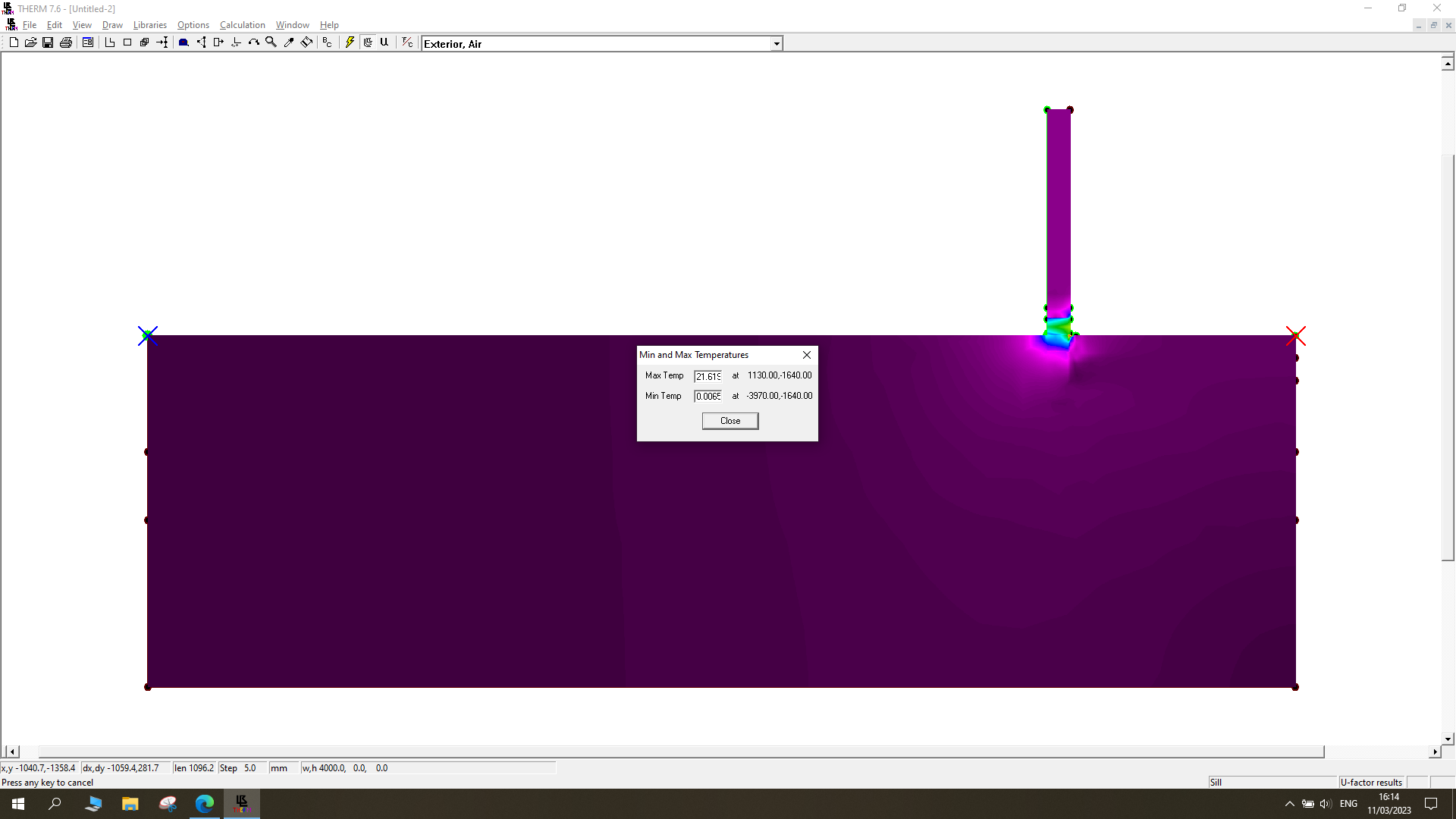

Will do a model in an hour or so if I can for you ....
image.thumb.png.047053f5bb4500d08fa3dcd178b68f0f.pngimage.thumb.png.61bbf9fc244bdad0d3936ade00c63a37.png
Some thermal simulations of what you've drawn.
Think of keeping heat in like keeping sheep in a field. The will get out eventually but you have to try to make their progress as slow as possible.
Higher R value materials like Mineral wool and polystyrene are like denser bushes in the fence that will really slow the sheep ( heat!). You need less thickness to slow them to an appropriate level.
Lower R value materials like concrete and steel are like really non dense bushes that the sheep can move through easily.  When you have a low R value material like brick/concrete connecting the inside and outside it's a thermal bridge. It's so significant that it renders all the other insulation almost ineffective.  For my analogy it's equivalent to letting the gate of the field open, the sheep are going to run straight out there and the thickness of bushes ( insulation ) elsewhere is irrelevant. Demonstrated by the Flux vector ( arrow) diagram lowest above.

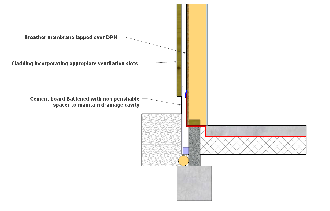

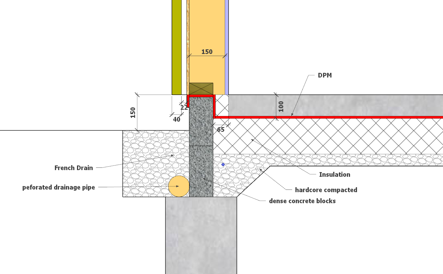

Here's a quick sketch of a robust detail.
Note the 65mm upstand which joins the insulation between 150mm studs to mitigate the thermal bridge.
I would consider tanking/rendering the outside of the foundation blocks to stop rain water getting into them as over time the freeze thaw action may crack them.
Something like this is what I'd look at if going below a floor level of 150mm. The door would still need to be above the DPM termination in my mind so you'd be stepping up to step down.
I would tank the floor to the walls with a waterproofing kit  and put in a drainage sump for when the floor floods too.

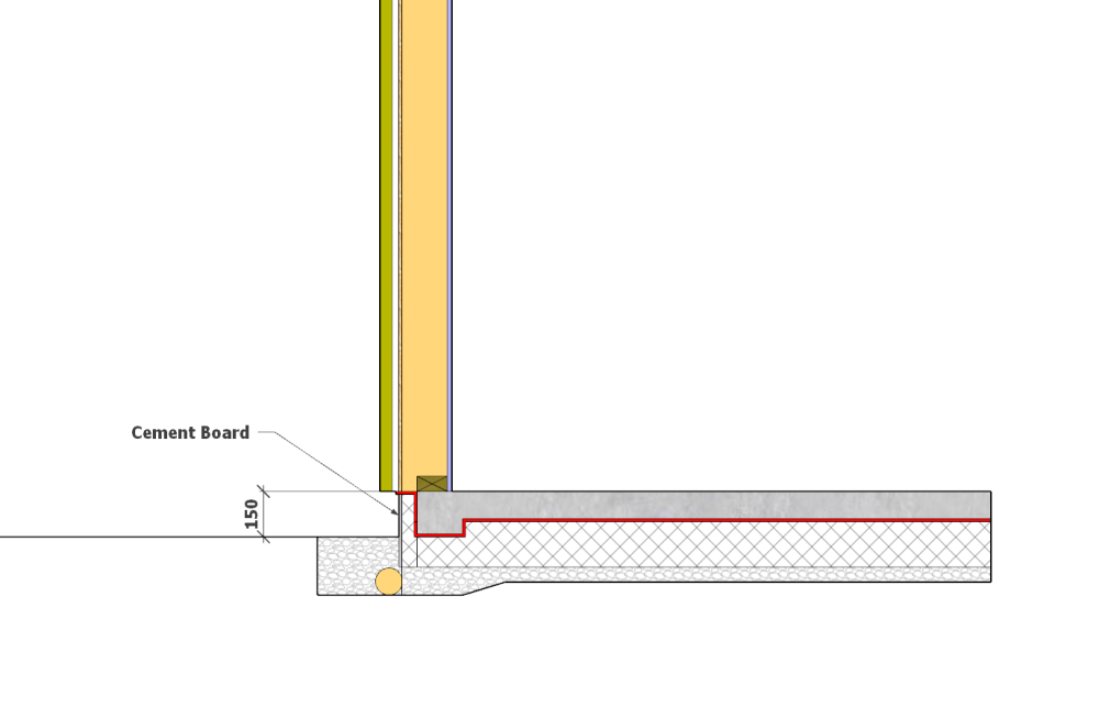

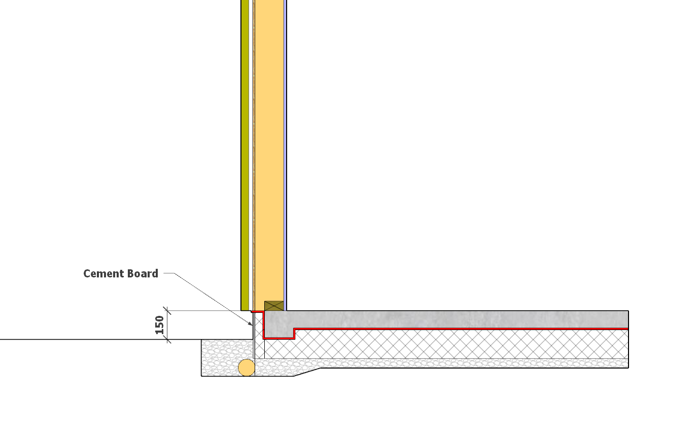

This might be easier to build. Note the 50mm insulation outside the concrete, the 50x100mm wall plate supporting 150mm studs to give a much better junction thermally.
Something like EPS 100 should be fine for a garden room. I've thickened the slab 50mm at the edge for some strength but it's educated guesswork really. Some reinforcing mesh would make it much stronger too.

I'm starting to think that the easier options will be my best approach to which I'd have to accept the slab being 15cm off the ground as in @Iceverge's last drawing.
A couple more questions about that.
1. How would the concrete board be fixed to the upstand? In an earlier comment you said EPS doesn't need any DPM between it and hardcore as long as there's a perimeter drain. How does the layers below the EPS differ to my drawings of hardcore with a layer of sand.
2. With the wallplate being shorter depth than the studs does that mean that the studs have the corners cut so they sit around/over it? I'm just trying to picture it.

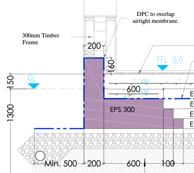

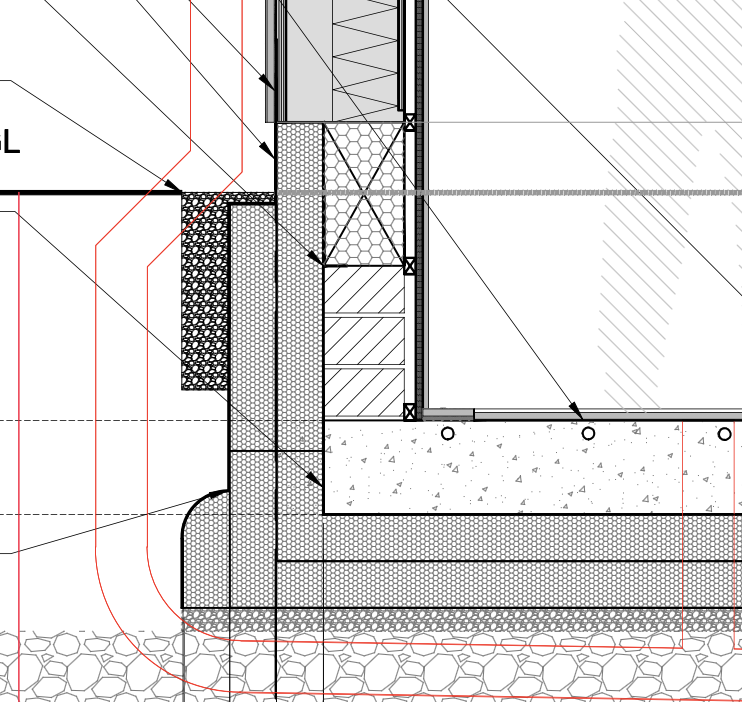

This is another approach, that we used on house, that doesn't involve a retaining wall on the slab.   We did this because the rear of the house has a level threshold and we wanted the rear patio at the same level across the whole back of the house.
(The drawing is slightly wrong because external GL is actually the same as internal FFL)
