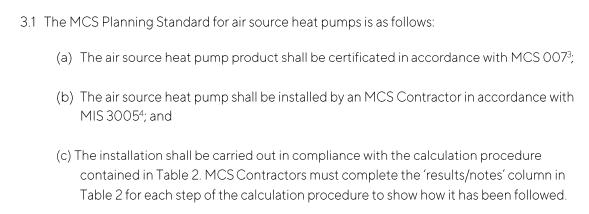

JohnMo Posted February 19, 2023 Posted February 19, 2023 29 minutes ago, JamesPa said: MCS registered installer' Still think the equivalent bit,is vague enough to not require MCS installer. That's my interpretation and I will be sticking with it, as many on here have previously done. So will self install, follow guidance within MCS where required and equipment manual where that give specific instructions. Complete a commissioning certificate etc. 1 1
Nickfromwales Posted February 19, 2023 Posted February 19, 2023 What about if it has been installed to, or above those standards? How would they argue against "compliance" eg if it "complies"?

JamesPa Posted February 19, 2023 Posted February 19, 2023 4 hours ago, JohnMo said: Still think the equivalent bit,is vague enough to not require MCS installer. That's my interpretation and I will be sticking with it, as many on here have previously done. So will self install, follow guidance within MCS where required and equipment manual where that give specific instructions. Complete a commissioning certificate etc. If neighbours don't complain you will almost certainly get away with it. But if neighbours complain about noise the first thing the EHO will do is check if you have planning consent. If you haven't then quite likely EHO will issue a noise abatement notice and planning a planning enforcement notice. If it went to court then you would have MCS on the side of the LPA defending their monopoly. Most likely the upshot would be a requirement to be 10dB below background, as that seems to be quite a common demand, albeit a stupid one when background is anyway so quiet that it can't be heard indoors. In many cases it's a risk worth taking. I can't see however that the get out of 'equivalent' would fly unless it's a recognised standard. I wish I could, but I can't. 1

JamesPa Posted February 20, 2023 Posted February 20, 2023 (edited) 1 hour ago, SteamyTea said: Isn't it more a case of a Franchise. Set rules to stick to, but you, or the customer, can still choose to use you, or go to independent. Except that the customers cant choose to go elsewhere if the install is to be done under permitted development or if they wish to claim a government grant. I can just about support the latter, but the former is absolutely scandalous and a barrier to the greening of our economy. Worse still, MCS themselves have been allowed to write the rules that say that an installation under permitted development must be done by an MCS installer and to MCS standards. Edited February 20, 2023 by JamesPa

JamesPa Posted February 20, 2023 Posted February 20, 2023 2 hours ago, SteamyTea said: It only has to comply with the MCS rules from my understanding. Not so sadly. The requirement in law is that it must comply with 'the MCS planning standards or equivalent standards'. 'The MCS planning standards are defined in MCS020 which reads as follows: MCS have effectively written themselves into planning law!

JamesPa Posted February 20, 2023 Posted February 20, 2023 (edited) 37 minutes ago, SteamyTea said: Isn't that what MCS (or their agents) has to do. Yes but the point is that this text appears to define 'the MCS planning standards' and thus apply if an installation is to be done under permitted development, thus forcing PD installation to be done by an MCS contractor. Furthermore mis3005 referred to therein requires an installation done by an MCS contractor to be designed according to MCS design rules by an MCS designer. It follows (so far as I can see) to that any installation under permitted development must be done by an MCS installer and designed by an MCS designer. That's great for the MCS fraternity but a gross misuse of a government sanctioned private monopoly, stifles innovation and is bad for the environment. Edited February 20, 2023 by JamesPa
