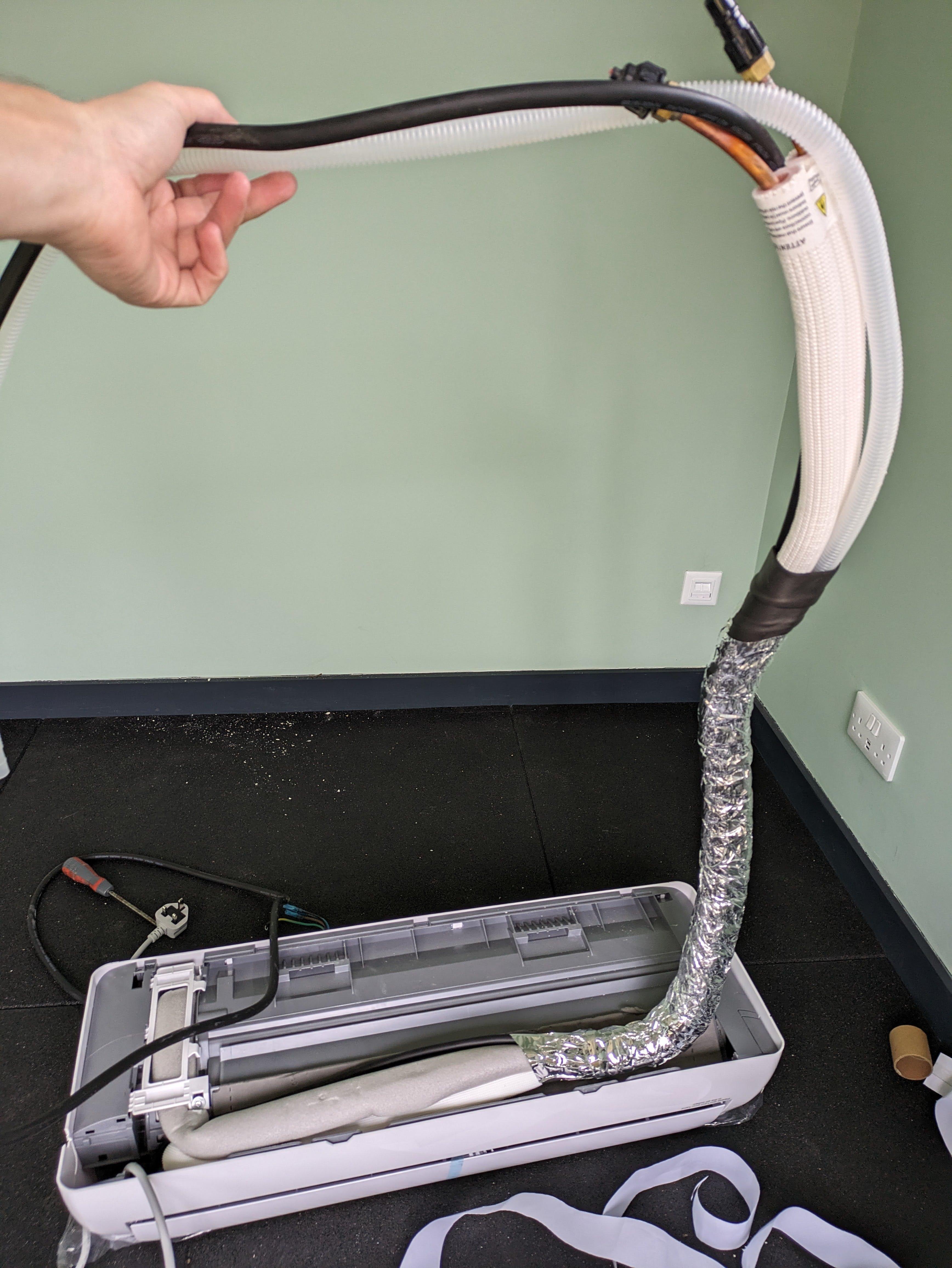

Anyone else installing one, note the illustrations and the installation text don't entirely match.
E.g. the text says to install the protective sleeve in the hole cut through the wall, and to wrap the pipe bundle in additional insulation, prior to passing through the (sleeve in the) wall.
The diagrams don't show either those steps, nor does the kit include said sleeve or insulation.
So, anyway having noticed this I managed to get mine back off the wall and wrap the pipes. I used self-adhesive foam and then a layer of self-adhesive aluminium foil. The result looks OK enough, and importantly the bundle passed much more smoothly through the wall than it did as separate pipes/wires.

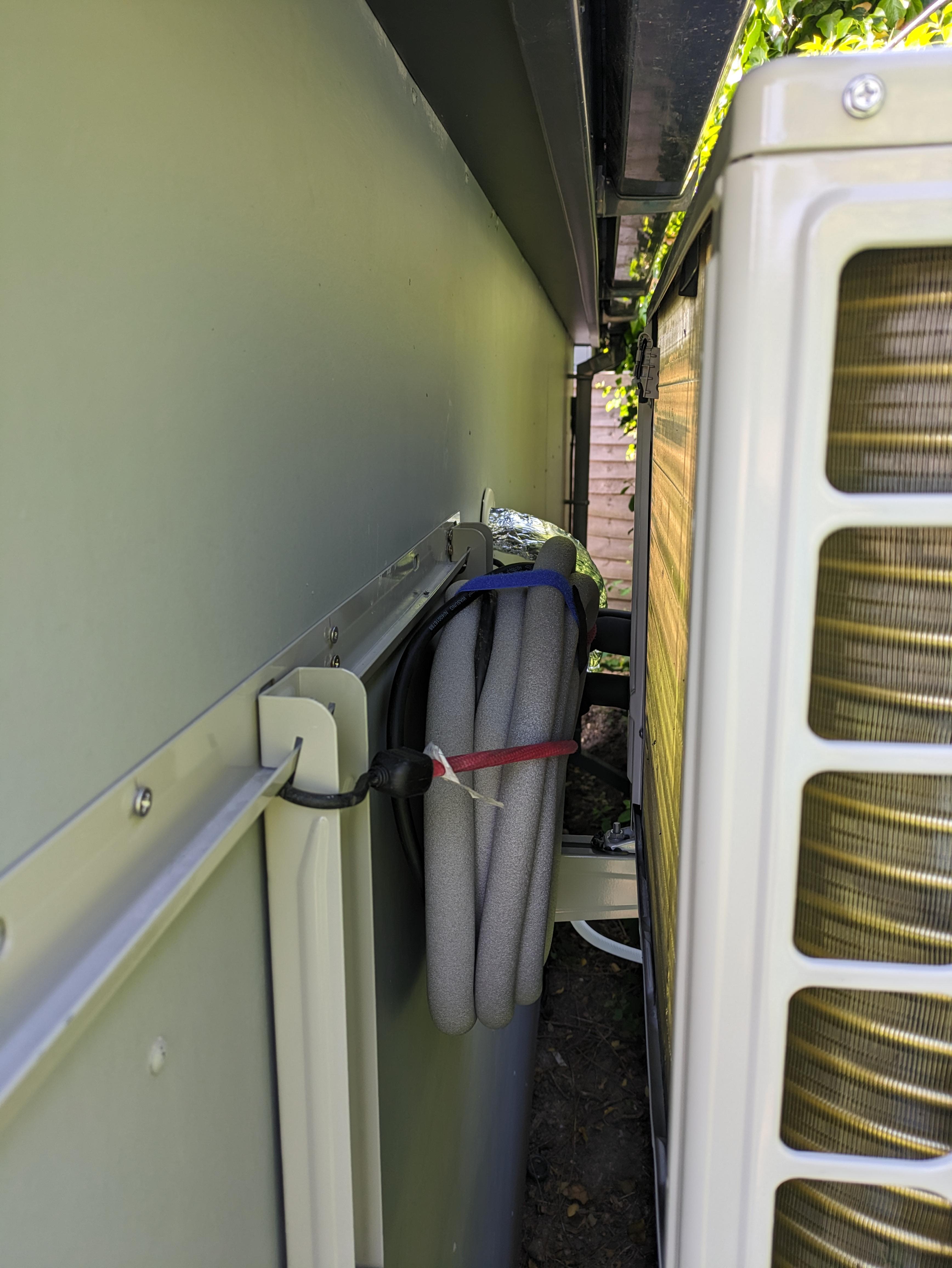

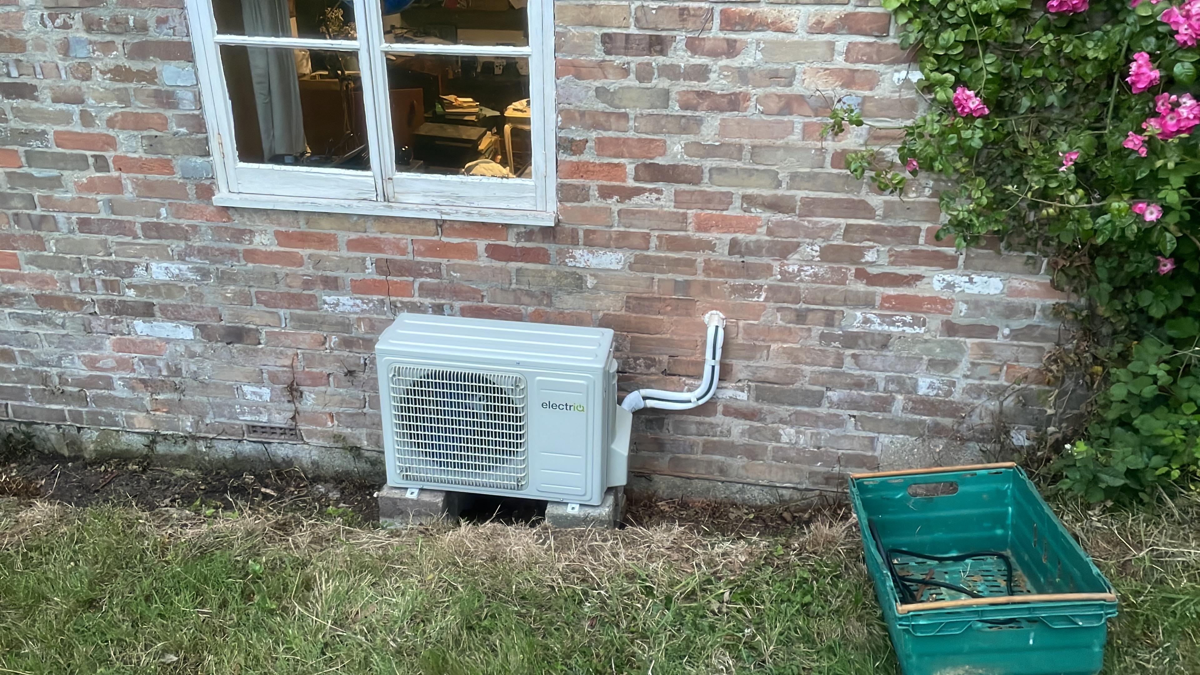

Bit more progress today; got the outdoor unit mounted up onto a wall bracket. That was not without some fun as the bracket keyhole slots to screw the unit unto had the large hole in just the wrong places for this fairly slim but nvmd nothing a couple extra large washers couldn't fix. The back of the unit is about 25cm from the wall, not quiet the 30cm the MIs call for but I think it'll be fine for a rarely used device.
Hit some snags getting the gas pipeage hooked up though.
1/ the MIs aren't clear what to do with these black plastic on the internal pipe. I assume it is just remove them. There's a lot of gas hissing noise if I do so, so I slapped them back on. I guess they're just charged with some harmless gas to keep dirt out and pressure test. But MIs aren't clear so I'm dithering.
2/ I really don't need the 3m extension coils that came with it, the internal unit is directly inside of the outside unit, so in fact I have 50cm slack in the pipes as it is. However, I now spot the extensions have 2x female threaded connectors, and the pairs of connectors I'm currently trying to mate are all male.
Other than use the supplied extensions (and having to tuck them up neatly and insulate the lot) I think my options are to get a couple appropriate sized F-F equal couplers. Perhaps these?

Posted
On 13/03/2023 at 16:02, S2D2 said:
The internal unit is charged, I presume with nitrogen, so once the internal work is complete you can be confident there isn't a leak as there is a release of pressure when the plastic pipe caps are removed
Carry on and remove them when you're ready to connect up the pipes.
You have to use the supplied 3m pipe extension even if not required as it has two female ends, converting the internal unit's male end
I just attached the extension and coiled the excess behind the unit, the adaptor would be a neater solution though. I presume you would have to release some amount of charge though as it's designed for the length of pipe. Manual tells you how much to add per metre extended, but that sounds too tricky for the opposite (kit required). No idea what the impact of an overcharged system is.

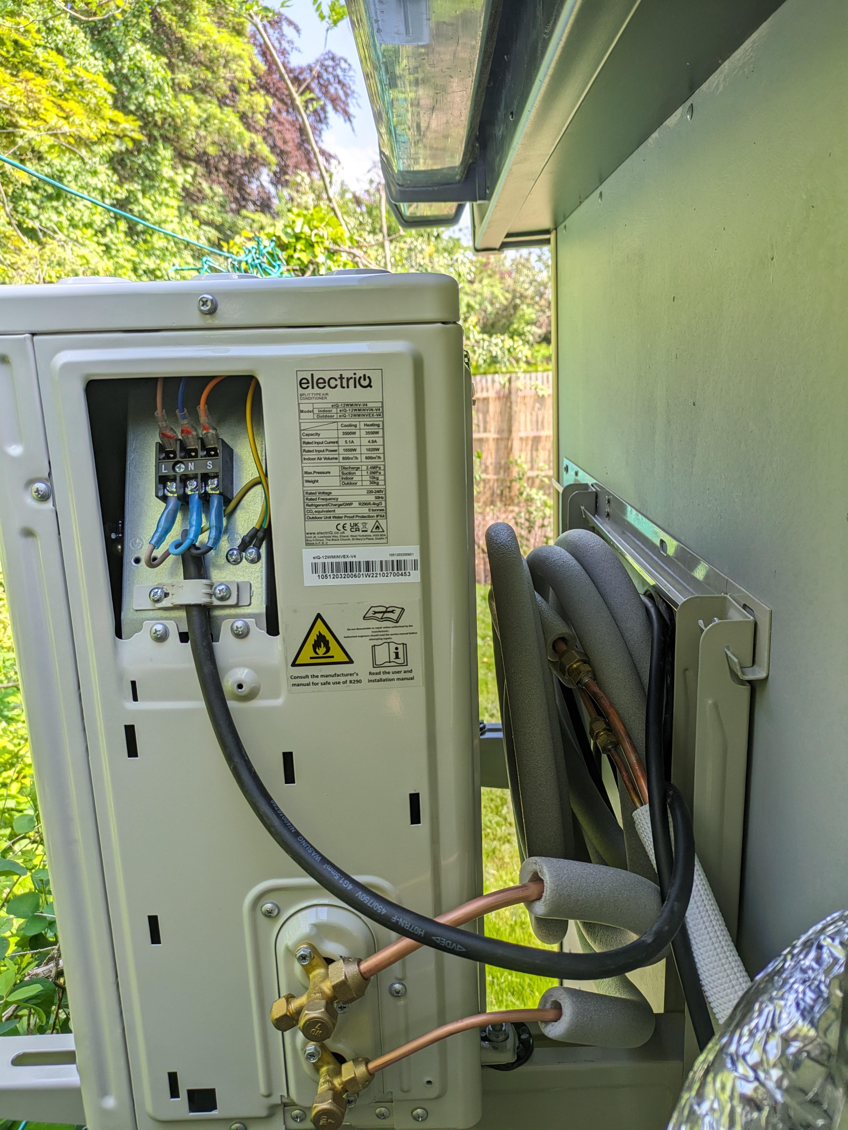

Posted
Many thanks for the tips! @S2D2
(I also found a 27 page Nowty thread on that other forum but it rambled all over the place and I gave up trying to find anything on this topic)
The coil of spare pipe seemed in elegant but I went with it as path of least resistance. Shoved some misc insulation and neoprene jacket over the numerous joints and exposed pipework.
The air bleed process was simple (if a little unsatisfying as there's no feedback I'd done it right) but firing it up all working well. It sat humming for 10mins before really getting going not sure if it has some initial self test or it'll always do that.

Posted
Looks good, it was beyond me why the supplied insulation left a load of exposed pipe, I also slapped some offcuts on to at least cover it but it was performing so well I've never got around to doing anything more significant.
Does your front panel of the outdoor unit have any resonance? I'm still meaning to stick a damping panel on mine as it has a tiny bit but again never got back to it, it's tucked round the side of the house so never an issue.
Posted
Yeah oddly it says if the pipe is extended indoors it needs insulating, but nothing about these external parts. I may wrap some wool insulation around the service valves, if I ever open it up again.
Also, I figured if it ever needs a R290 recharge I'll remove the unnecessary extension at that point.
The external unit as a whole kinda resonates when on full tilt, which transmits through the wall so I do hear it inside. But this is a gym, so the music, whirring bike wheels and swearing should drown that out in normal use.  Nothing specific coming from the front panel of it.

For those interested, I took another look at figures and clipped the data to where solar gain overtook heating demand which gives two months worth of data:
  1. Modelled gas heating demand for that period was 2662kWh
  2. Actual gas consumption was 640kWh
  3. The ASHP consumption was 372kWh
  4. That means every 1kWh the ASHP consumed offset 5.4kWh of gas
  5. This is likely to be accurate/an underestimate as I tried to push the ASHP for maximum gas offset meaning the house was on average 1°C warmer than the regression fit data
  6. 76% reduction in gas heating usage from a single multisplit unit
  7. Assuming a boiler efficiency of 90%, that gives an estimated CoP of 4.9, though this was in the March-May period so will be more favourable than mid-winter performance. Still, it compares well with the stated SCoP of 4.2
  8. Even accounting for "lost export" on Flux's high rates, that means the unit has repaid 20% of its cost in 2 months (~30% of the heating season) - not bad at all
