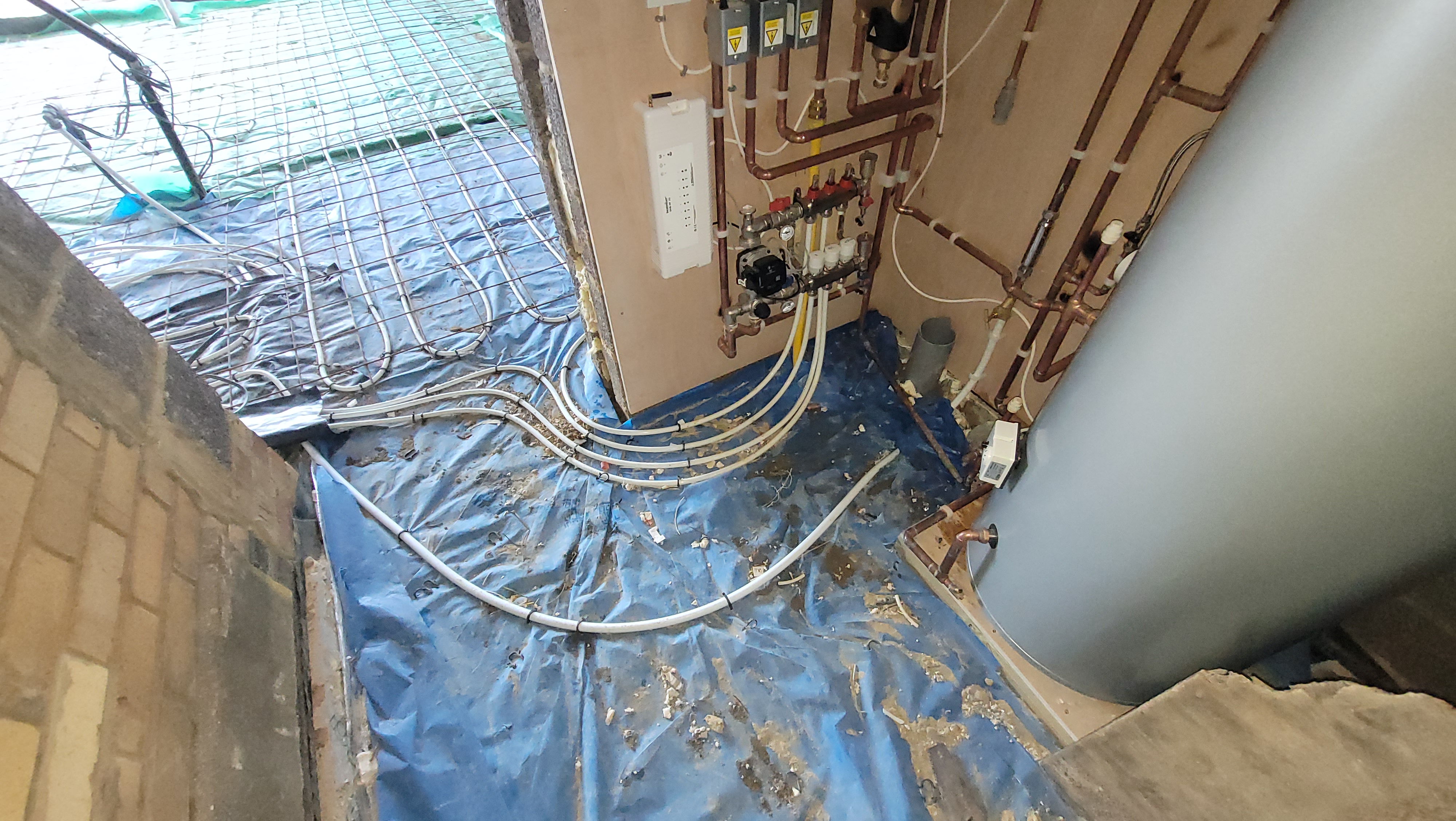

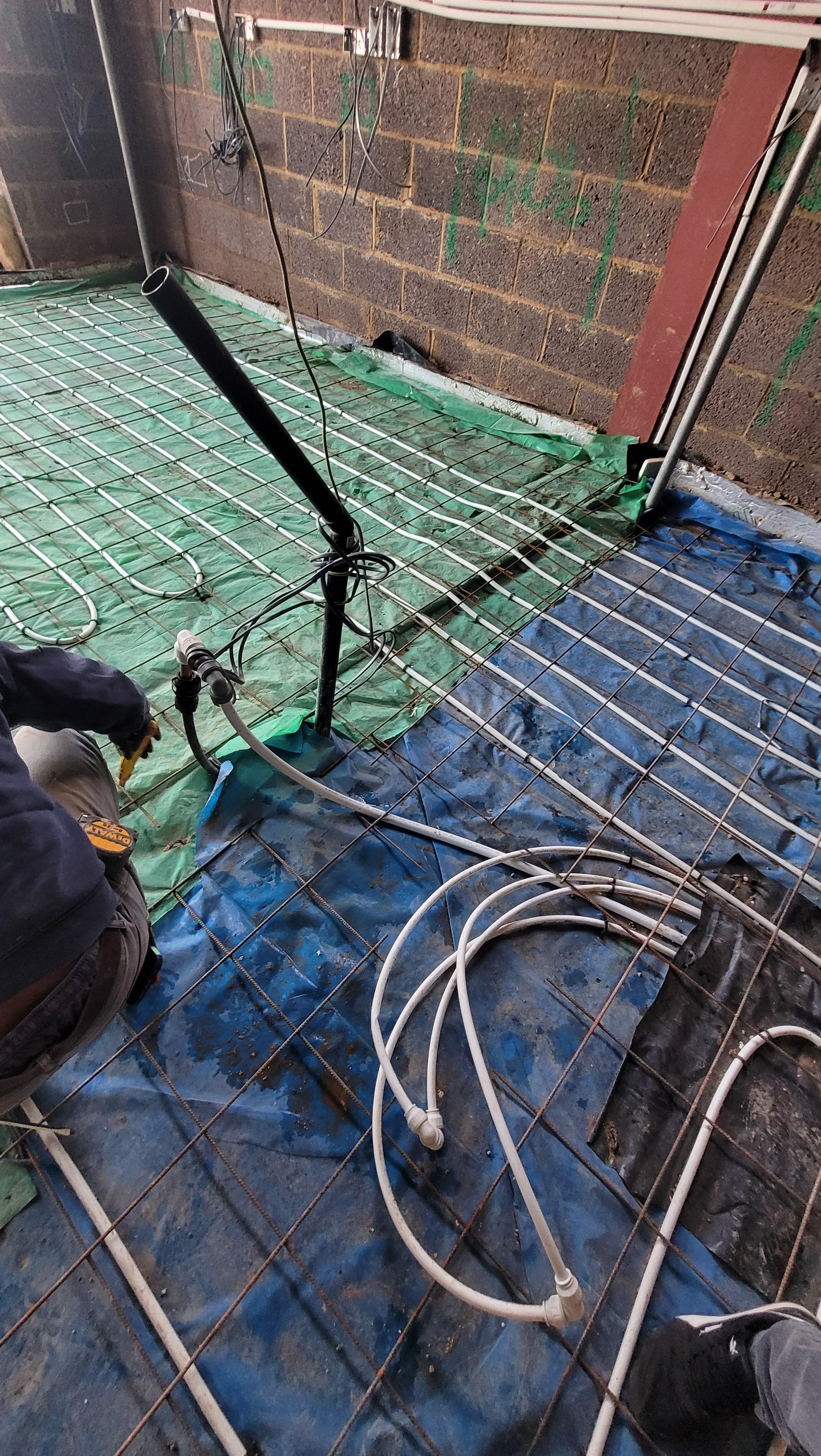

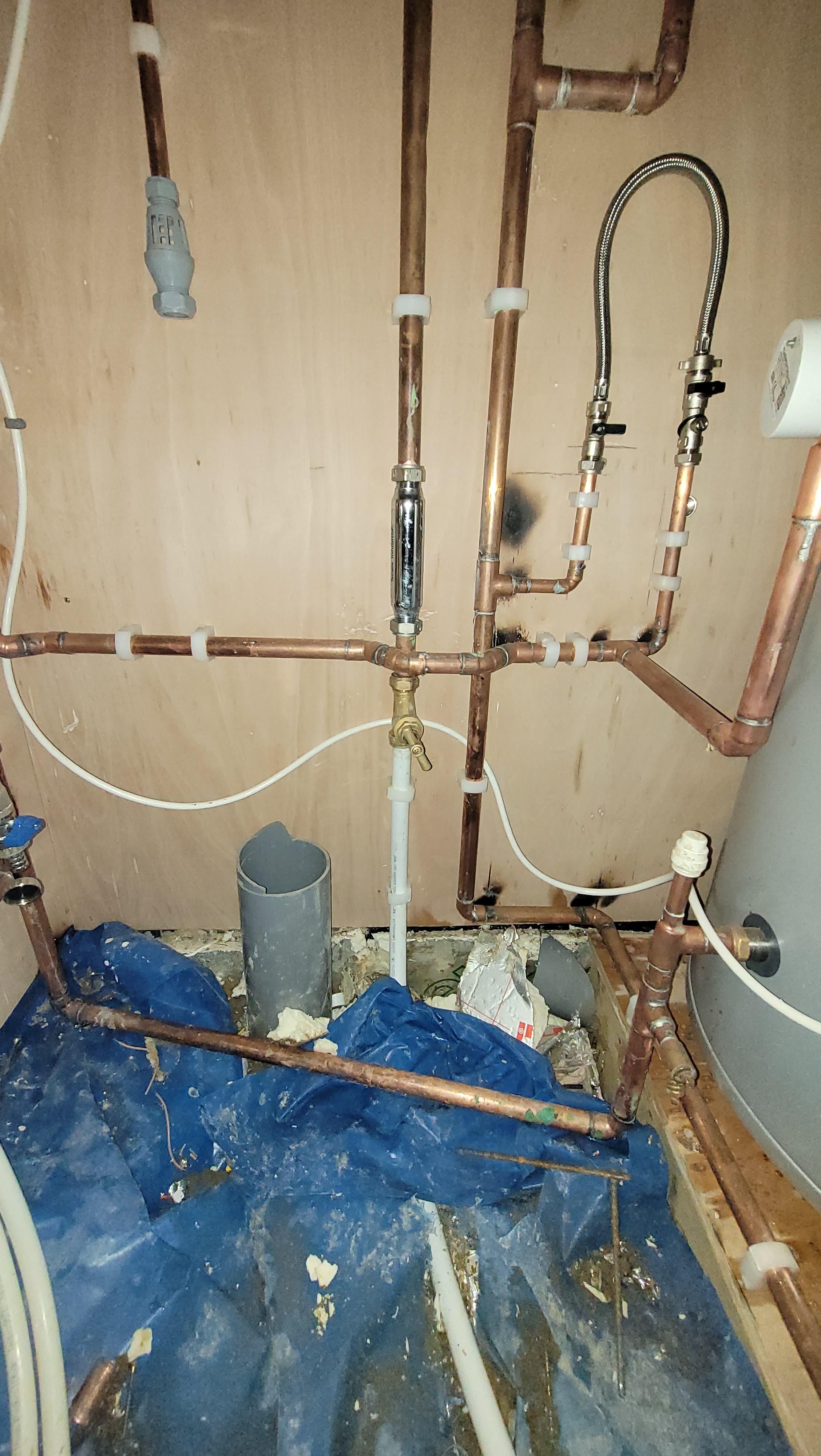

AmKal Posted February 13, 2023 Author Posted February 13, 2023 Hi, I spoke to the plumber today and showed the comments. He agreed to add a stop valve (after the floor has been screeded at the island). The joints from under the screed have been removed, see pics. The cold water is not as close to the other UFH pipes, but still there! I advised re. the D1 D2 and said it needs to 'fall' at an angle, I think he understands and will not let it go. I've posted a pic below of the join without the tap. Now my concerns move to the electrics! OMG!
Jenki Posted February 13, 2023 Posted February 13, 2023 (edited) Anybody want a bet that there's a joint under this plastic,😬 Just seems a bit suspicious Edit. Noticed the pipe has moved so hopefully it's not a joint🤞 Edited February 13, 2023 by Jenki More info

Conor Posted February 13, 2023 Posted February 13, 2023 (edited) Another thing thing that BC might pull you up on is the grey waste pipe coming up through the floor at the plant area. It should be brown underground pipe for anywhere below floor level. (Assuming it's a waste pipe and not a conduit) I'd speak to your building control officer yourself, get them round and see what they point out. Don't take your builder's word for it that BC have been round and are "OK" with the current state of things. And please tell me that anti-cracking mesh isn't resting on the pipes... Think that's a guaranteed way to have a damaged pipe. Has everything been filled with water and pressurised? Edited February 13, 2023 by Conor

ProDave Posted February 13, 2023 Posted February 13, 2023 Yes I believe the way forward is to halt the job, meet with your BC inspector yourself without the builder present to intimidate you, go round all the points this thread has highlighted with him and get him to evaluate them, and then provide you with a list of things that need correcting before the job progresses. Your builder won't be able to argue with that. 4

ProDave Posted February 14, 2023 Posted February 14, 2023 I would not pour the screed yet. While you have improved the cold feed situation, you still have the cold feed to other parts of the house buried in that same screed.
