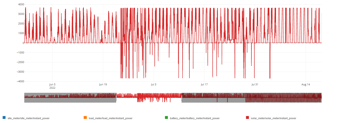

Pocster Posted February 11, 2023 Author Share Posted February 11, 2023 (edited) Strangely enough Tesla emailed me suggesting their might be a problem. It's unclear too me the issue though. From a remote analysis of the customers system I could see that since 23rd June 2022 the Solar Production is showing negative values (see graph below). With negative loads the overall system measurement is incorrect and the battery cannot charge in a proper way. Since the customer has another SolarEdge battery since June 2022 (I assume in the same electrical circuit) we need to see if: a) this is a compatible setup, and if yes, how to make it measure correctly. [Because the portion which is going into SolarEdge battery is not being measured here] b) if there is an incorrect Solar CT placement or an incorrect Solar assignment Edited February 11, 2023 by pocster Link to comment Share on other sites More sharing options...

Kelvin Posted February 11, 2023 Share Posted February 11, 2023 9 minutes ago, pocster said: Does it matter the portion going into the SE battery isn't measured by Tesla ? ( I know it isn't ). Why would Tesla 'care' about that? CT placements I assume are correct - no issues I am aware of. "Solar assignment" no idea what that refers/means They don’t really but it’s pretty good they spotted it. Having the whole system accurately report in one place is handy unless you’re bringing that together somewhere else. 1 Link to comment Share on other sites More sharing options...
