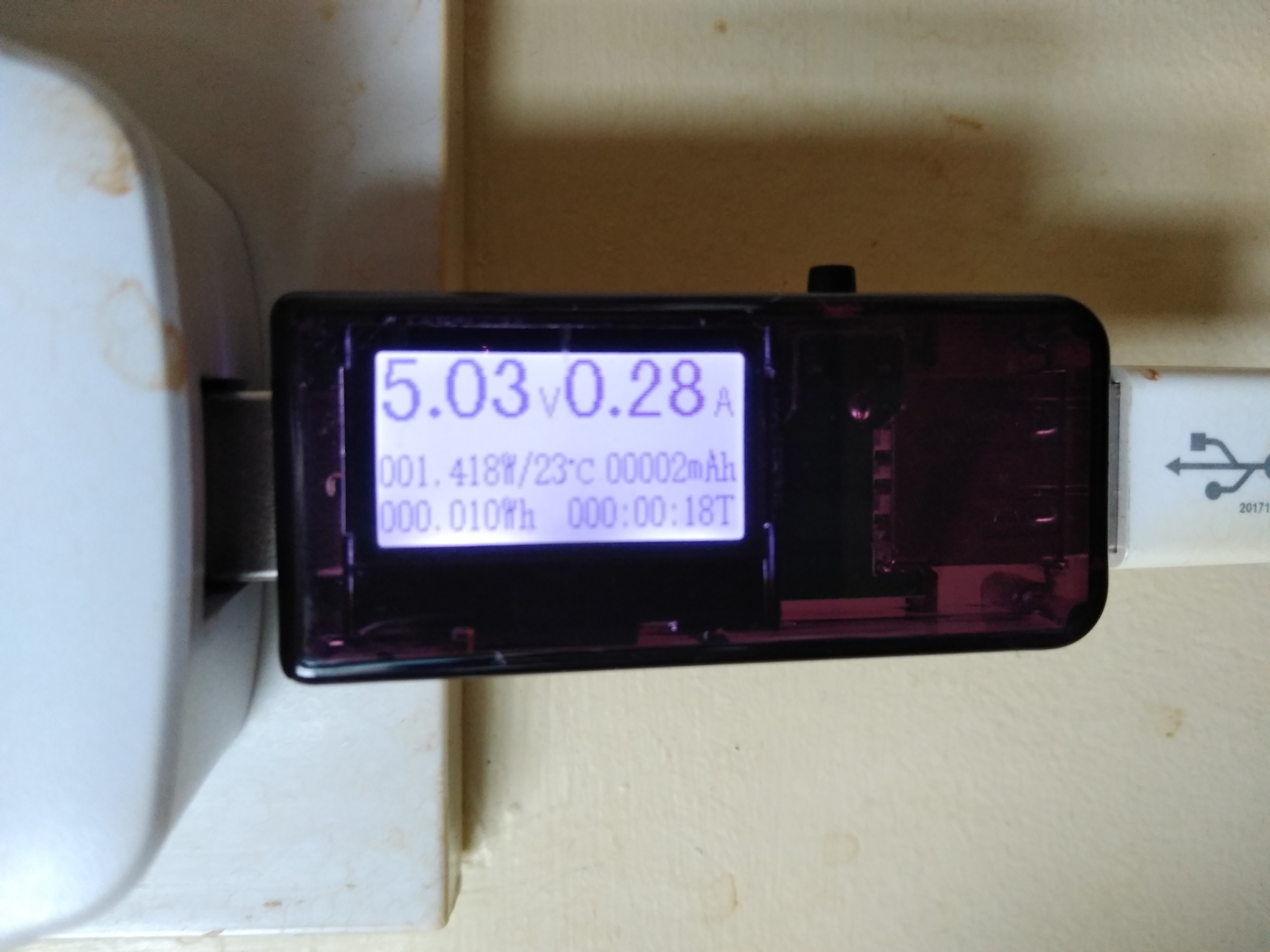

TerryE Posted February 9, 2023 Author Posted February 9, 2023 That's a Pi Zero case, isn't it? See above.
SteamyTea Posted February 9, 2023 Posted February 9, 2023 21 minutes ago, TerryE said: That's a Pi Zero case, isn't it? See above. No, just a little DC energy monitor. Looked at it a while back and it was averaging about 1W. Think it is an old model b, shall have to open a box to have a look. The CurrentCost is also on the same supply.
TerryE Posted February 9, 2023 Author Posted February 9, 2023 2Bs are around 1½W. It's the RPI4s that take ~5W. 1
