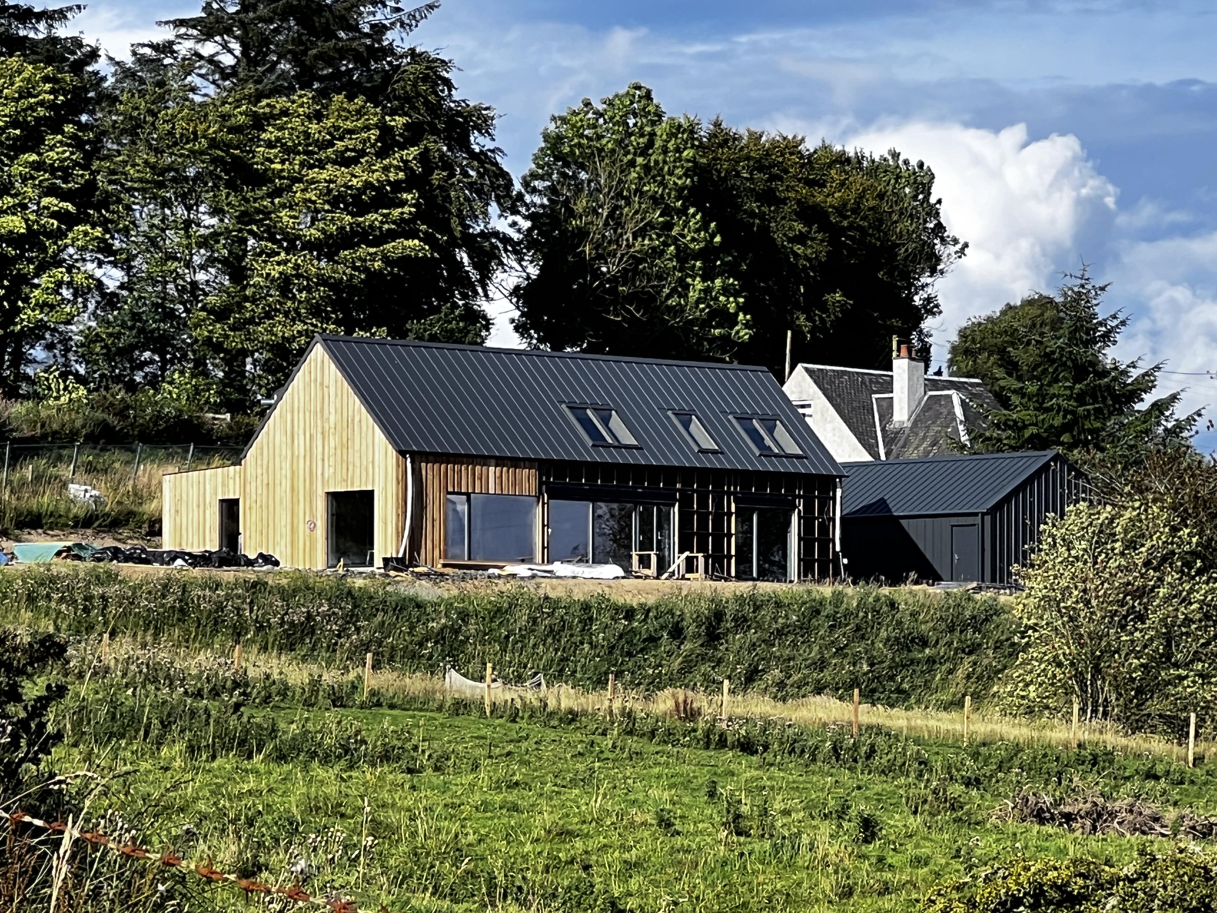

Kelvin Posted August 23, 2023 Author Share Posted August 23, 2023 Agreed. The PLX looks stunning to me on our roof. Very little oil canning. 3 Link to comment Share on other sites More sharing options...

Kelvin Posted August 24, 2023 Author Share Posted August 24, 2023 I have both materials so can compare side by side. The plastisol coated steel looks great too but it looks painted by comparison. Link to comment Share on other sites More sharing options...
