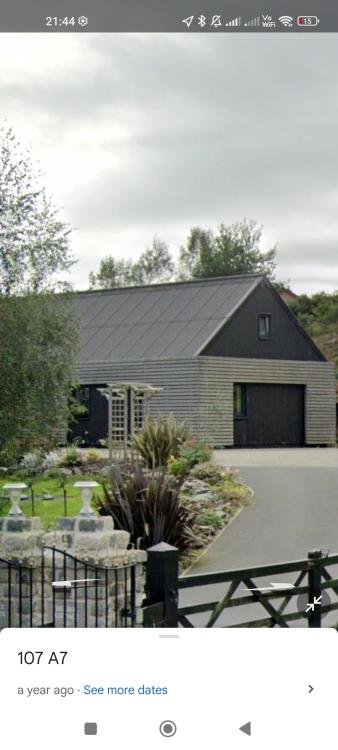

Declan52 Posted February 4, 2023 Posted February 4, 2023 Have you priced up a black corrugated roof. Plenty of them around here. A guy who used to be a member here used it on his build. You can see if in Google maps, the address is 76 Belfast Rd, Ballynahinch BT24 7HE. It's set back from the road behind the green sheds. 1
Kelvin Posted February 4, 2023 Posted February 4, 2023 (edited) 1 hour ago, CalvinHobbes said: Same issue here, I thought it was because we are in the back of beyond. Hadn't checked Catnic, not given up yet just a bit frustrated. whereabouts is the back of beyond? Have you contacted the metal roofing company? They gave me a list of installers for Greencoat which I’m working my way through. I am expecting some quotes back this coming week but they’ve been saying that since last month and December. Edited February 4, 2023 by Kelvin 1
