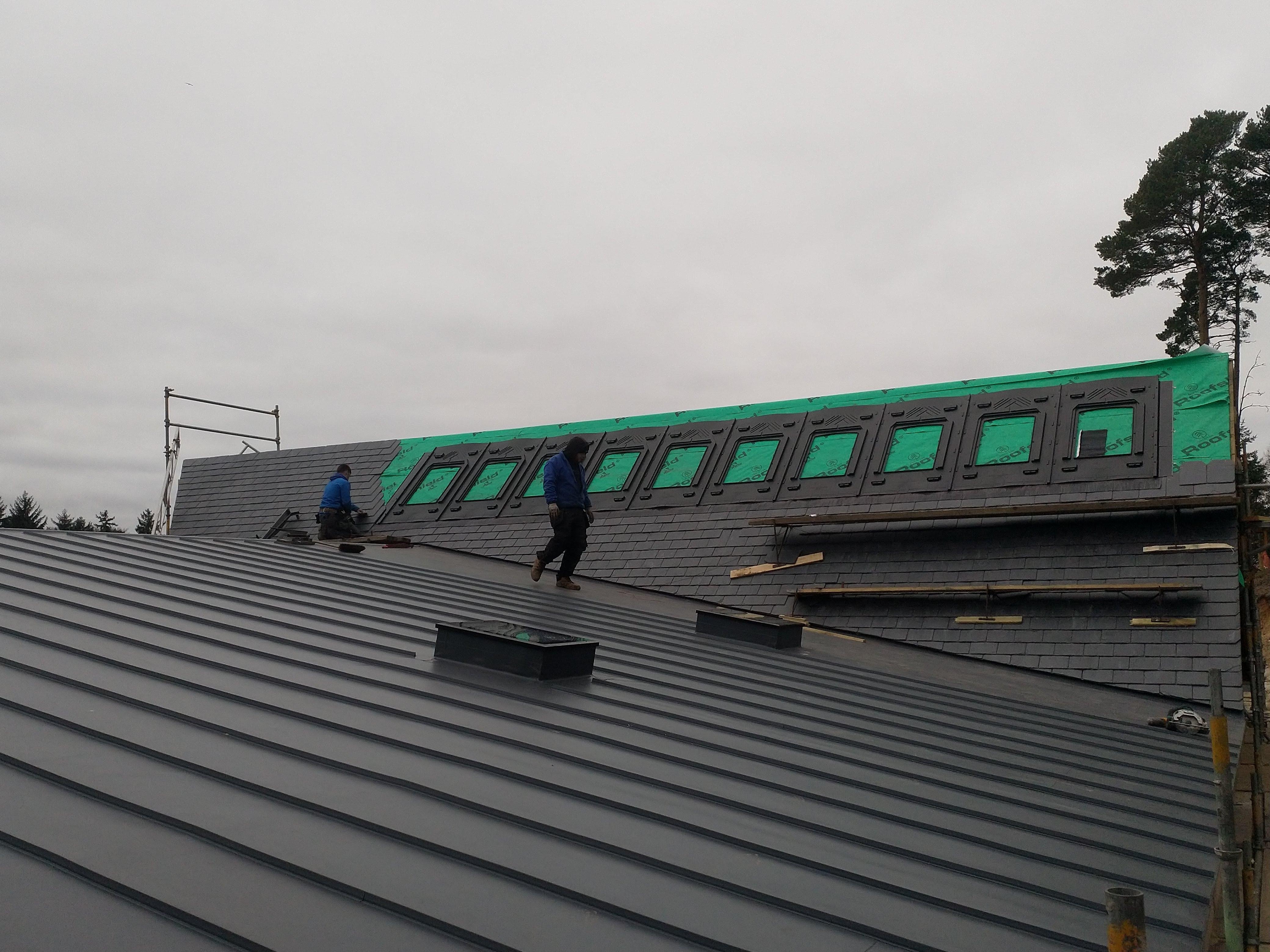

JohnMo Posted February 1, 2023 Posted February 1, 2023 I did a Sarnafil standing seam. EPDM the material mechanical fixed to 18mm ply, then seam welded and standing seam mouldings welded. Same effect way less money - 194m2 was £14.7k in early 2021. At the same time I was getting £30k quotes for both zinc and aluminium. 2
CalvinHobbes Posted February 1, 2023 Author Posted February 1, 2023 (edited) 17 minutes ago, JohnMo said: I did a Sarnafil standing seam. EPDM the material mechanical fixed to 18mm ply, then seam welded and standing seam mouldings welded. Same effect way less money - 194m2 was £14.7k in early 2021. At the same time I was getting £30k quotes for both zinc and aluminium. That looks great, really impressed and you were able to put solar panels on it too. I thought some non metal roofing wouldn't allow that. Edited February 1, 2023 by CalvinHobbes
JohnMo Posted February 1, 2023 Posted February 1, 2023 2 hours ago, CalvinHobbes said: really impressed and you were able to put solar panels on it too. Solar panels are in a slate roof. The flatter roofs are sarnafil 1
