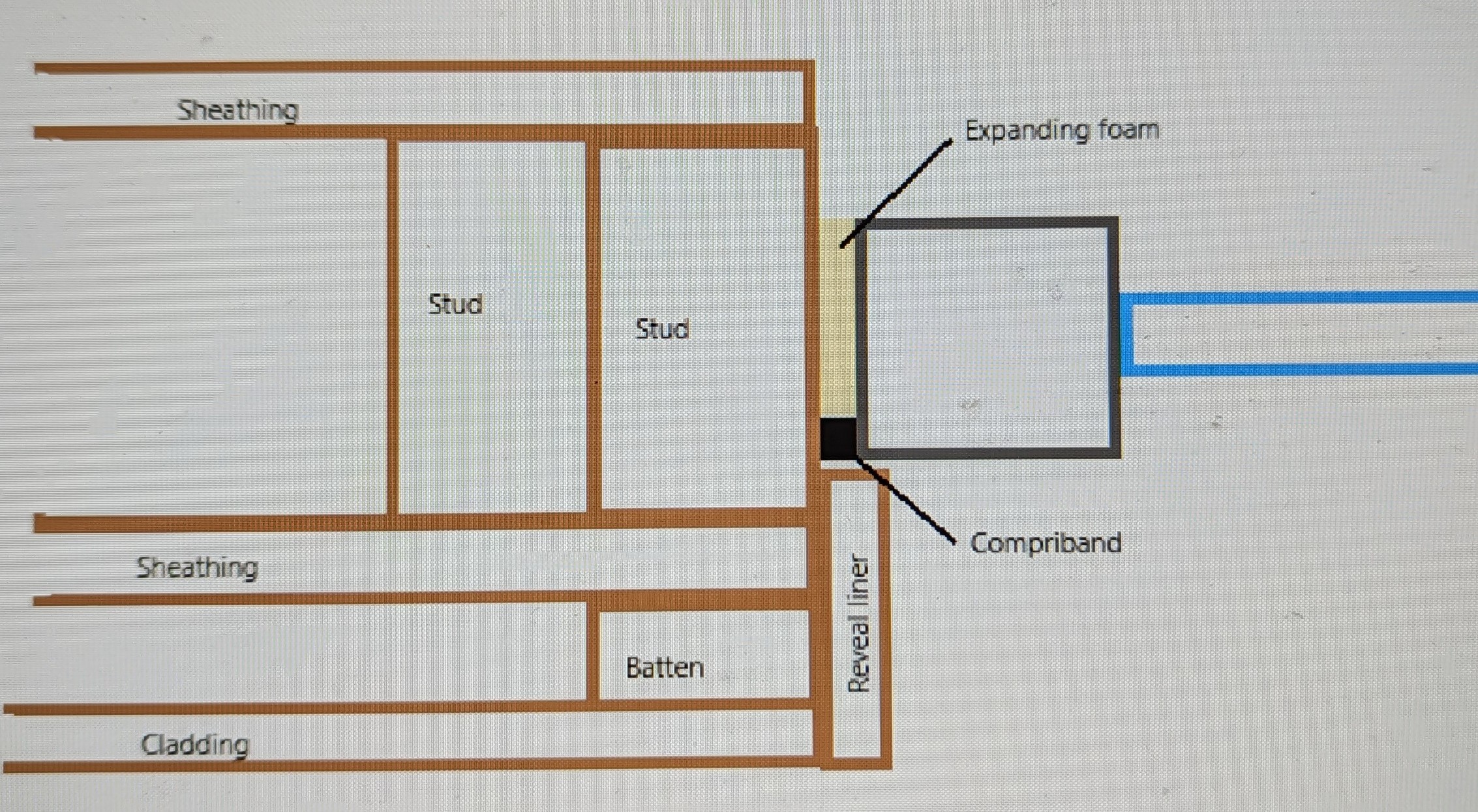

54 minutes ago, andyscotland said:
Then you can just compriband between the window and the opening, and if you like put a thin piece of timber to line the reveal and cover the compriband. That's what I did.

1 hour ago, eandg said:
Set back - board on board cladding, 10mm will sit against the edge of the window with 12-34mm proud of it. Was intending to put the Compriband between window and the reveal.
As @Mieksaid, better flexibility & movement and especially if covered by the reveal you want something essentially maintenance free.
I went with reveal against window (with a few mm expansion / shadow gap) for a few reasons:
* To my untrained mind it felt more like a Scottish "check reveal" with an extra layer of resistance to weather, though I think compriband is pretty bulletproof either way.
* Visually it reduces the number of materials at the junction - you just see timber reveal & window frames, no visible sealant/compriband line which I thought was more attractive. Especially if there's any risk of tolerance gap being uneven/not exactly square/not exactly centred (I'm realistic about my woodbutchering skills 🤣) because that gap is hidden so you can finesse & pack the cladding batten/reveal liner a little bit as required.
* My hunch was the cladding might need maintenance sooner than the windows & doors, especially around sill area, so useful if the reveal liner is just a cover plate that can come off rather than trapped between window & wall.
* Things here happen veeeeery slowly, my way let me get windows into the structural opening, compriband & foam so fully weathertight and then faff about with cladding & reveals later.
Of course if you have some brick & some timber you may want the visible joint at the reveal for consistency. I've seen plenty done like that so I don't think there's anything wrong with it per se.

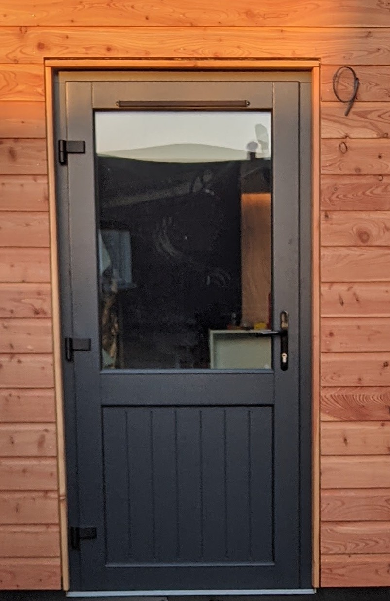

10 hours ago, eandg said:
Thanks for the full response - so is your reveal butted against the windows/doors and the compriband then hidden behind them and against cladding? Can't picture it but my visualisation will be a helluva lot worse than your woodbutchering.
Mine is like this quick & dirty sketch (no CAD on this machine 🤣)
End result looks like this:
Looks great. I normally do quick and dirty but just confirming I'm following that sketch correctly - layer of foam behind the compriband then effectively cap and hide it with the reveal?
Link to comment
Share on other sites
Exactly.
I didn't draw the inside but basically the same thing, airtightness tape from the door/window frame to the VCL and then a piece of insulated plasterboard to cap the expanding foam & line the reveal on that side.
Obviously this detail wouldn't work with very thin-profile frames - I was actually cutting it a bit fine with the door hinges on mine as you can see in the photo, but there was just enough space.
