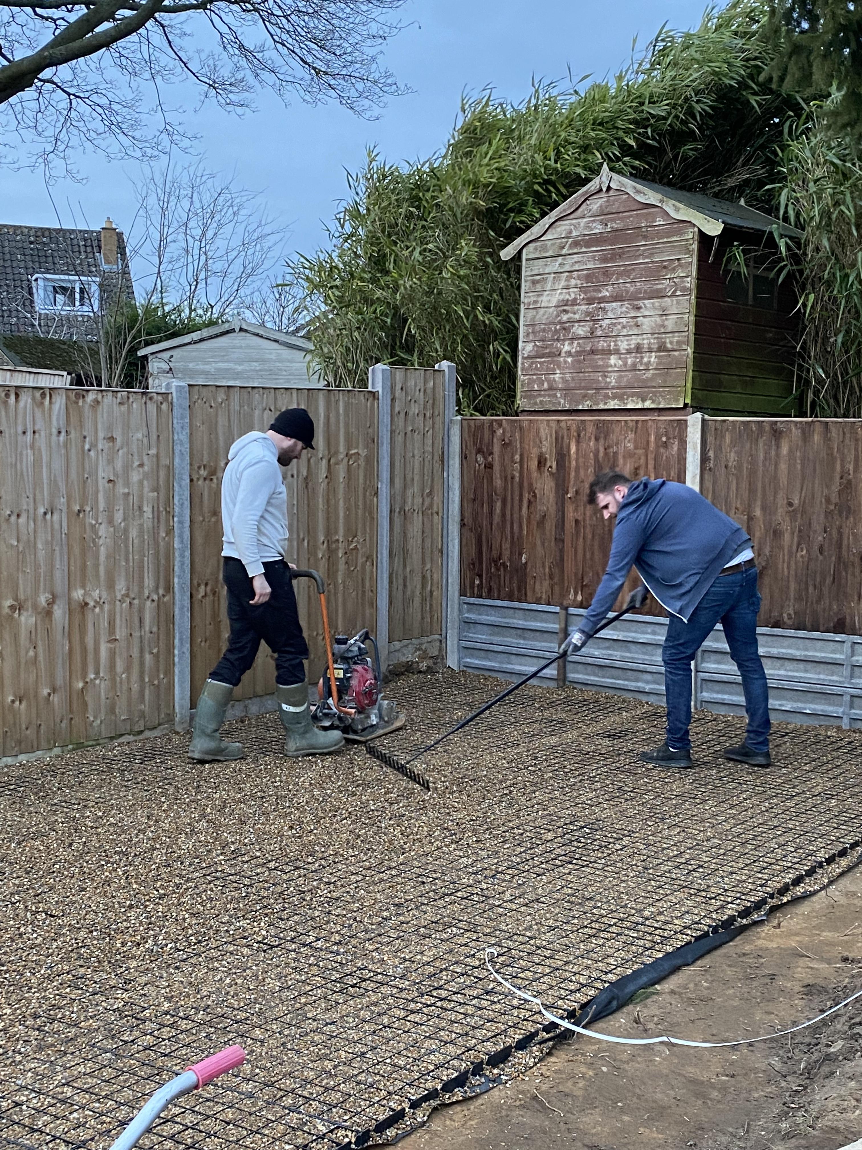

Adsibob Posted October 26, 2022 Share Posted October 26, 2022 On 18/07/2017 at 19:51, Siochair said: I once had a neighbour who used a plastic grid filled with stones/gravel as a shed base. No idea how long lasting it was as we both moved not long after. I do remember that it was pretty idiot proof to do. He managed both base and shed in just over a morning. I have no idea where he got it from but I am sure there are probably kits available. Apart from this and @daiking’s response to it, I haven’t really found much on this forum about these plastic grids. i need to do my shed base next week and has decided on the plastic grid click system filled with gravel, as it’s meant to be the easiest and all the shed suppliers have said it’s fine. But I’m getting confused as to what the build up is. I think it’s something like: Shed 40mm thick plastic grid system, filled with 10mm pea shingle Geotextile membrane MOT scalpings - but not sure how thick or whether this needs to be compacted at all??? I don’t have a compactor and want to keep the labour involved quite light as it’s just me and a mate of mine doing this. If anyone has done this type of base before, I’d appreciate your tips and pointers. Link to comment Share on other sites More sharing options...
Adsibob Posted October 27, 2022 Share Posted October 27, 2022 It’s also not clear to me that the mot scalping layer is even necessary. It is omitted from the instructions here, for example: https://www.tigersheds.com/blog/how-to-install-a-plastic-shed-base-kit/ Link to comment Share on other sites More sharing options...
Chanmenie Posted October 27, 2022 Share Posted October 27, 2022 I used the grids, don’t use pea shingle, you need 10mm crushed stone it’s settles and locks in whereas pea shingle will move about. I am fortunate that I have good ground, so I just removed the top soil and compacted the underlying sand / gravel then fitted membrane, grids and crushed stone. These are the grids I used https://www.ibran.co.uk/products/plastic-shed-base Link to comment Share on other sites More sharing options...
markc Posted October 27, 2022 Share Posted October 27, 2022 Crushed stone is good, you don’t want type1 as this will go solid and water is likely to pool, plus really needs compacting. Crushed granite or similar is good because it is sharp and doesn’t move around. Don’t lay a grid area much begged than the shed or walking/wheel barrows etc tend to shuffle the stone down and the grids float up (unless you spike them down at regular intervals) this doesn’t happen when you fill the grids with soil for grassed areas. Link to comment Share on other sites More sharing options...
