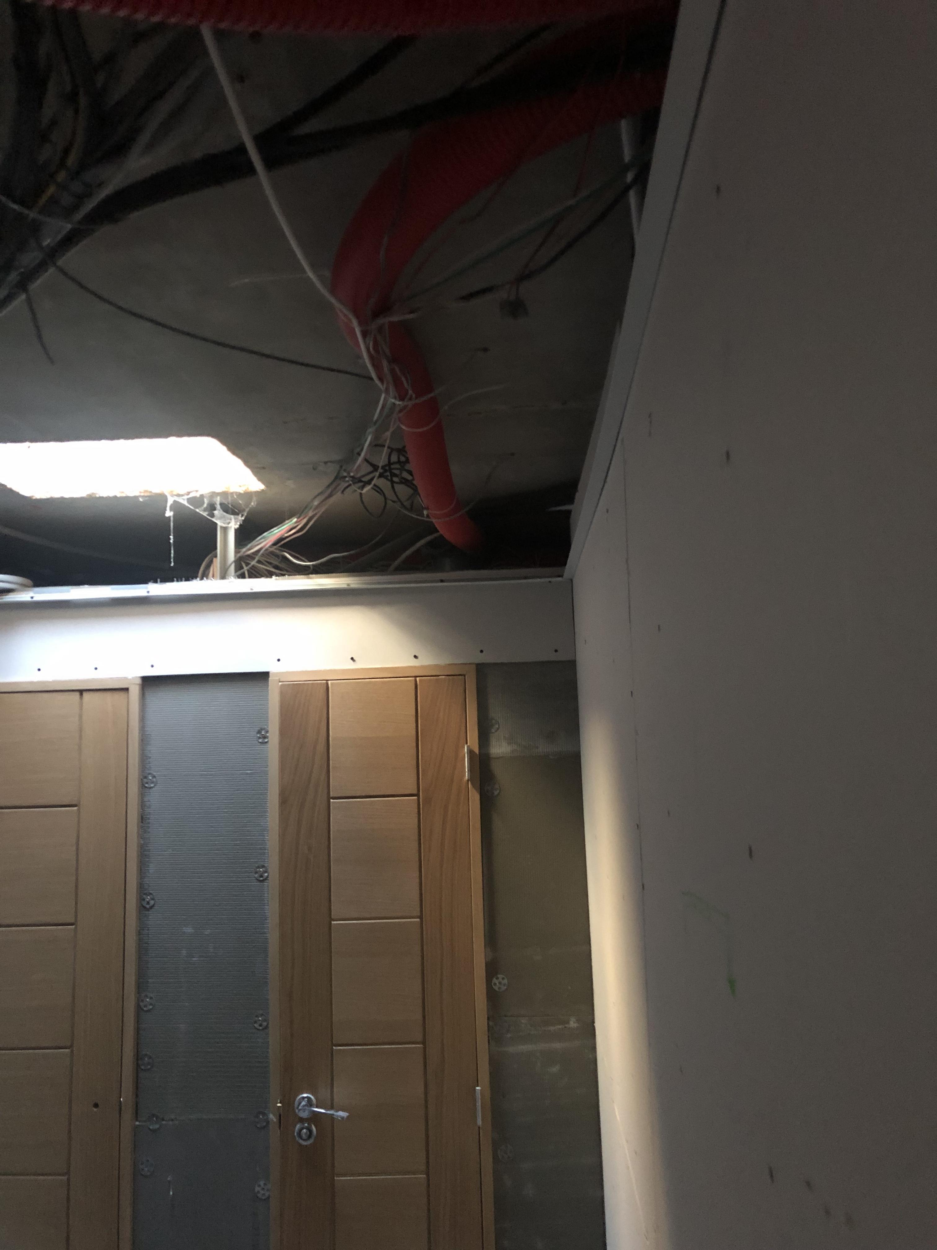

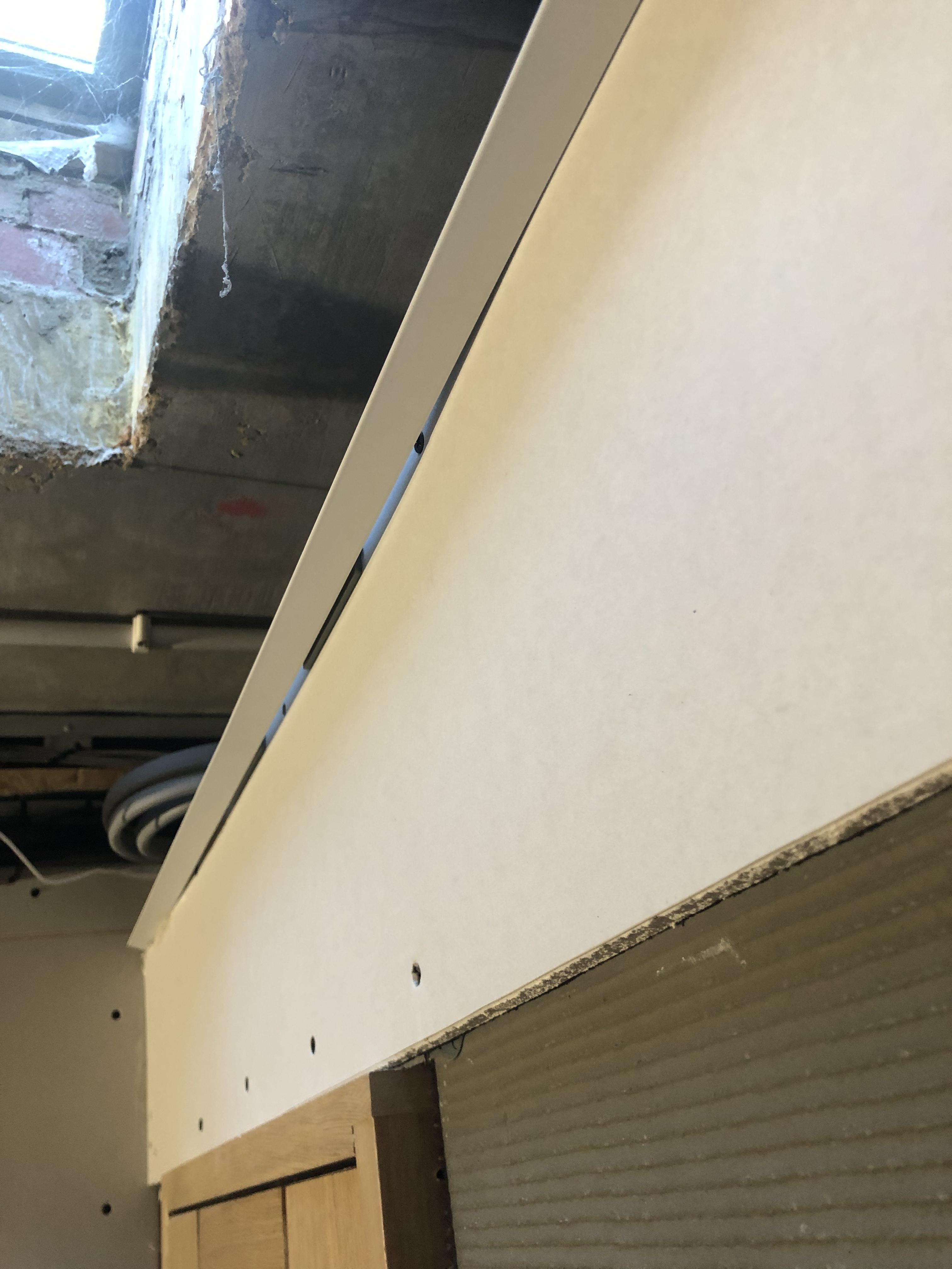

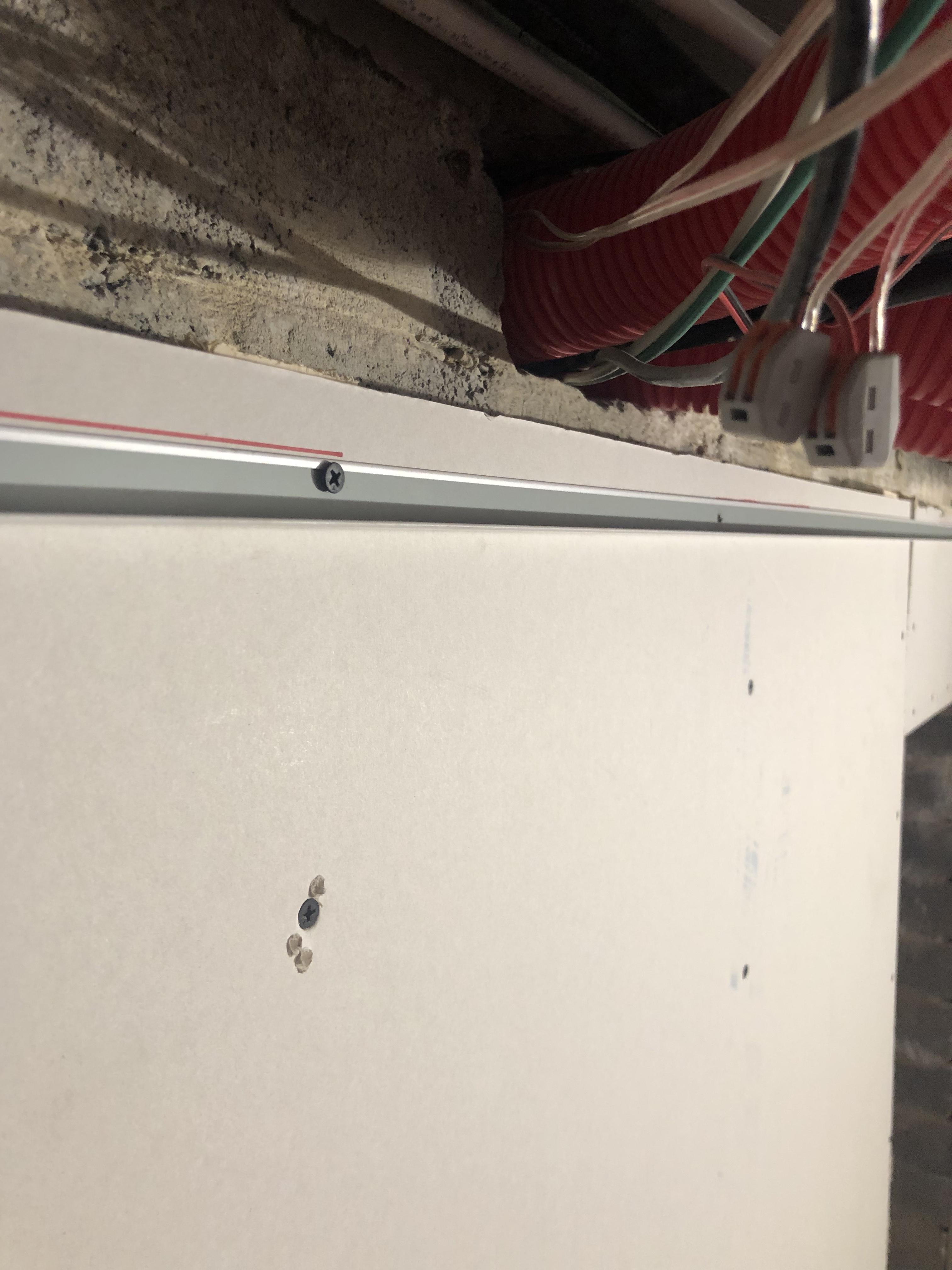

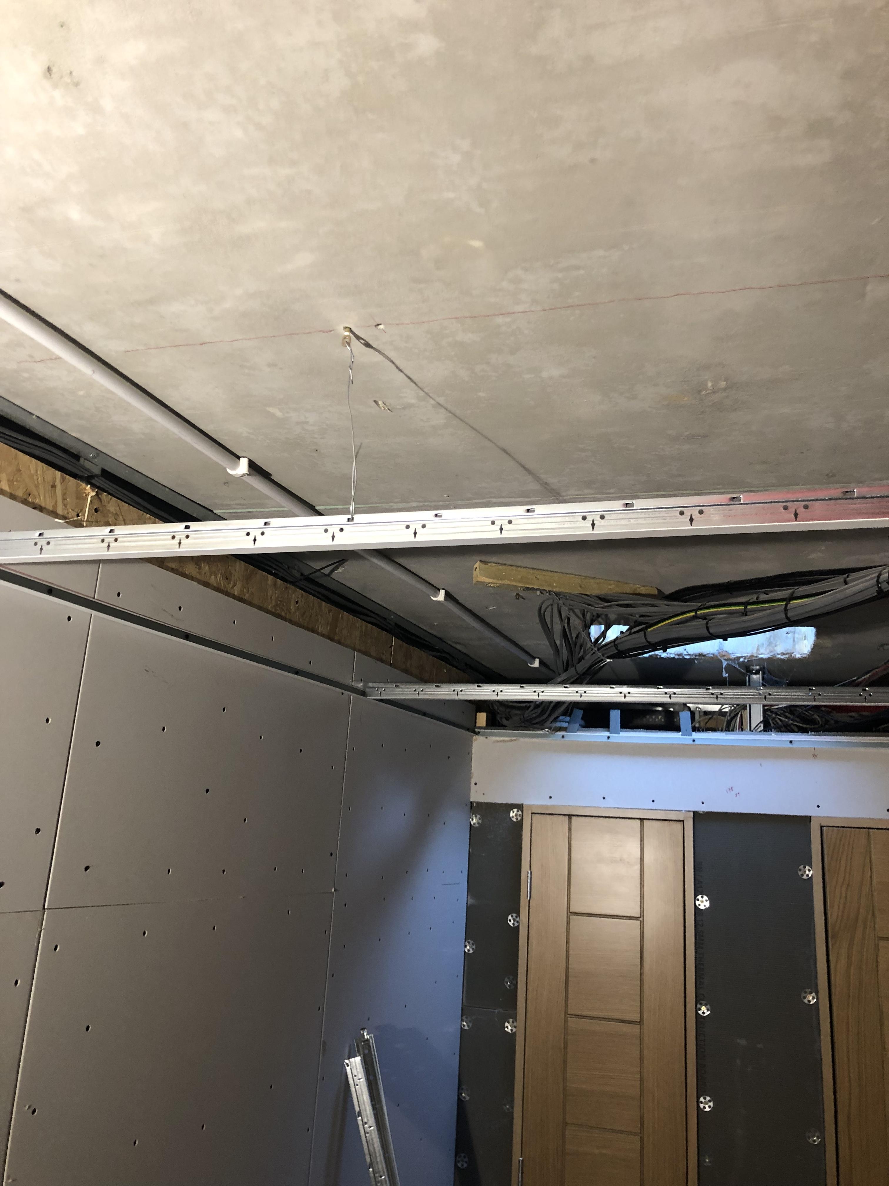

Pocster Posted January 20, 2023 Posted January 20, 2023 (edited) The plan was a suspended ceiling ; that office block look . The perimeter trim is so flimsy it bends under its own weight and deforms when a screw goes in . This why these ceilings always look crap ? At edges I pack it out as it can’t possibly bend . It still wobbles around . Im doing this in the wrong order I.e walls not plastered ; because waiting on a plasterer will hold me up . Intention was he will skim up to the trim . Then I will caulk along the edge as it’s bound to crack . Am I just being crap ? ( rhetorical question ) Thought the perimeter trim would be easy ! 😞 Edited January 20, 2023 by pocster
Pocster Posted January 20, 2023 Author Posted January 20, 2023 Suppose once skimmed and painted - could trim over the trim ffs !
Pocster Posted January 20, 2023 Author Posted January 20, 2023 This trim is SO flimsy shit!. Also when the 'structs' come across to support the tiles how do they fit to the trim??? (expletive deleted)ing rubbish - gonna email the company now and rant .. A FRIDAY RANT!
Pocster Posted January 20, 2023 Author Posted January 20, 2023 Just spoke to them. Stupid (expletive deleted) ; the trim goes the other way round. I did actually check this and assumed the trim visible width was the same as the struct width. But apparently not. (expletive deleted)ing Friday!

nod Posted January 20, 2023 Posted January 20, 2023 All the weight is on the cables holding the cross struts Use tack blocks around the perimeter Chanel The Chanel should really be fitted to a black timber baton to form a shadow baton

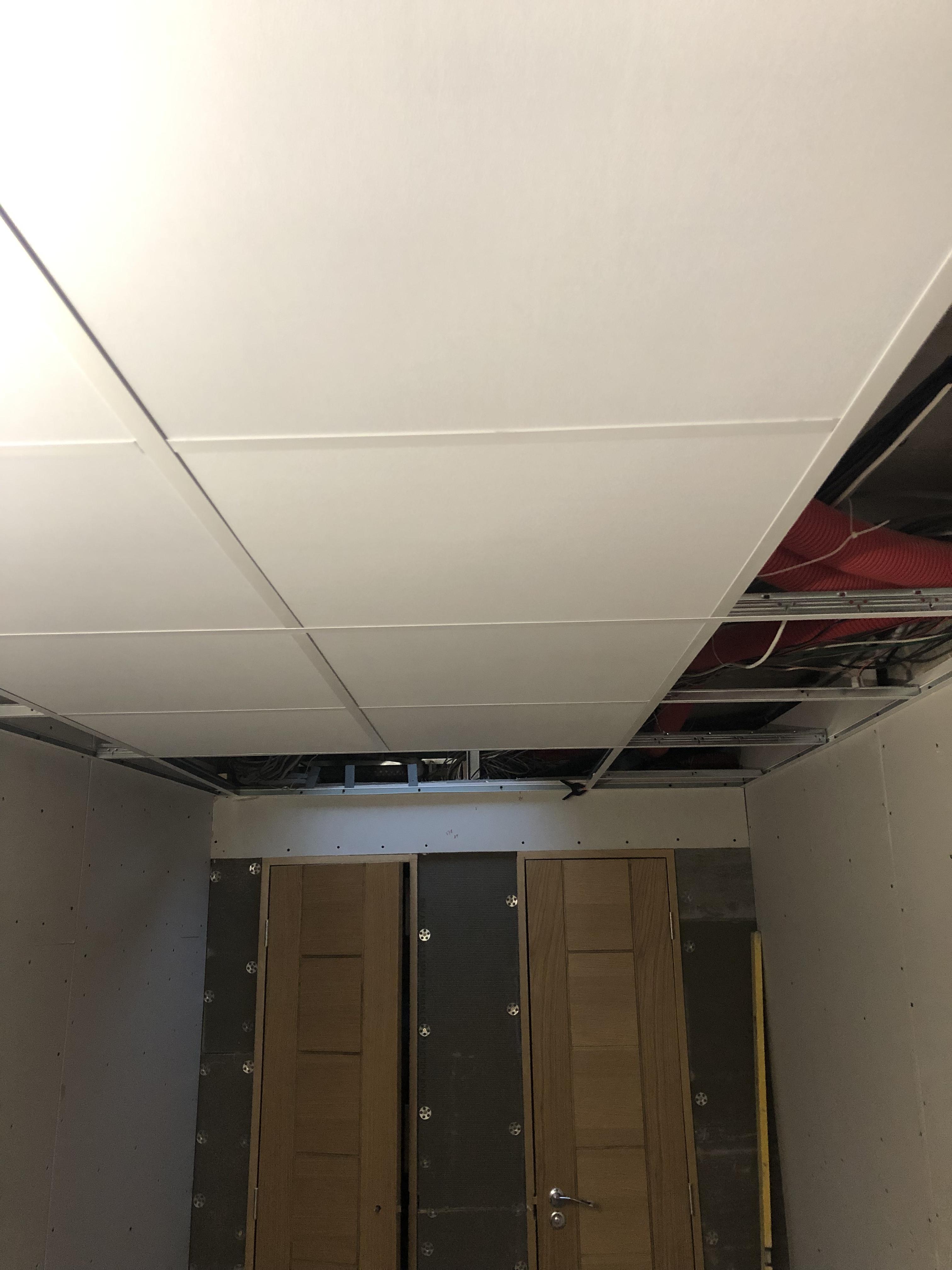

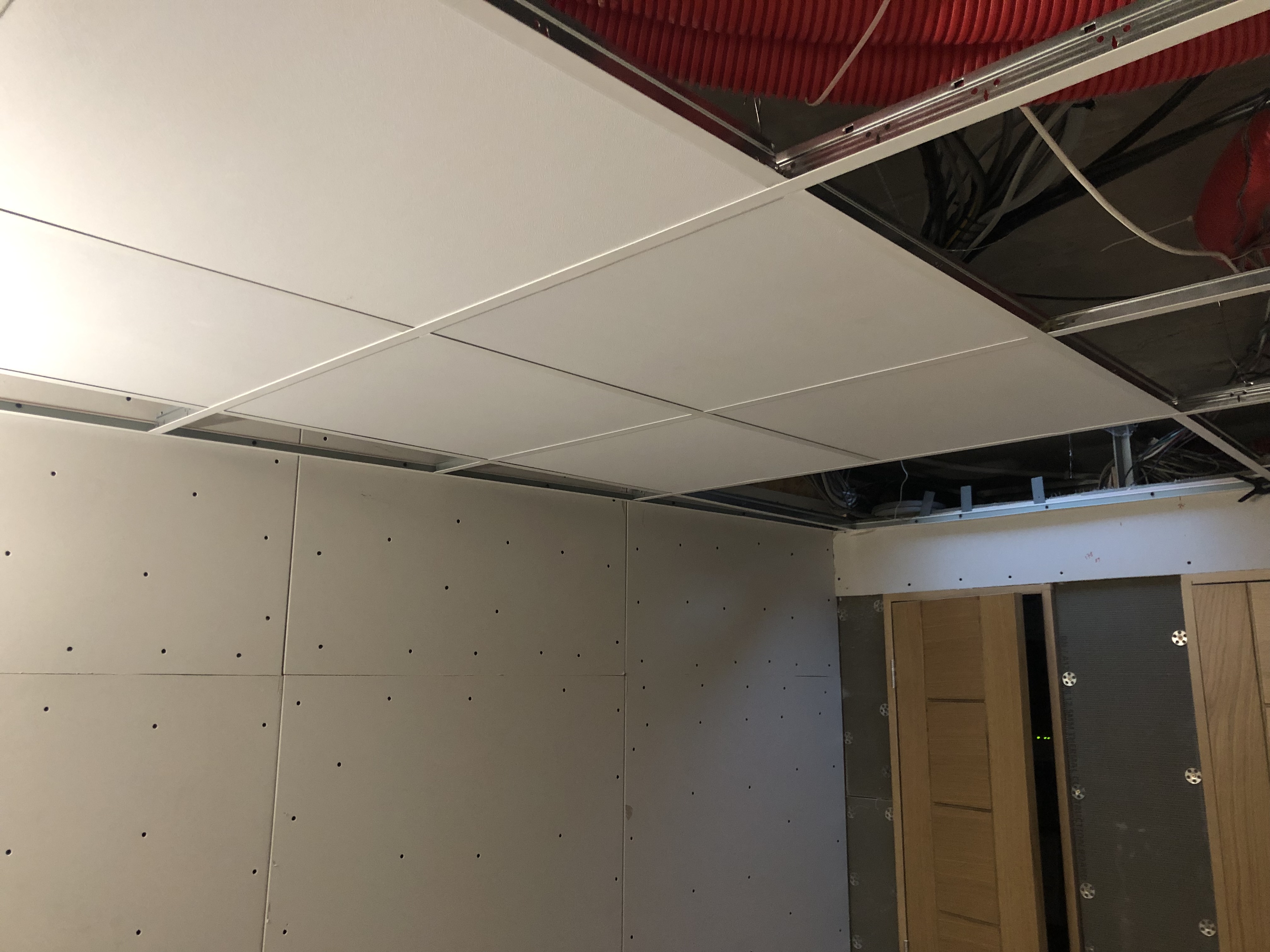

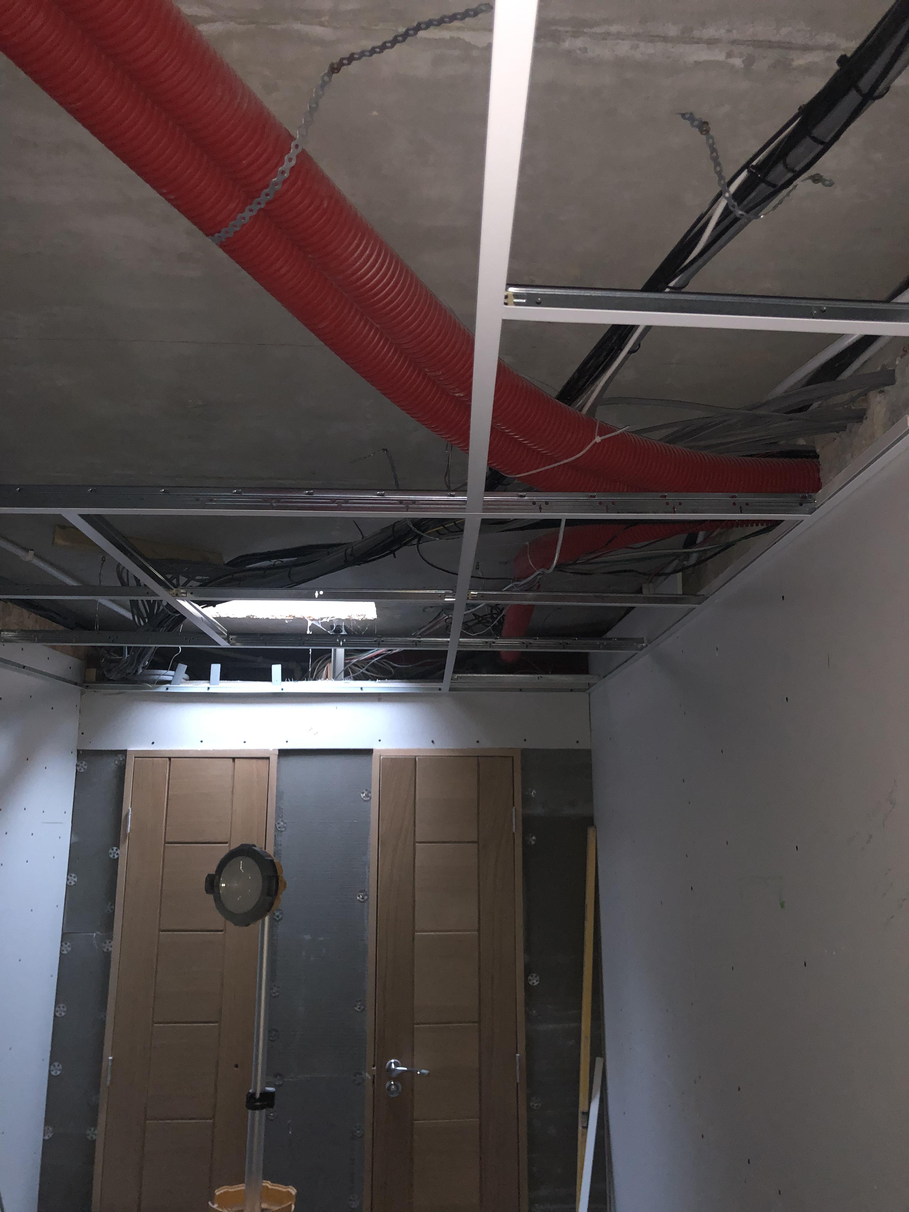

Pocster Posted January 24, 2023 Author Posted January 24, 2023 Struggling with this - thought it would be so easy . I just don’t get how the system works . Wire hangers . Too loose and they aren’t taking the weight of the main struct . Too tight and it hovers . No easy way to adjust ( twist and hope ! ) . Is there something better than hanger wire for a concrete ceiling ; that you can adjust the height as you go ? The main structs ( all structs ) that sit on the wall trim . They just sit there - not fixed . This ‘mesh’ isn’t going to have rigidity. The only thing stopping it swaying and moving will be the tiles . Am I doing this wrong ? ( seen on some USA video they rivet to the wall trim ) . Any advice welcome 🙄
Big Jimbo Posted January 24, 2023 Posted January 24, 2023 If it helps you feel better. I love the doors. That's going to be a lot of drilling into the concrete slab for the bits of wire. 1
Pocster Posted January 24, 2023 Author Posted January 24, 2023 24 minutes ago, Big Jimbo said: If it helps you feel better. I love the doors. That's going to be a lot of drilling into the concrete slab for the bits of wire. Funnily enough it ain’t ( according to instructions ) . 2 hangs per main runner . Max there will be 4 main runners - so it’s no problem. The ‘wedge’ fixings into concrete work surprisingly well . I just don’t get how this is held square ( apart from the tiles ) . Still I’ll knock this shit up and we will find out when SWMBO accidentally knocks it and the entire ceiling comes down 👍 1
Big Jimbo Posted January 24, 2023 Posted January 24, 2023 When i had a large office done, they dropped in the edge tiles as they went. Then filled in the middle.
Pocster Posted January 24, 2023 Author Posted January 24, 2023 58 minutes ago, Big Jimbo said: When i had a large office done, they dropped in the edge tiles as they went. Then filled in the middle. Yeah I’ll probably do that as it should ‘square ‘ it . I’d just rather the frame was all square and fixed I.e rigid . 1

Pocster Posted January 25, 2023 Author Posted January 25, 2023 The edge tiles made me swear - so will leave them until tomorrow. My logic was whole tiles will square the frame ….. 1
ProDave Posted January 25, 2023 Posted January 25, 2023 19 minutes ago, pocster said: The edge tiles made me swear - so will leave them until tomorrow. My logic was whole tiles will square the frame ….. Is it an illusion, or is that left hand slither narrower at the end by the doors? Is the room not square?
