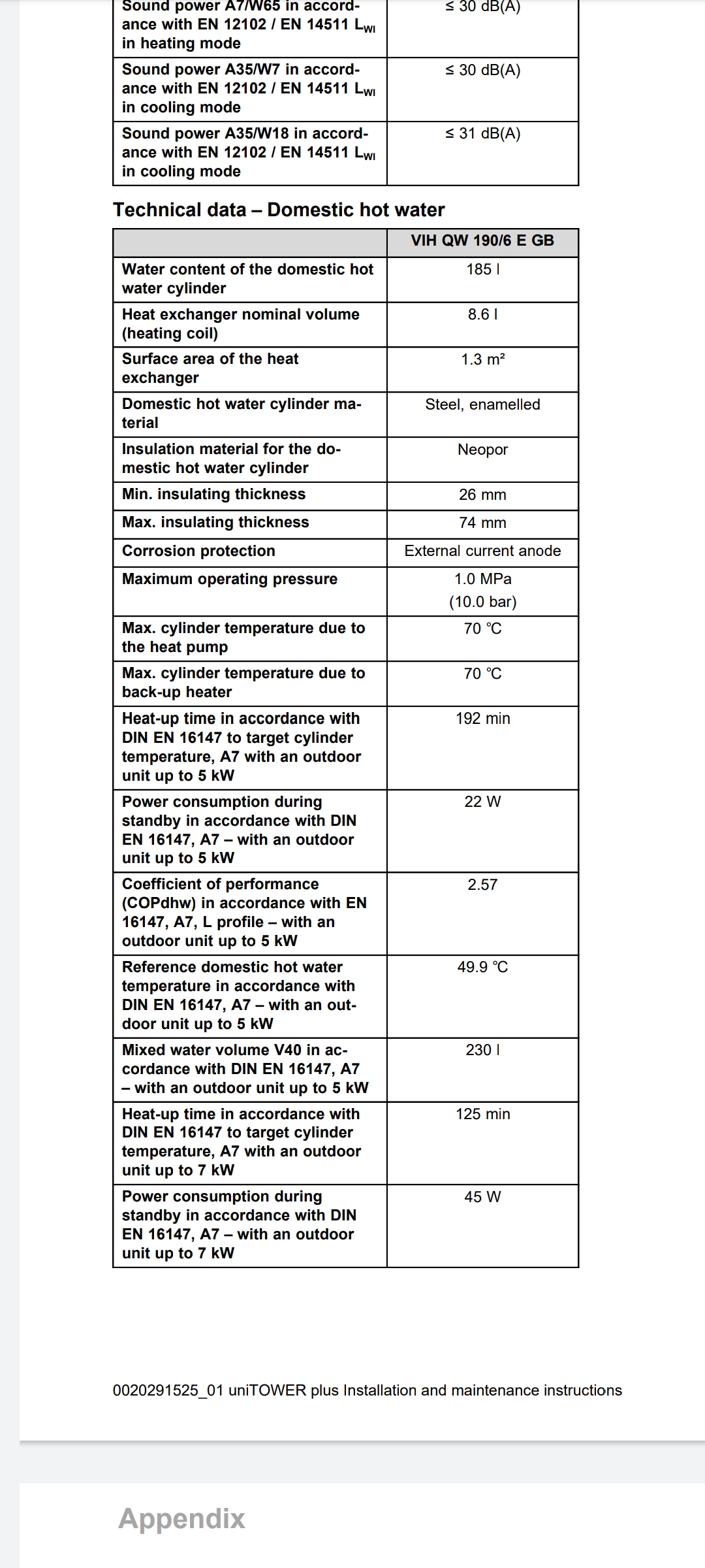

JohnMo Posted January 15, 2023 Share Posted January 15, 2023 MSC quote are generally just taking people for mugs from what I see. Others on here as mentioned above have excluded the MSC grant and saved. Had a look at the unitower a while ago, the coil is the largest in the world, so reheat times and temperature will not be the best. And it just a cylinder with a 3 way diverter valve. You save a lot with a better performance cylinder and a £150 3 port diverter. If the UFH is a single zone, no buffer required. Then your material list is 3 port diverter - £150 Flexible hoses x2 - £150 Cylinder - £1000 to 1500 Heat pump - depends on make and size, but I just got a new one (Maxa 6kW inverter) from eBay for £1300. Basically the same unit as sold by (made for) Viesmann for £4000+. Flex feet for HP - £70 Copper pipe and insulation Maybe a couple of thermostats, expansion vessel, isolation valves, filter ball valve, antifreeze valves (or glycol) bits and bobs - about £600 1 1 Link to comment Share on other sites More sharing options...
MoDo Posted January 15, 2023 Author Share Posted January 15, 2023 (edited) Thanks everyone, so it does seem MCS has become a get rich quick scheme for the installers. Shame really, at most you'd expect them to pocket the £5k grant instead of a typical lower margin, but in fact, it seems the situation is worse than that. I'm still keen on the Valliant Arotherm Plus which is a Monoblock so expect no glycol required, with Unitower. I've compared the heat exchanger size in the Unitower cylinder with comparable HP cylinder from Gledhill and seems to be within 0.06 m3 so seems alright? Valliant specs show a heat-up time of 125min which seems very decent. It also has a backup 8.7kWh heater (though I don't think this is used in the heat-up calcs as far as I can tell - as the pump itself can produce a flow temp of 75 degrees. This high flow temp is another reason I'd rather go with this unit (flow temp apparently achieved without backup heater). Valliant claim this higher flow temp means you can get over 300 litres out of their 180l cylinder due to blending down. This would be important for us as a family, one bath would potentially drain the cylinder at 50 degrees, so the ability to occasionally boost to 70 degrees to increase HW by over 100l is important. It also means a Sunamp could be added as they need 65 degree flow temp which is above the temp of most heat pumps. Finally the sound levels are also very low - important as plan to install Unitower in bedroom with heatpump on wall/flat roof opposite. Only downside seems to be the cylinder is enamel and not stainless - but something has to give! Apologies if this sounds like I work for Valliant (I don't)! Just trying to make an informed decision as simply don't have £17k in our budget for HP. Does sound from the advice above we can ignore the MCS installers and self-install + G3 plumber. Especially given the expansion vessel and all associated components are included in the single pre-assembled Unitower (if I've understood what's required for a functioning/safe system) should just be a matter of connecting the pipes and following the commissioning process. EDIT: Just to clarify too - the 7kW unit + Unitower is showing at £4999 or below online (before trade discounts) hence my shock at being quoted £17k to install. Edited January 15, 2023 by MoDo 1 Link to comment Share on other sites More sharing options...

JohnMo Posted January 15, 2023 Share Posted January 15, 2023 Data about unistore, it only has a 1.3m2 coil, typical heat pump cylinder would have a 3m2 coil. That would give faster heat up times for the same flow temp. So spending less time at a low CoP and therefore a better annual SCoP. It's also a steel enamel tank not a duplex stainless steel one, so has a anode to be replaced every one to two years. Link to comment Share on other sites More sharing options...

MoDo Posted January 15, 2023 Author Share Posted January 15, 2023 5 hours ago, JohnMo said: Data about unistore, it only has a 1.3m2 coil, typical heat pump cylinder would have a 3m2 coil. That would give faster heat up times for the same flow temp. So spending less time at a low CoP and therefore a better annual SCoP. It's also a steel enamel tank not a duplex stainless steel one, so has a anode to be replaced every one to two years. Looked at a Gledhill and OSO Heat pump cylinder - the OSO has a similar sized coil, though exceptionally low heat loss per 24h. The Gledhill does have a much larger coil though like you say, though higher heat loss. Is replacing an anode a DIY job or is the plan for these enamel cylinders to last the warranty period and then fail? Link to comment Share on other sites More sharing options...
JohnMo Posted January 15, 2023 Share Posted January 15, 2023 https://www.vpshotwatercylinders.co.uk/product/gledhill-stainless-lite-plus-heat-pump-cylinder-210-litre/ 3m2 Or https://www.cylinders2go.co.uk/shop/renewable-energy/200-litre-telford-tempest-heat-pump-cylinder/ 3.3m2 Coil area is the most important thing, otherwise you spend an age trying to heat the cylinder up and you will use loads of energy and still have no hot water. Couldn't find the oso, but think you need the geocoil on that range. Heat loss will be way less than they claim, as they are rated at the same temp something like 75 deg. Your cylinder will be at close to 50 deg. 1 Link to comment Share on other sites More sharing options...
