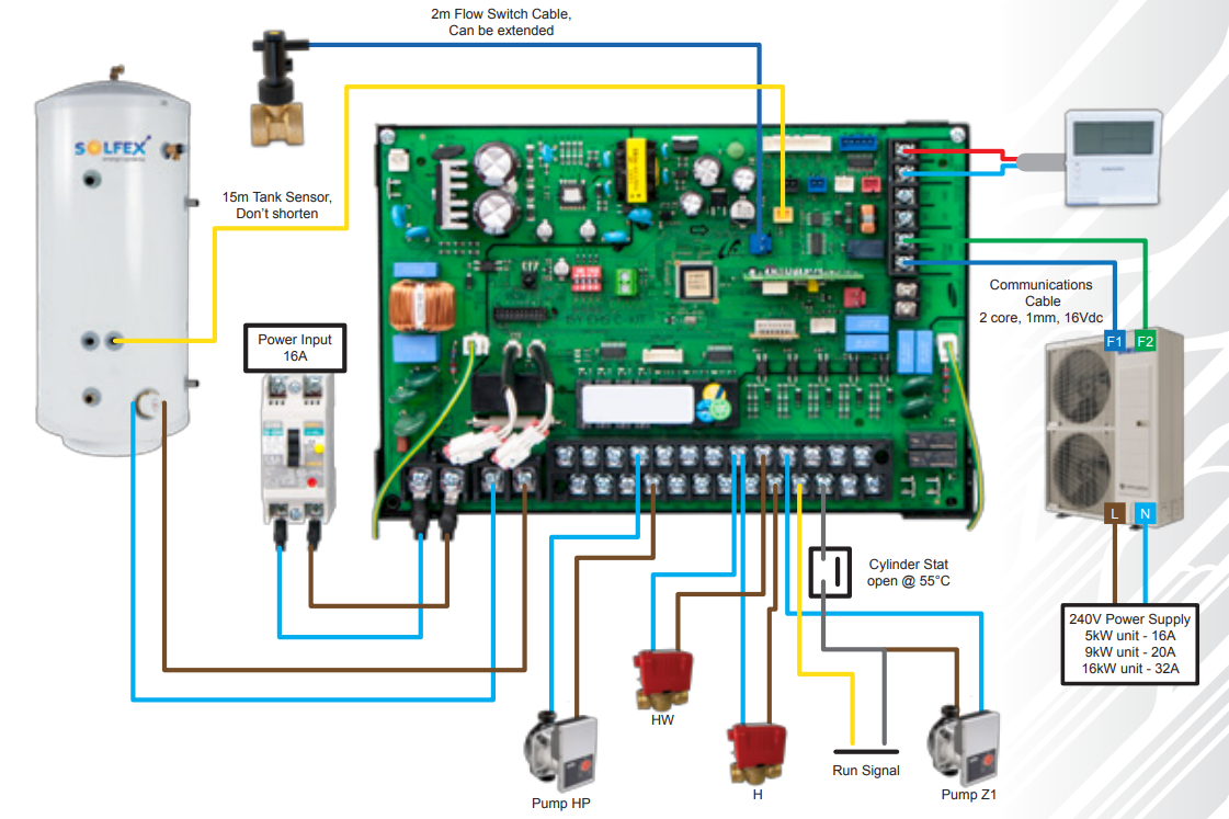

13 minutes ago, MikeSharp01 said:
Do you think your system looks like this?
Pretty much but no Heating storage tank.

28 minutes ago, MikeSharp01 said:
Hi This image from another post on here gives you a good indication of your system:
721633458_Screenshot2023-01-12at09_41_05.thumb.png.479c8d38349403875143ff30b2eb1474.png
They are very close , strange that I have a holding tank for heating, but that surely is a good thing. I'm not sure were the coli is placed in the dhw , I m sure I can work that out , doesn't matter just now. I have a hot water expansion and dhw expansion tank

Sorry I haven't read the whole thread, just this last page, but when you say holding tank do you mean buffer tank. If so is it fitted near where CH1 Zone Valve is shown on the schematic.
If you look back there is a picture of my system , water to right,  valves between tanks. Not sure which valve is which till I study it again.
Page one of thread.

So far , I have found out part of my fault is an intermittent HW motorized valve is faulty. Which would explain scavenging of the system .
Also not certain , but the valves  (HW and Heating ) may wired wrongly . Electrician checking Friday.

As I never finished this thread properly , I thought I would say much of the problems I had are gone .
The plumber /electrician I eventually found knew what he was doing and found all the wiring wrongly set up. Basically the system was not independently running between the two sys ie. DHW  AND HEATING . So all last year through the summer , heating side was using cold and vice versa!
Bills are a lot less , thankfully.
