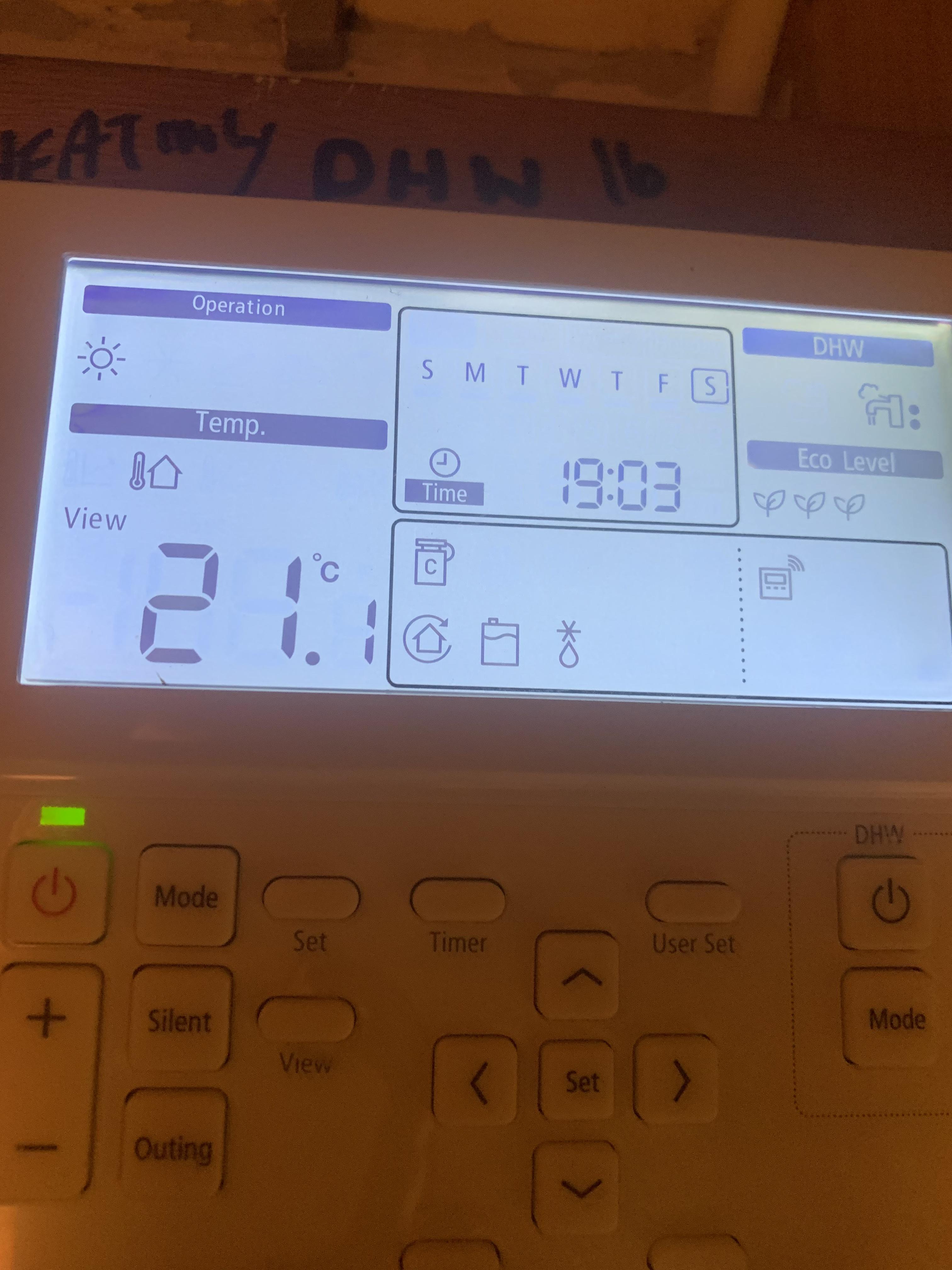

Alfapat Posted January 14, 2023 Author Share Posted January 14, 2023 1 hour ago, Alfapat said: Ha, they are cold just now as no requirement for heat but monitoring. The small icon is a defrost symbol , which I didn't notice taking the pic. Link to comment Share on other sites More sharing options...

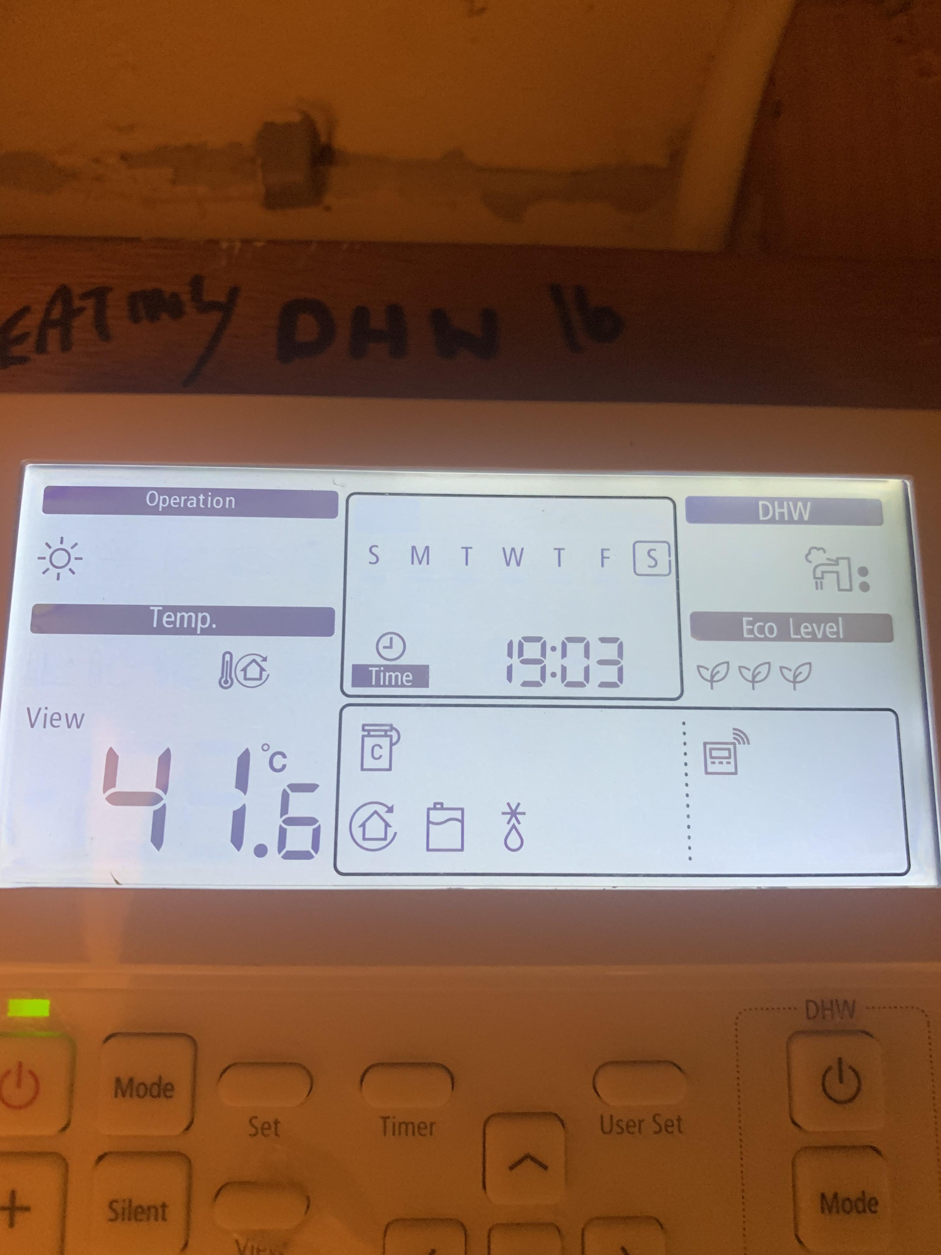

ProDave Posted January 14, 2023 Share Posted January 14, 2023 1 hour ago, Alfapat said: What is the symbol above the 1 of 41 in this picture, sory I am not familliar with this controller. It is looking to me like about 41 is what the water leaving temperature is set to and you need to find where to turn that up? Link to comment Share on other sites More sharing options...
Alfapat Posted January 14, 2023 Author Share Posted January 14, 2023 33 minutes ago, dpmiller said: have you checked the temperature coming out of the tap? The sensor might be faulty, there's generally a calibration function in the menu too. The temp is reflective of what is indicated , but I will measure it. 19 minutes ago, ProDave said: What is the symbol above the 1 of 41 in this picture, sory I am not familliar with this controller. It is looking to me like about 41 is what the water leaving temperature is set to and you need to find where to turn that up? It’s a temp signal your seeing which then indicates the circ temp Link to comment Share on other sites More sharing options...
Alfapat Posted January 14, 2023 Author Share Posted January 14, 2023 (edited) 33 minutes ago, ProDave said: What is the symbol above the 1 of 41 in this picture, sory I am not familliar with this controller. It is looking to me like about 41 is what the water leaving temperature is set to and you need to find where to turn that up? Yes that is the circulation temperature, water is shown at the tap symbol . The circ temp is feeding either the heat temp for rads or water but not both. Edited January 14, 2023 by Alfapat Link to comment Share on other sites More sharing options...

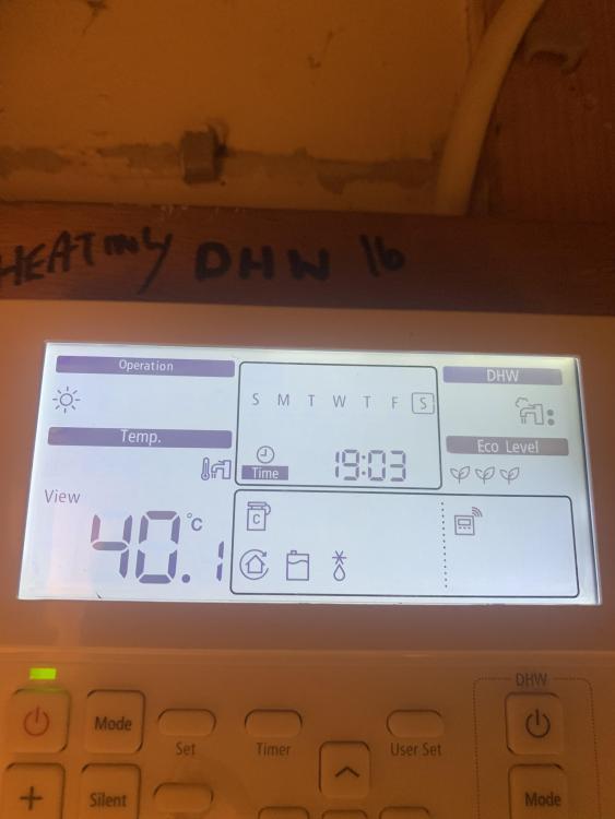

Alfapat Posted January 14, 2023 Author Share Posted January 14, 2023 Yes that’s what I did , well it doesn’t go to that, only 55 is max and that hasn’t helped , 45 circ temp just now and DHW 40 . Switching back to fifty. Link to comment Share on other sites More sharing options...
ProDave Posted January 15, 2023 Share Posted January 15, 2023 10 hours ago, Alfapat said: Yes that’s what I did , well it doesn’t go to that, only 55 is max and that hasn’t helped , 45 circ temp just now and DHW 40 . Switching back to fifty. So are you saying you have set the water temperature from the ASHP to 55 degrees yet it is still only delivering water from the ASHP at 45 degrees which in turn is only getting the tank to 40 degrees? If so either something is stopping the ASHP reaching that set temperature, i.e. absorbing the heat as fast as it can produce it (which is why I asked if the heating was on as well) or the ASHP is faulty? Or you are not understanding the settings and not setting what you think you are which is where we really need someone who knows this particular heat pump to advise. Link to comment Share on other sites More sharing options...

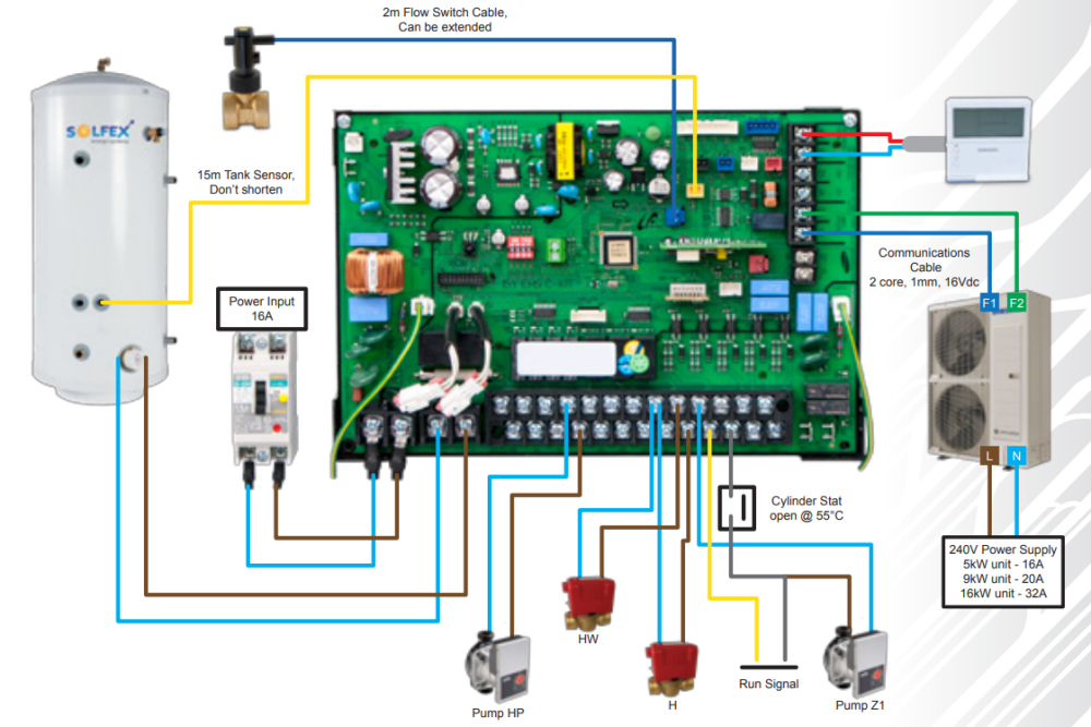

Alfapat Posted January 15, 2023 Author Share Posted January 15, 2023 7 minutes ago, MikeSharp01 said: Do you have a systems diagram of your setup that may have been left by the installer, first or second but second preferably? No , never any handover Manual by either. I have downloaded that and following the field settings I cant see for the life of me Why its so wrong .There are schematics so let me ind one that suits my set up. Link to comment Share on other sites More sharing options...
Alfapat Posted January 15, 2023 Author Share Posted January 15, 2023 New Text Document.txt This the nearest I can get . The schematics dont show my exact system , but basically an unvented Hot water tank shown in pics shown previously and heating storage tank waiting for requirements if neede for heating circ. Link to comment Share on other sites More sharing options...
MikeSharp01 Posted January 15, 2023 Share Posted January 15, 2023 Cannot see any pictures but the text is useful. Link to comment Share on other sites More sharing options...
MikeSharp01 Posted January 15, 2023 Share Posted January 15, 2023 Looks like you can turn on the immersion heater to get the bath problem sorted. Not sue that 2Deg C is sufficient difference to get the tank to ever reach the 48Deg C figure, has it ever reached 48 with the 50Deg setting? As the actual temperature out of the ASHP will be much lower by the time it reaches the tank coil almost no matter how much insulation you have. So you need a few more degrees on that setting otherwise it won't get to temperature and switch to heating. 18Kw is loads so you should have no problem delivering serious quantities of HW to the tank but the temp must be high enough to overcome the losses in the system. Link to comment Share on other sites More sharing options...
