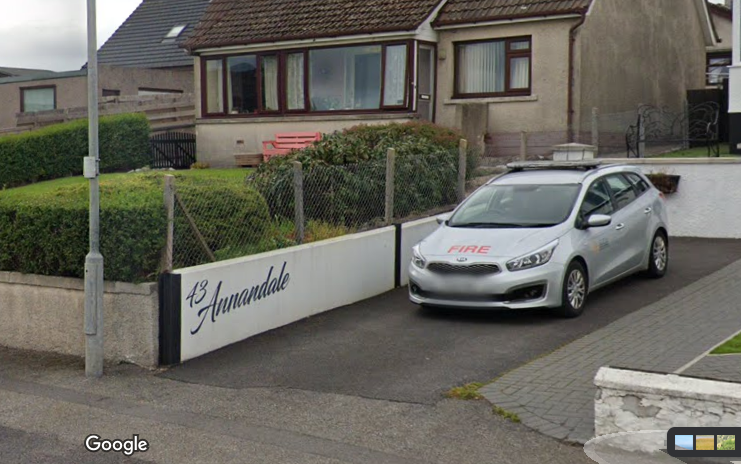

I rewired an old cottage a few years back that had subsidence issues.  It was in danger of sliding down the hill.
But that was not my point, there was also a similar height retaining wall between the cottage and next door, same situation next door was higher.
The solution in this case was a new retaining wall was built on the land owned by the cottage but right up to the existing leaning wall.  But the system they used was not what we conventionally know as a retainig wall, but a system where big piles were driven into the ground, and then the concrete sections making the wall dropped in behind the piles.
Does anyone know of such a sysatem, it would seem ideal for this case, easy to install and would not take up much of @PXR5 garden.
EDIT here is a picture from streetview of the wall I am refering to:
That white wall with the house name painted on is the new retaining wall, see the steel piles driven into the ground and the concrete panels lifted in.  Behind the new wall is the old failing retaining wall still in place, still with the neighbours planting and fence just where it was.
Does anyone know of such a system
A local garden centre has a retaining wall of around 1.5m , holding back a plain earth bank behind which (3m away) there's a pond. They dropped some new timber railway sleepers end on into a trench, lined it with plastic, a French drain,  some 20mm gravel and back-filled to the top of the sleepers. Cheap as chips.
Carnforth rail yard has (had) many thousand of them - various lengths - stacked neatly - bet the job cost less than £5000. Delicious smell of Creosote.
Your design @ProDave would be better, but more expensive and a bit safer maybe?
Clearly a sensible  approach. It avoids any excavation for a new footing which could potentially damage the existing wall even more.
I guess you would need to ascertain whether the piling would hit any existing  footing , but that's easy enough with a spade and some effort.
