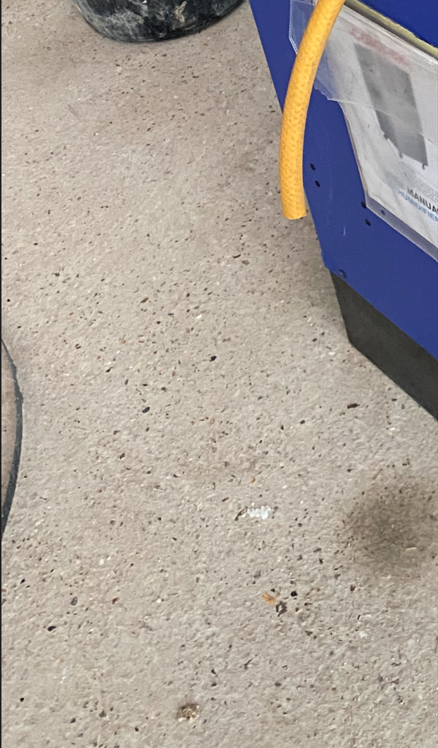

bob the builder 2 Posted January 8, 2023 Author Posted January 8, 2023 Hi All here is a sanp the concrete is quite ruff but only 5mm out in a few places (its a new raft floor) the tiles are 1.2 x 1.2m so large Do you think i can just get away with the adhesive or should i be levelling as the tiler suggests thanks
saveasteading Posted January 8, 2023 Posted January 8, 2023 31 minutes ago, bob the builder 2 said: should i be levelling as the tiler suggests Most people are surprised how much variation there is in what looks like a smooth slab..eg a b & q shed. There is a difference between smooth, and level. also that i have known a flooring company want a smooth concrete floor to be scabbled to get a grippy surface, and it then looked like yours. I can't really say any more because it has to be up to you and your relationship with the tiler. If you wanted to persuade him that it was ok, you put a long spirit level down and see how much gap there is.

Nickfromwales Posted January 9, 2023 Posted January 9, 2023 10 hours ago, bob the builder 2 said: Hi All here is a sanp the concrete is quite ruff but only 5mm out in a few places (its a new raft floor) the tiles are 1.2 x 1.2m so large Do you think i can just get away with the adhesive or should i be levelling as the tiler suggests thanks I've tiled floors where the average undulation was ~10mm, and that is doable tbh, but that was with 600x600mm tiles. 1200x1200 will be a pita to lay, lift, re-lay etc so I can see the tilers concern. Unless one of us is going to come and tile it, this is moot tbh. As your tiler is stating what standards they are willing to work to, and how it should be done, if you deviate from that they'll probably tell you to do it yourself ( which is what I would do for sure )..... Levelling out few patches here and there, if it's as minimal as you describe (?), should be a half days work for the tiler. Just pay the tiler to do the spot-prep and get out of their way?? I use Ultra 2-part SLC and that's never once let me down. Will feather out from 5mm-2 to 3mm so don't go to the absolute edges of the ares you wish to level. Tile adhesive is more than capable of absorbing 3-5mm tbh, ( so this is a little bit like splitting hairs in absolute honesty ). Pay the tiler to prep the areas of doubt ONLY, and crack on with the tiling. If you or other get involved and the floor gives up, then expect the tiler to tell you it's your problem not theirs.
