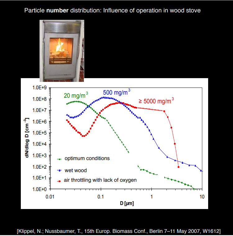

Iceverge Posted January 2, 2023 Posted January 2, 2023 2 hours ago, Garald said: Emission de CO (en %) 0.12 0.12% carbon monoxide is 1200ppm. Typical values in flue gas: Oil burners: 80 ppm - 150 ppm and Gas burners: 80 ppm - 100 ppm. 2 hours ago, Garald said: Particules fines (en mg/Nm³, @13% O2) 23 Typical values for an oil boiler might be 1.8 mg/Nm3 and 0 for gas boilers. The stated figure of 23 is lightly to be the optimal combustion conditions for the given stove. Highly difficult to achieve in real life. Look at the below graph to see how bad it gets if you are a bit off with your burning. Over a hundred times worse if you throttle the fire. Note the exponential scale. Buy a couple of €10 electric heaters and hide them away for the unusual cold day if you're concerned about polluting the air.
Garald Posted January 2, 2023 Author Posted January 2, 2023 3 hours ago, Iceverge said: 0.12% carbon monoxide is 1200ppm. Typical values in flue gas: Oil burners: 80 ppm - 150 ppm and Gas burners: 80 ppm - 100 ppm. Typical values for an oil boiler might be 1.8 mg/Nm3 and 0 for gas boilers. The stated figure of 23 is lightly to be the optimal combustion conditions for the given stove. Highly difficult to achieve in real life. Look at the below graph to see how bad it gets if you are a bit off with your burning. Over a hundred times worse if you throttle the fire. That's pretty shocking. 3 hours ago, Iceverge said: Buy a couple of €10 electric heaters and hide them away for the unusual cold day if you're concerned about polluting the air. Anything useful I might do with the fireplaces?
MikeSharp01 Posted January 2, 2023 Posted January 2, 2023 6 hours ago, Iceverge said: Over a hundred times worse if you throttle the fire. As in keep the oxygen input low and burn slowley - so letting it rip, as in force feed / allow free running oxygen, is a good / better thing?
jfb Posted January 2, 2023 Posted January 2, 2023 7 minutes ago, MikeSharp01 said: As in keep the oxygen input low and burn slowley - so letting it rip, as in force feed / allow free running oxygen, is a good / better thing? Yes
ProDave Posted January 2, 2023 Posted January 2, 2023 A lot of modern stoves, mine included, restrict how much you can restrict the air flow so it is impossible to throttle them down too much. They do this to meet the current emissions limits. While I love our stove, it's key advantage is free fuel. If you live in a city, and have no trees of your own, I would not have one.
