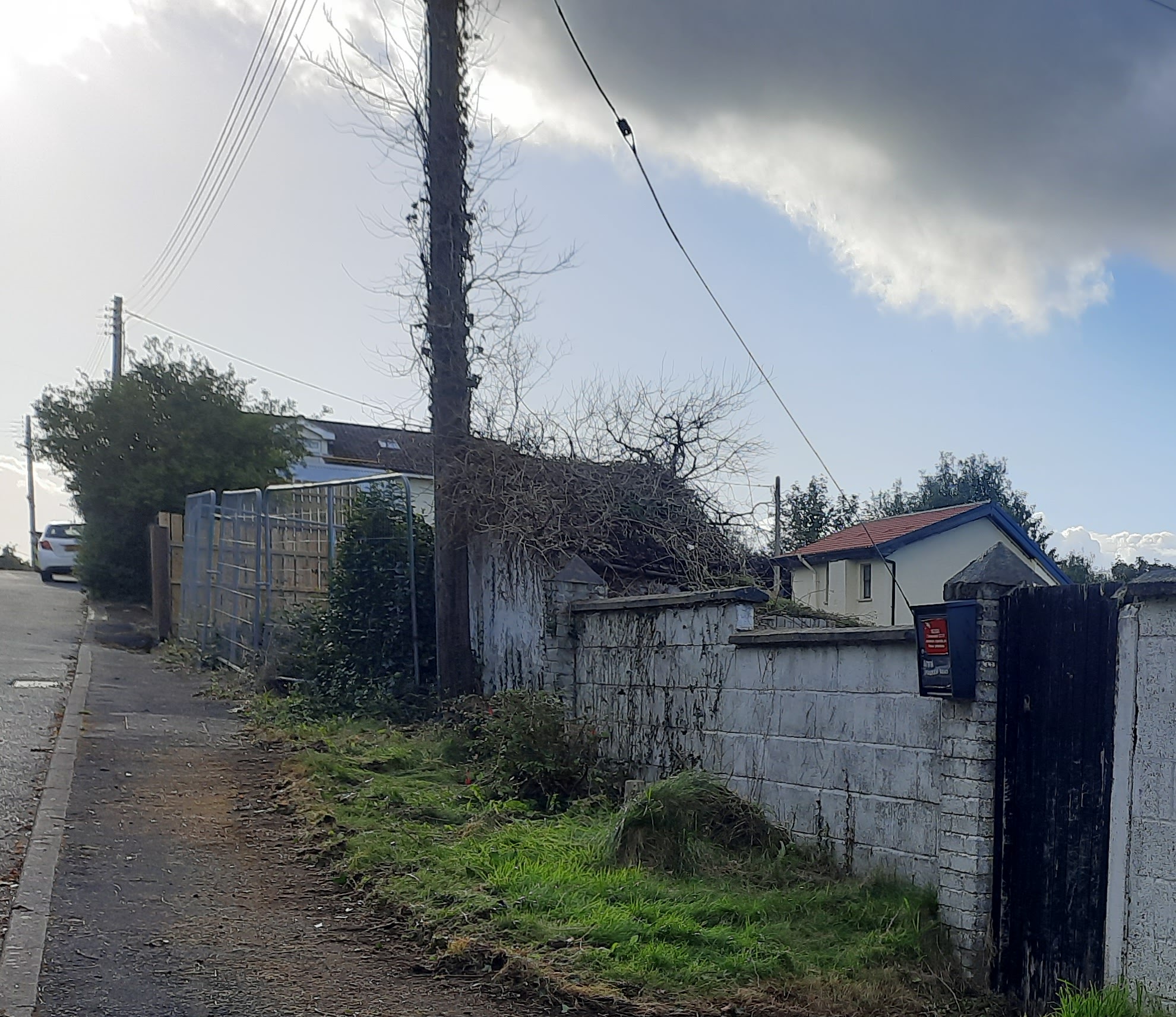

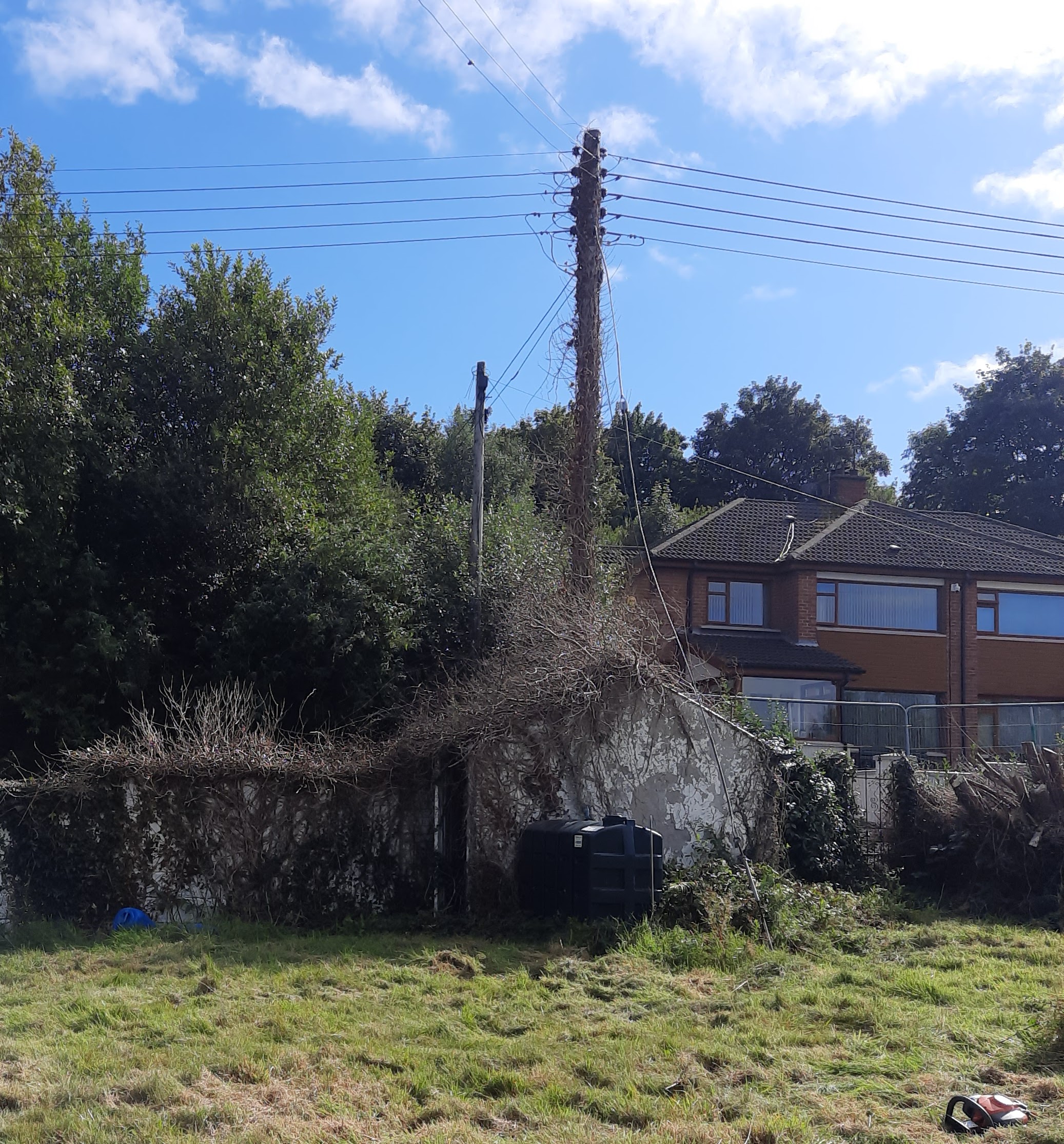

CalvinHobbes Posted December 17, 2022 Posted December 17, 2022 (edited) We have a 3 phase electric pole right smack in the centre of our would be entrance, it's located on a strip of verge owned by the council. There is a stay which stretches around 4m into our land where our drive should be. This evening an electrician friend suggested it was a clear health and safety risk and if we said that to the network company they would have to move it. I was going to email them tomorrow but was wondering what exactly is the risk? Is it that a vehicle could hit it (particularly if we had the entrance a few feet to the side, or perhaps someone could easily walk into it? You really could either walk into it at eye level, neck level or further along trip up over the darn thing.There are currently 2 old coal sheds which are to be demolished and they are immediately behind the pole, I am really concerned the digger could cause damage to it. The guy from the electricity company suggested he could move the stay nearer the pole but still - it's in the way. It would still be obstructive. It also would be an eyesore. We really need that entrance to get the splay and I have someone with significant mobility issues so getting them inside the property, beside the entrance massively diminishes risk when moving them. Any suggestions re the right terminology to use? Edited December 17, 2022 by CalvinHobbes
MikeSharp01 Posted December 17, 2022 Posted December 17, 2022 By the looks of the picture it is not staying much as it is so loose. Two things, firstly you should have a wayleave for that stay, if not you can apply for one and then, revoke it and I think they have to take it away unless they can show it must remain (not stay - did you see what I did there?). Secondly I cannot see them moving that pole unless you are prepared to pay for it and you are looking at both a very big bill and a heap of disruption. Having said that we have been working with our DNO (UK Power Networks) for 4 years trying to get a stay slightly moved so the wire does not go through the roof of our cycle shed! Frankly I would look at moving your entrance, left or right, it will be much simpler and a lot cheaper.
MikeSharp01 Posted December 17, 2022 Posted December 17, 2022 PS the wire coming from the pole over you land, is that going to feed your build or go over it? If it will go over it then you do have a case to have it moved / buried as I believe they are not allowed to run an open cable over a property. If they have to move that then some of the tensions in the whole system around that pole will change they will have to deal with that.
ProDave Posted December 17, 2022 Posted December 17, 2022 I suspect the stay will have to stay. If I am understanding your pictures, the stay is perpendicular to the road, so putting your entrance to one side of the pole, it will not be blocking the entrance. To prevent people walking into it, I would plant a row of shrubs / bushes directly underneath it and let them grow high enough and the stay will be hidden, embeded in the greenery.
Kelvin Posted December 17, 2022 Posted December 17, 2022 Our friends had a similar problem. The cost to move the pole was horrendous so they redesigned the entrance to the site. That stay is doing nothing so there’s an immediate health and safety angle. I would push the fact you have someone with significant mobility issues.

ProDave Posted December 17, 2022 Posted December 17, 2022 I am pretty sure that's 3 phase, neutral and earth 240V so "Low Voltage" in DNO speak. I don't know if that changes how close you can build to it or not? but will still affect materials unloading and if you need a crane etc. I am not sure from the plan you posted earlier which is new and which is existing buildings, and how far from the pole they are?
CalvinHobbes Posted December 17, 2022 Author Posted December 17, 2022 1 hour ago, ProDave said: I am pretty sure that's 3 phase, neutral and earth 240V so "Low Voltage" in DNO speak. I don't know if that changes how close you can build to it or not? but will still affect materials unloading and if you need a crane etc. I am not sure from the plan you posted earlier which is new and which is existing buildings, and how far from the pole they are? Yep it is deffo 3 phase and the plan is for the new buildings and have passed planning permission.
ProDave Posted December 17, 2022 Posted December 17, 2022 Ah, so it's a multi house development, not just a single self build. Surely then it is worth paying to have at least one span of that cable run undergrounded?
