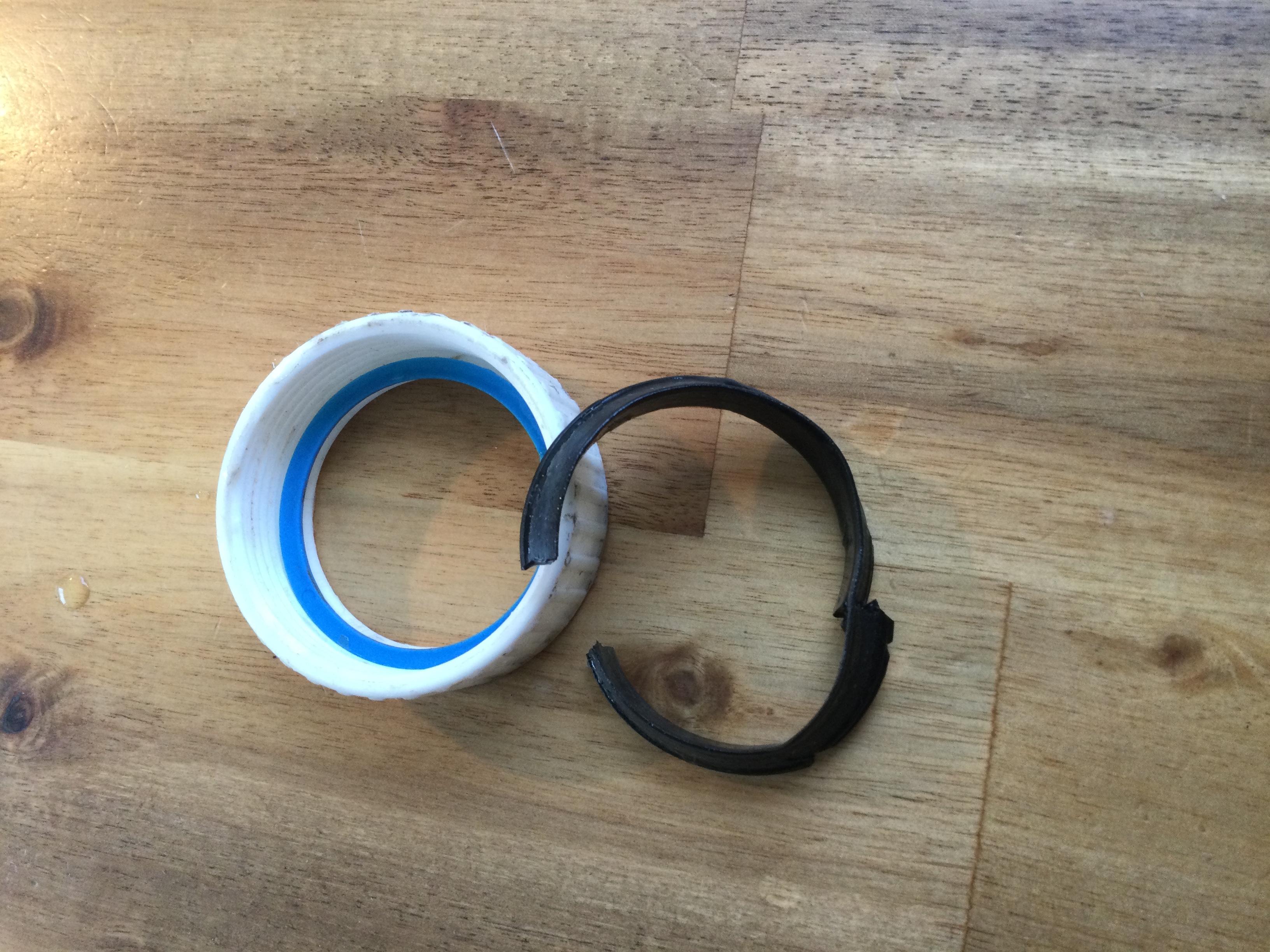

zoothorn Posted December 17, 2022 Author Posted December 17, 2022 Chaps, finally removed the u-bend trap section. Cleaned up ( no blockage) & refitting to the long underneath bath pipe, the black ring seal thing has fouled/ split. Much swearing. Can you get new black seal rings?? Or do I have to now replace the whole u-bend trap section?
Pocster Posted December 17, 2022 Posted December 17, 2022 4 minutes ago, zoothorn said: Chaps, finally removed the u-bend trap section. Cleaned up ( no blockage) & refitting to the long underneath bath pipe, the black ring seal thing has fouled/ split. Much swearing. Can you get new black seal rings?? Or do I have to now replace the whole u-bend trap section? You can get a new ring . I always worry it won’t be the exact size . So I buy a new fitting entirely as to be certain .

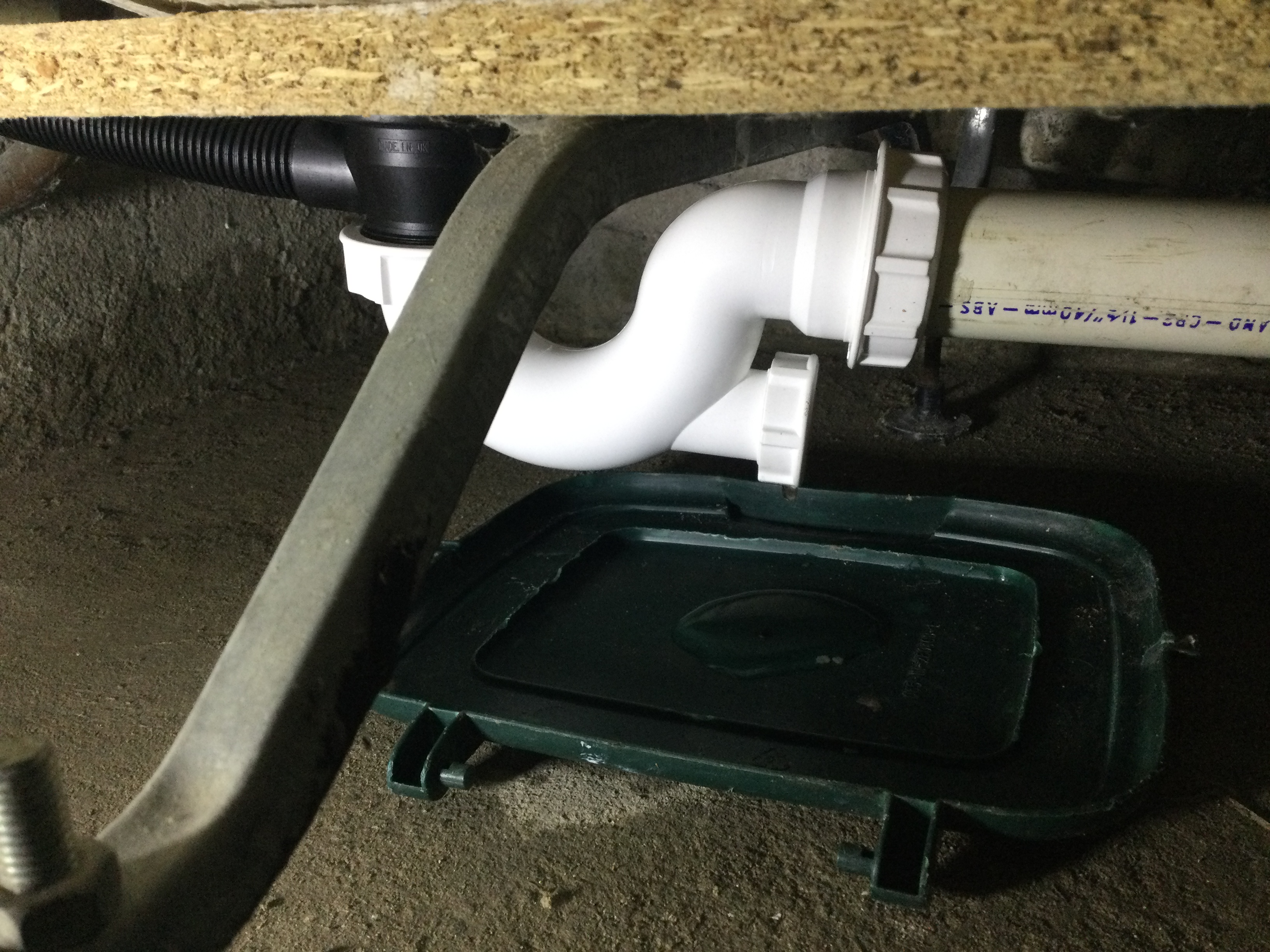

zoothorn Posted December 18, 2022 Author Posted December 18, 2022 JesusHchrist. Left the silicone overnight, now dry enough. Tested everything by a bucket of water into bath, undone plug.. constant drips from the trap lowest section. So tightened it up 1/8 turn as much as I could.. drips still happeneing, FFS!!!
Onoff Posted December 18, 2022 Posted December 18, 2022 Where the white meets the black? Going to be a bitch to get any PTFE tape around there for instance. In the white bit there should I think be a black rubber O ring and a solid backing washer? The backing washer compresses the rubber. Think I'd try and smear the threads with say Jet Blue Plus.
ProDave Posted December 18, 2022 Posted December 18, 2022 Adding sealant is a bodge and avoiding finding the reason. Find WHICH joint is leaking, where the black joins the white? Where the outlet from the trap joins the white pipe? Or the white cap on the trap below that? Or is is still leaking where the bath waste joins the bath or where the overflow joins into the black bath waste fitting?
Onoff Posted December 18, 2022 Posted December 18, 2022 8 minutes ago, ProDave said: Adding sealant is a bodge I agree but Jet Blue isn't a sealant per se but a joint compound.
dpmiller Posted December 18, 2022 Posted December 18, 2022 Looking at the levels and the location of the drip, I'd say it was drainoff/ rodding point dooberry. Perhaps someone forgot to stick an O-ring on the cap... unscrew the cap and see what's behind, and either shove a suitable O-ring there or wrap the thread in tape. DO NOT OVERTIGHTEN!!!
Marvin Posted December 18, 2022 Posted December 18, 2022 Use kitchen roll or tissue to find the source of the leak as it leaks. then sort out.
zoothorn Posted December 18, 2022 Author Posted December 18, 2022 1 hour ago, Onoff said: Where the white meets the black? Going to be a bitch to get any PTFE tape around there for instance. In the white bit there should I think be a black rubber O ring and a solid backing washer? The backing washer compresses the rubber. Think I'd try and smear the threads with say Jet Blue Plus. No, if you can zoom in.. leak's @ the lowest part, @ where there's a small extra screw cap thing. The drip is from here, & it's not from the white/ black junction further up, nor onward at the junction to the main long white pipe. I can visibly see it's coming from this extra small screw cap/ whatever the damn thing is.
ProDave Posted December 18, 2022 Posted December 18, 2022 2 minutes ago, zoothorn said: No, if you can zoom in.. leak's @ the lowest part, @ where there's a small extra screw cap thing. The drip is from here, & it's not from the white/ black junction further up, nor onward at the junction to the main long white pipe. I can visibly see it's coming from this extra small screw cap/ whatever the damn thing is. So unscrew it, make sure it has a rubber seal washer, make sure it is all clean, no foreign objects, re fit and re tighten and try again.
Onoff Posted December 18, 2022 Posted December 18, 2022 That's an access/rodding point for cleaning the trap out. Try turning the rubber washer around. You need to be 100% sure it's not leaking from higher up and running down to there.
zoothorn Posted December 18, 2022 Author Posted December 18, 2022 35 minutes ago, dpmiller said: Looking at the levels and the location of the drip, I'd say it was drainoff/ rodding point dooberry. Perhaps someone forgot to stick an O-ring on the cap... unscrew the cap and see what's behind, and either shove a suitable O-ring there or wrap the thread in tape. DO NOT OVERTIGHTEN!!! Im going to have to redo the whole thing dpm. I dont have ptfe tape, I cant get a hand to it to undo/ do up anyway even if I could. Its just junk made, stupid design as you could never access this extra fk knows what screw cap anyway. So another trip & 2 hours work. At least I had a bath, just had to, but dreading draining it as I cant get anything shallow enough under to catch these drips. So another bailing out first then. Damn bloody job.
zoothorn Posted December 18, 2022 Author Posted December 18, 2022 1 minute ago, ProDave said: So unscrew it, make sure it has a rubber seal washer, make sure it is all clean, no foreign objects, re fit and re tighten and try again. I can't unscrew it, the design means access isn't feasable. All I could logically do, is just about with all my strength to access & contort my hand, tighten it up, which I did 1/8 turn expecting this slighty loose aspect to fix it. Exactly the same. But now it's even less possible to unscrew even if I had some ptfe tape. I need a new one simply without this stupid ass extra lower section.
zoothorn Posted December 18, 2022 Author Posted December 18, 2022 5 minutes ago, Onoff said: That's an access/rodding point for cleaning the trap out. Try turning the rubber washer around. You need to be 100% sure it's not leaking from higher up and running down to there. Hi Onoff. Understood thanks. I am 100% sure, before posting this new problem exactly where, & where not, the leak is coming from. Its simply dry at the black/ white junction above. And I can see it coming out the low thing screw cap. And it's dry onward at the junction to main 2m bath sloping pipe (dry on the underside of the sloping pipe too, just as confirmation).
