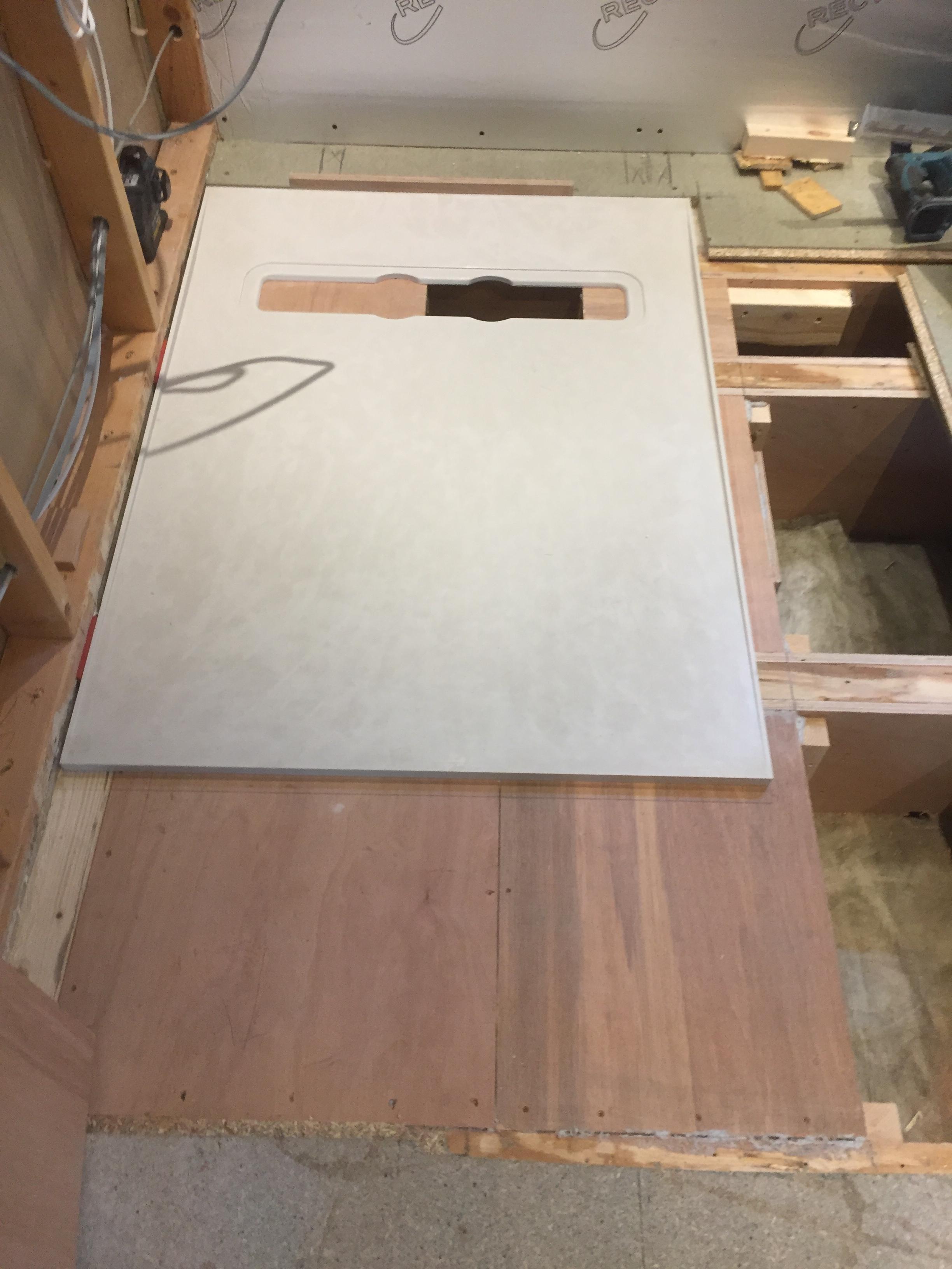

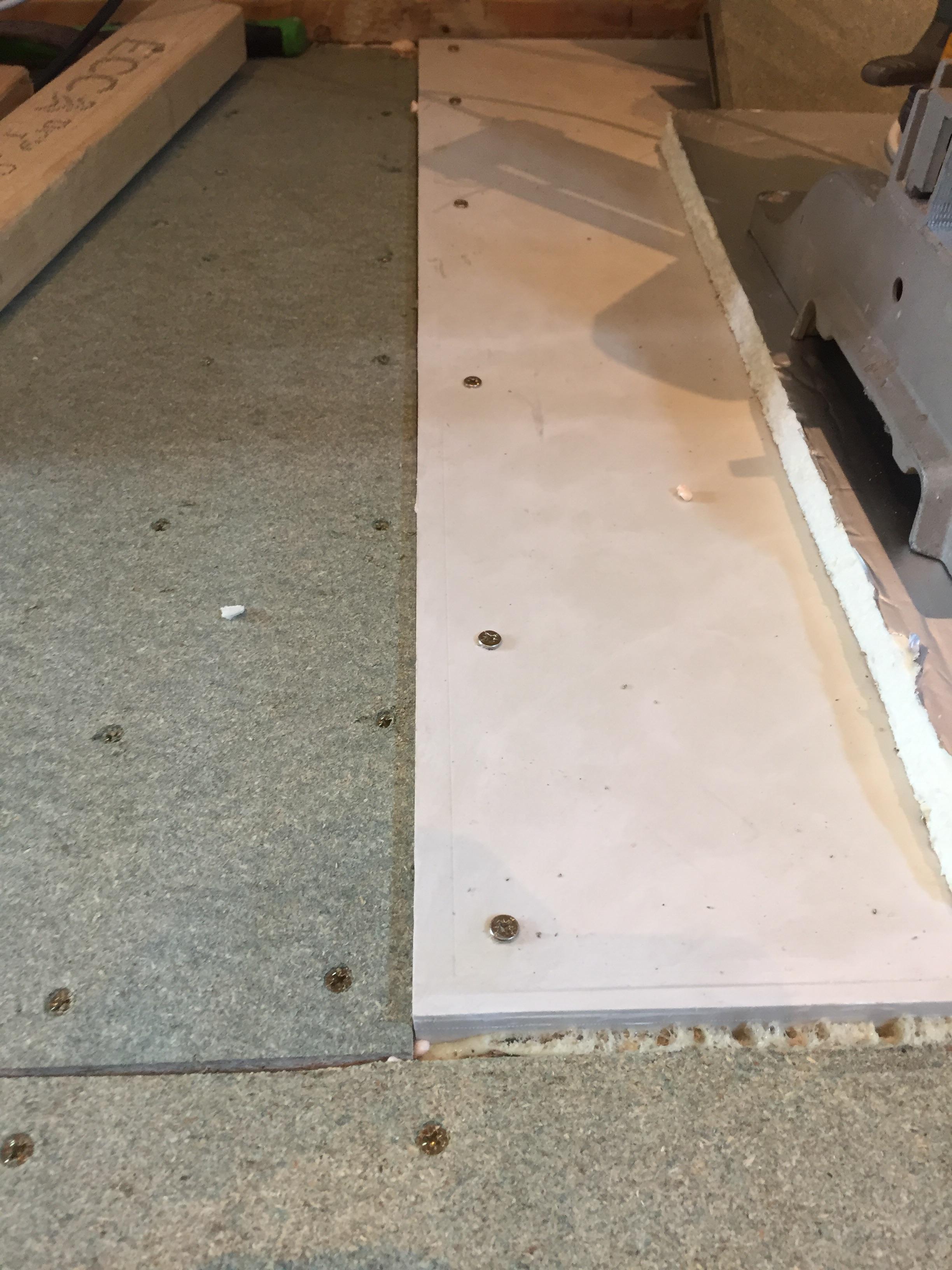

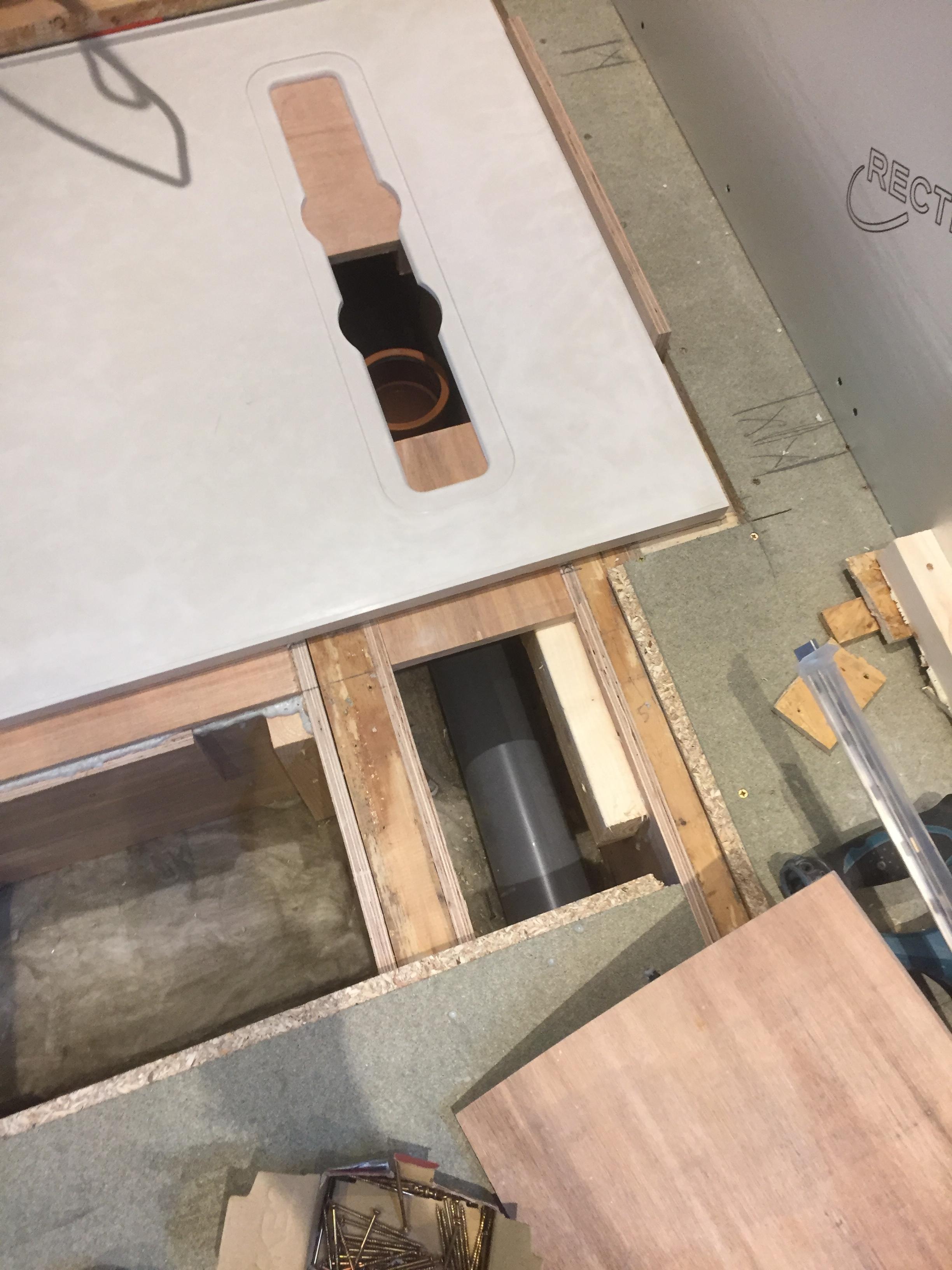

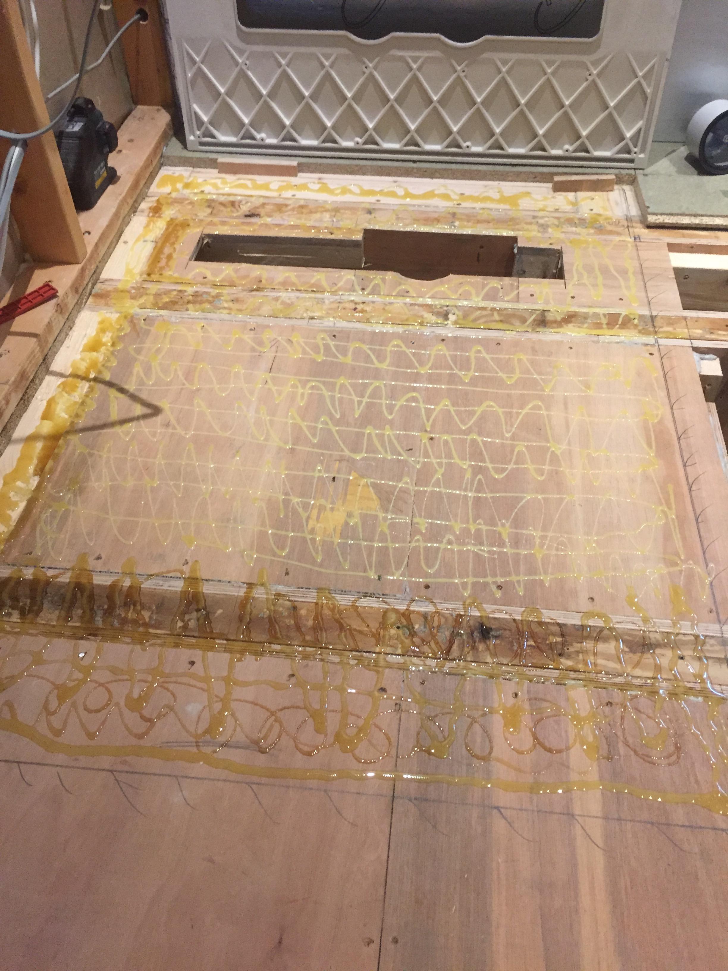

Nickfromwales Posted July 7, 2017 Posted July 7, 2017 Current job has existing 22mm P5. As it's got ( rather poorly fitted ) I-beams at 600mm centre I've decided to use 22mm P5 plus 9mm ply as the binder. Pic of former sat on the floor so I could mark the plywood support sections to cut out the linear waste footprint. Pic of the local support plywood. The 40x40mm battens were used to fit engineered, full depth noggins out of 18mm ply ( made by me bespoke to suit ) as the original builders thought that noggins were unnecessary Pic of the PU glue which I smothered everything with prior to fitting a tray sized piece of 9mm ply down and screwing on 100mm centres. Then the tray went down with Sikaflex EBT and screwed through the pre marked fixing locations on the tray. Zoom in and you'll see the circles where you drill through the grp to create screw holes. A pic of the tray 9mm proud of the new P5 floor, which will be ply'd next to create a flush floor. The screws hold the tray down whilst the SFlex goes off, then one at a time I'll remove each screw, countersink it, pump the hole full of SFlex and send the screw back in snug, not too tight.
Nickfromwales Posted July 7, 2017 Posted July 7, 2017 Oh, and the holes in the tray get covered by the Impey membrane supplied in the matching tanking kit.
