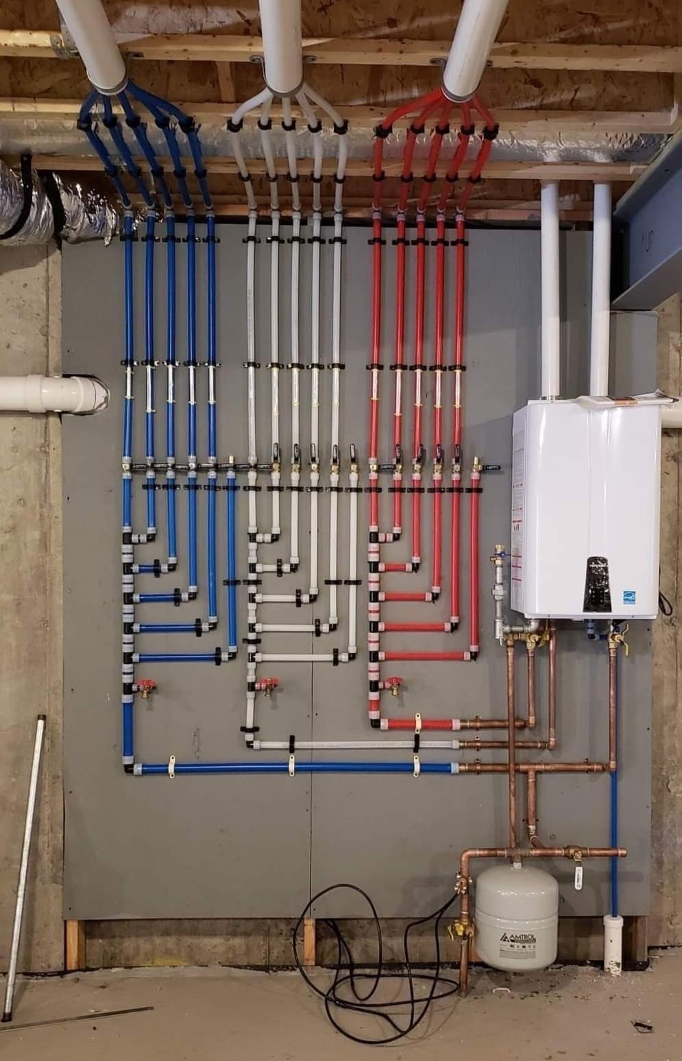

Pocster Posted December 16, 2022 Share Posted December 16, 2022 @Onoff decided to re do my ufh pipework etc . Link to comment Share on other sites More sharing options...
Onoff Posted December 16, 2022 Share Posted December 16, 2022 2 hours ago, pocster said: @Onoff decided to re do my ufh pipework etc . Amazing, my nephew sent me that exact photo on WhatsApp the other week as an example of good plumbing. He has a sore bum too apparently. Didn't know he'd been to Bristol recently. 1 Link to comment Share on other sites More sharing options...
Pocster Posted December 16, 2022 Share Posted December 16, 2022 Just now, Onoff said: Amazing, my nephew sent me that exact photo on WhatsApp the other week as an example of good plumbing. He has a sore bum too apparently. Didn't know he'd been to Bristol recently. Sorry about that . We got both plumbing sorted 👍 Link to comment Share on other sites More sharing options...

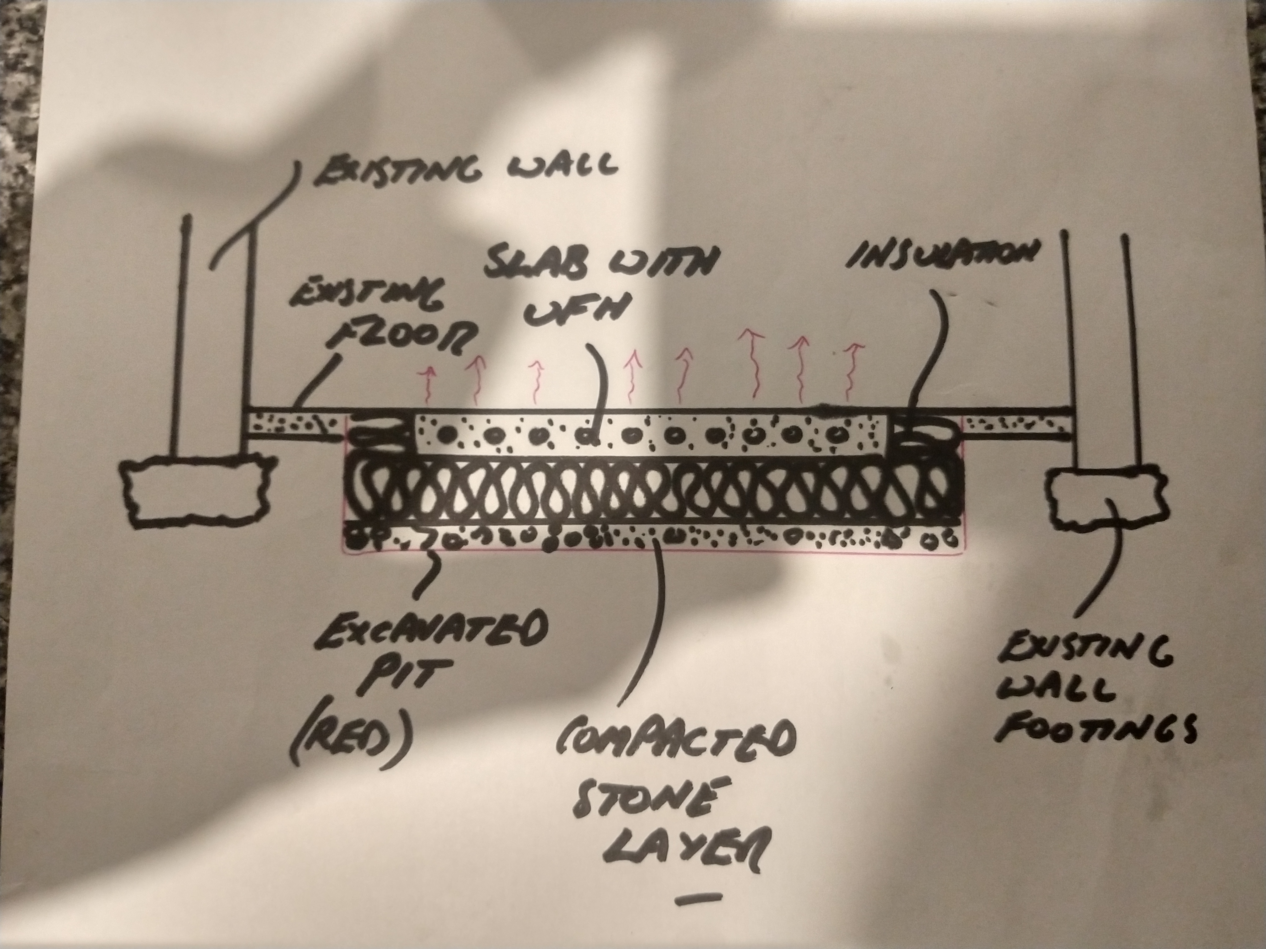

Onoff Posted December 17, 2022 Share Posted December 17, 2022 A dog rough, fag packet sketch of what I suggested above. This is one method I've considered with my kitchen. It saves taking the kitchen units down to dig up and you really don't want heat going up into food storage cupboards or the fridge freezer anyway. It does of course mean you still have an insulated room perimeter. Another concern I had was that this might shift/settle over time and there'd be a noticeable "joint" between old an new floor sections. I imagine you would put a mesh or similar down before tiling the whole lot. I wouldn't do this in the lounge I don't think as we have furniture around the perimeter and I'd want heat coming up under that. Might be a moot point for me as really the whole kitchen floor is too high and wants lowering to match the rest of the house. This and the step up will become an issue for us in later life if we become semi immobile when older or wheelchair users. Hopefully we'll have frozen to death / been eaten by rats before then... Link to comment Share on other sites More sharing options...
zoothorn Posted December 22, 2022 Author Share Posted December 22, 2022 @Onoff cheers for the fag sketch.. gets me into gear 1 to be honest. I still think I should get my builder in to excavate: he might well do the cautious approach & start inward of the edge & 45* sloping down into an excavated area. It's too much of a risk for me alone, & as insurance will be involved should he take the job on: & I can make 100% sure beforehand to check all this insurance aspect, before agreeing. This means I can't afford to crack on with the job now then, alas: I need to get a quote & consider the whole hightened cost. It might mean it's out of my budget. We'll see what his quote is. Thanks, zoot Link to comment Share on other sites More sharing options...

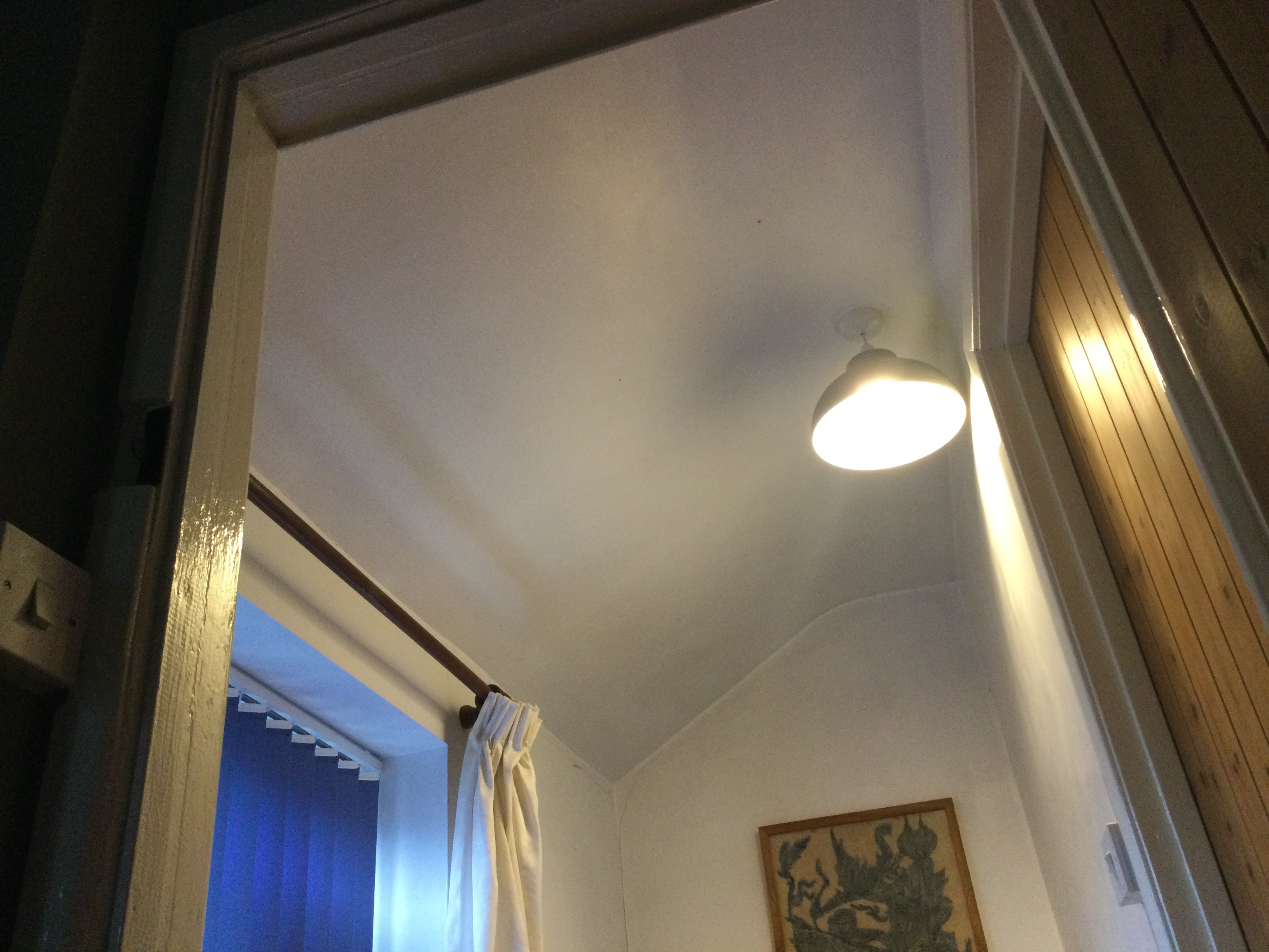

zoothorn Posted December 22, 2022 Author Share Posted December 22, 2022 Chaps, this new cautious approach ( builder do excavating/ quote needed/ job on hold).. means I'm back considering all aspects of where the cold might be entering the room. And whether I can do anything about it, prior to considering this massive (for me) step of excavation which would be a huge upheaval, let alone cost, duration etc. Did some detective work, & one area I'd not previously thought of, has come to mind with regard to a (possible) huge area of cold ingress to this mainroom. I can feel cold pouring down the stairwell. No doubt at all. Ok this could be from a,b,c,d places collectively together, or, one hugely dominating. If I close my upstairs bedroom doors.. I recently realised.. a bit less cold pours down. A bit. Suggesting the majority is -still- entering down stairwell from 1st floor though. So I look suspiciously at my sloped ceiling area of my stairwell area, high up. I go in loft, to see what insulation is stuffed down this slope. I can't see behind a big 9" joist. This blocks sight, & seems to block any access between the plasterboard sloping down behind it.. &.. the roof only 8" or so away. SO. It seems to me, like the stairwell plasterboard sloped ceiling, has no insulation behind it. And the roof only a little above it here. = a freezing cold ceiling area. This sloped side section, being about 2/3rds area of the stairwell ceiling. SURELY this cold source is the main culprit of the -stairwell- cold. But access to it.. to stuff even orange fluff down... is n/a. I'll add photos. Zoot Link to comment Share on other sites More sharing options...
zoothorn Posted December 22, 2022 Author Share Posted December 22, 2022 Where the trained housefly is, LHS of light, is where the joist beam is situated. It runs down length of house (front of shot to back of shot), at the point where the ceiling curves down. So this side 45* angled ceiling area.. is more than 2/3rds, it's the vast majority of the stairwell ceiling in fact. The roof felt above it here, being only 6" away. The gap between the pB ceiling & roof felt, within each section rafter to rafer.. I would imagine.. is a void containing no insulation at all. Zoot Link to comment Share on other sites More sharing options...

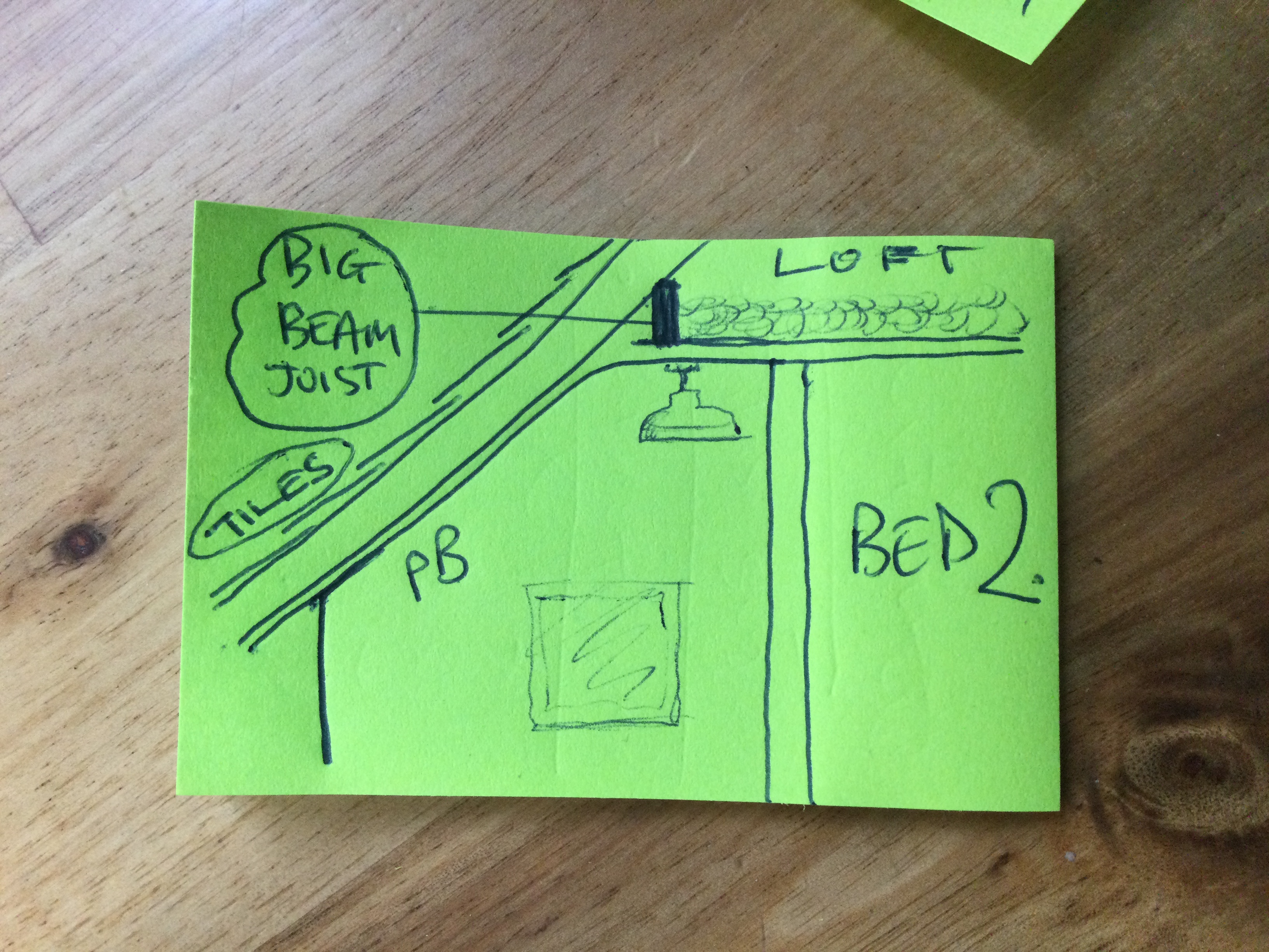

zoothorn Posted December 22, 2022 Author Share Posted December 22, 2022 Sketch of this area.. Link to comment Share on other sites More sharing options...
TonyT Posted December 22, 2022 Share Posted December 22, 2022 23 minutes ago, zoothorn said: Where the trained housefly is, LHS of light, is where the joist beam is situated. It runs down length of house (front of shot to back of shot), at the point where the ceiling curves down. So this side 45* angled ceiling area.. is more than 2/3rds, it's the vast majority of the stairwell ceiling in fact. The roof felt above it here, being only 6" away. The gap between the pB ceiling & roof felt, within each section rafter to rafer.. I would imagine.. is a void containing no insulation at all. Zoot Depends if you want to pull ceiling down and insulate between rafters, reinstall plasterboard, plaster/tape or fix insulated plasterboard direct to ceiling, then plaster/tape. Link to comment Share on other sites More sharing options...
zoothorn Posted December 22, 2022 Author Share Posted December 22, 2022 24 minutes ago, TonyT said: Depends if you want to pull ceiling down and insulate between rafters, reinstall plasterboard, plaster/tape or fix insulated plasterboard direct to ceiling, then plaster/tape. Hi TT, ok so the redoing the pB, was one thing that occured to me too as a "possible" action to take. So you've confirmed this idea had validity. Ok that's helpful. As to me choosing between this (A) & the adding-insulation-to-existing-ceiling idea (B), I have no way of knowing. As I have no experience. I can only then guess, that (B) is potentially easier, & (A) is possibly trickier but would be the better option. But Im just guessing, as I have no experience. Link to comment Share on other sites More sharing options...

TonyT Posted December 22, 2022 Share Posted December 22, 2022 me, I would sheet over the existing, less grief and mess if the roof layout can take the reduction of approx 112mm. if not pull the ceiling down. I hate messing about with roofs Link to comment Share on other sites More sharing options...
PeterW Posted December 22, 2022 Share Posted December 22, 2022 1 hour ago, Onoff said: Would it be less mess to take the tiles off and insulate from outside? No. depending on what’s under the slate / tiles then it could become a nightmare. I would bond on PIR backed plasterboard and then screw through it and tape the joints and be done with it Link to comment Share on other sites More sharing options...

zoothorn Posted December 22, 2022 Author Share Posted December 22, 2022 53 minutes ago, PeterW said: No. depending on what’s under the slate / tiles then it could become a nightmare. I would bond on PIR backed plasterboard and then screw through it and tape the joints and be done with it Hi Peter, understand.. but how much PIR would you say minimum though doing this? It's a smallish cottage you see, every inch of room counts type thing. Link to comment Share on other sites More sharing options...
