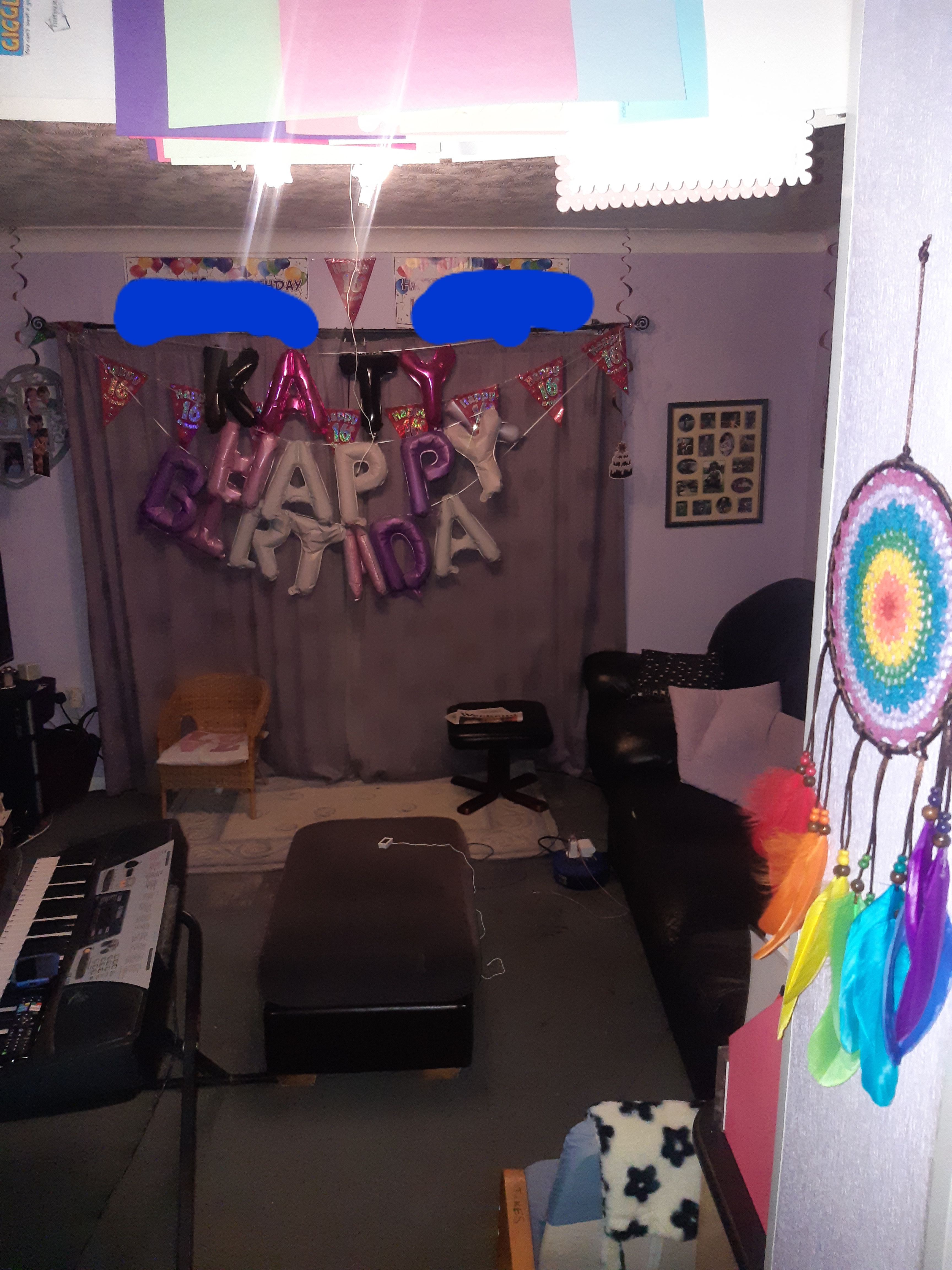

Onoff Posted December 14, 2022 Share Posted December 14, 2022 (edited) Here you go @zoothorn, my lounge. Suspended timber floor, clay air bricks open to the elements. I've hung a thermometer from the light fitting with the probe midway between floor and ceiling. Just in front of the second "P" in HAPPY. Temperature is reading 20.5degC. Then there's another on the pouffe with the probe on the floor. That is reading 13.4degC. So one probe directly below the other. No wonder our feet are freezing! Edited December 14, 2022 by Onoff 1 Link to comment Share on other sites More sharing options...
