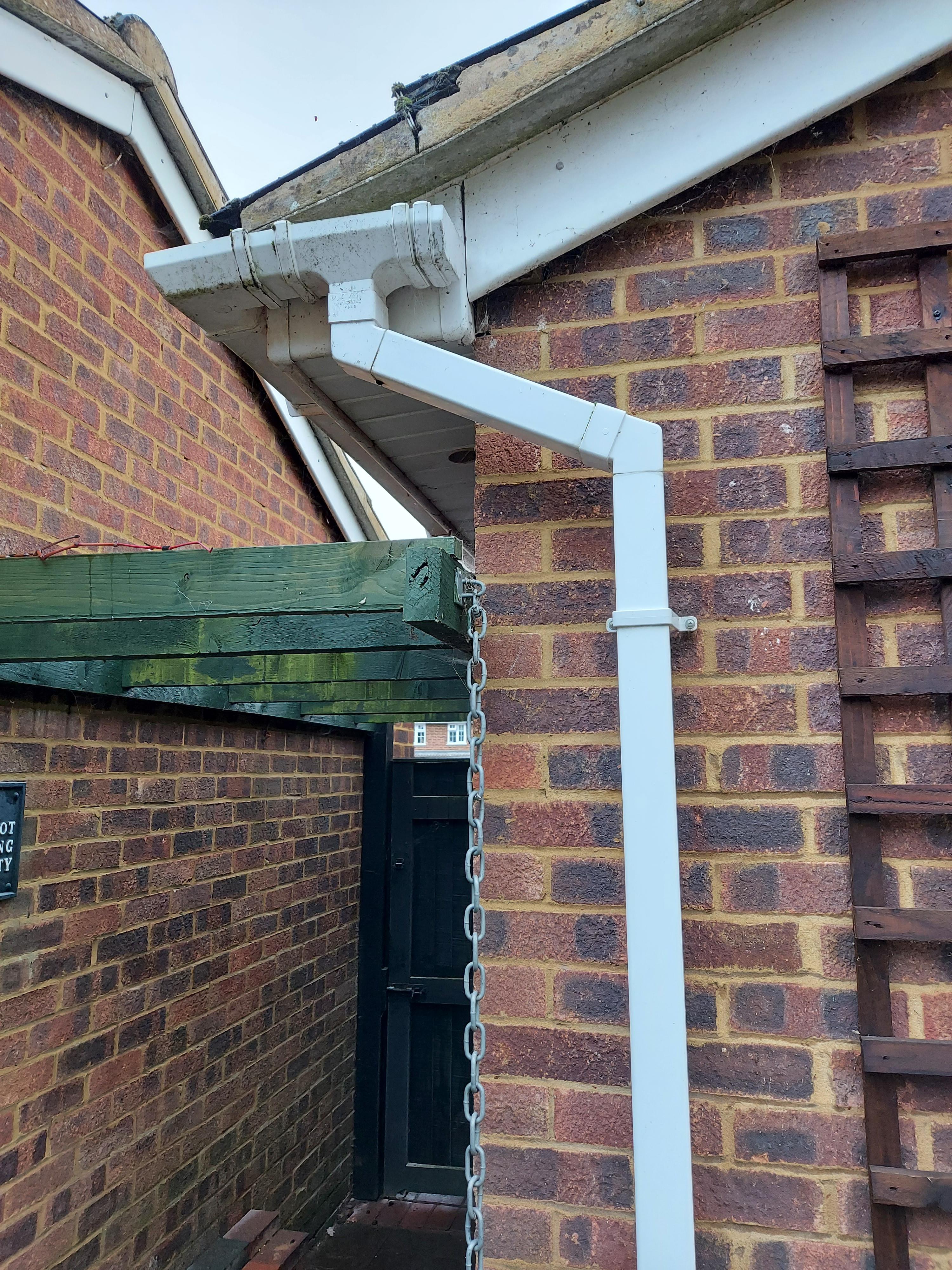

JAG Posted December 5, 2022 Author Share Posted December 5, 2022 Link to comment Share on other sites More sharing options...
Radian Posted December 5, 2022 Share Posted December 5, 2022 Is that a rain-chain? Link to comment Share on other sites More sharing options...
Conor Posted December 5, 2022 Share Posted December 5, 2022 (edited) Start by digging out all the mud and replacing it with clean stone. And what is the down pipe draining in to? A gully or just the ground? Edited December 5, 2022 by Conor Link to comment Share on other sites More sharing options...
saveasteading Posted December 5, 2022 Share Posted December 5, 2022 My immediate thought too. Never a great idea. JAG good pic. Can we have another showing up to the gutter, and another the other direction. Link to comment Share on other sites More sharing options...

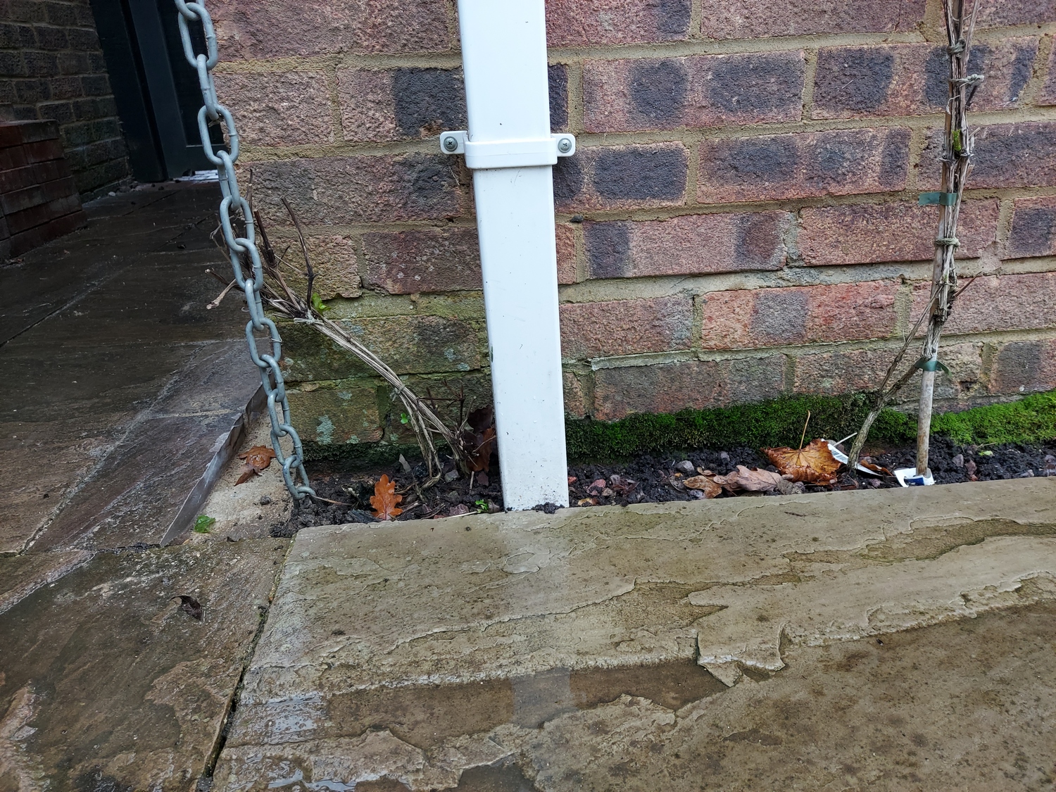

JAG Posted December 5, 2022 Author Share Posted December 5, 2022 This is a photograph of the corner - for some reason printed twice. It was taken this morning after a couple of hours gentle rain and you can clearly see that the wetness of the green mold has already crept along. You can also see the DPC but the water ingress is above this. The downpipe goes to a soakaway but this is clear - and the chain is just decoration. To the left you will see a channel I cut in the paving in the hope of finding an open hole but no luck. Link to comment Share on other sites More sharing options...

markc Posted December 5, 2022 Share Posted December 5, 2022 Where is the DPC? I can’t see it. And/or where is internal floor level compared to the outside Link to comment Share on other sites More sharing options...

ProDave Posted December 5, 2022 Share Posted December 5, 2022 The path along the side looks to be less than the recommended 150mm lower than the DPC so you will be getting some rain splashing on the wall above DPC level. Link to comment Share on other sites More sharing options...

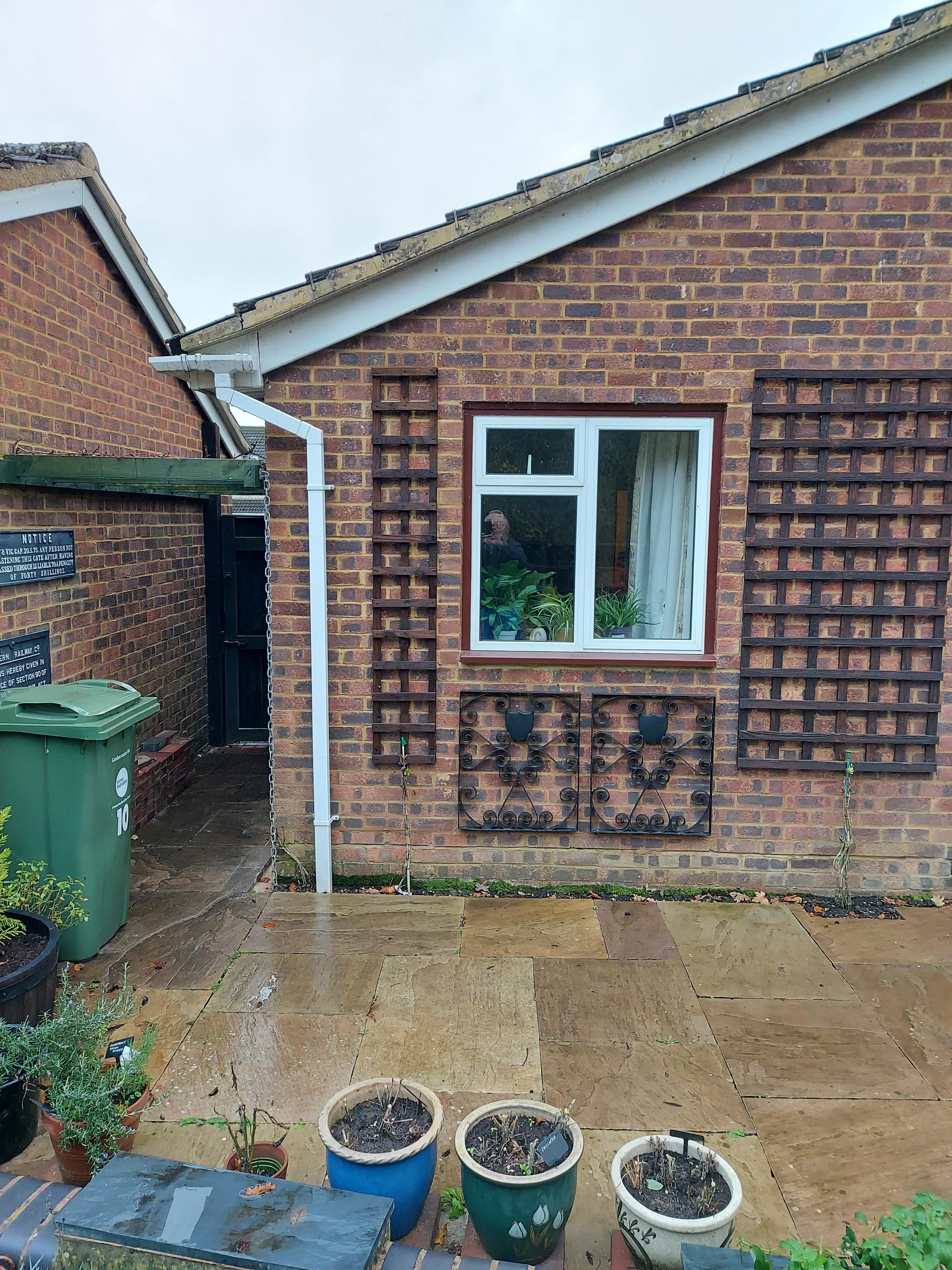

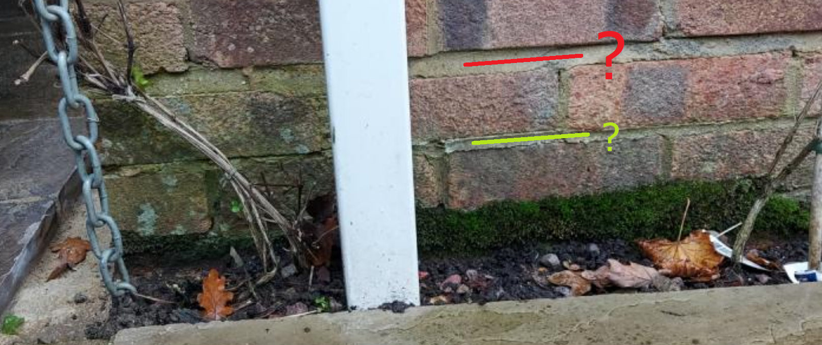

JAG Posted December 5, 2022 Author Share Posted December 5, 2022 This is the overall picture of the left corner. You can see how far the damp has crept in just a couple of hours in a morning. There is a DPC about two bricks up from ground. Link to comment Share on other sites More sharing options...
Radian Posted December 5, 2022 Share Posted December 5, 2022 Which of these is where the DPC is? I'm guessing the red line: Link to comment Share on other sites More sharing options...
saveasteading Posted December 5, 2022 Share Posted December 5, 2022 To avoid jumping to conclusions, More questions. Where inside the house is the worst of the damp? relative to this picture. I don't see a change jn the dampness between the pictures. Where and how far has the dampness increased today? Does the trench at the bottom ever fill with water? Any bricklaying experts there? the wider mortar course seems very wide to me, even if it includes dpc. Is it normal to have such a thick joint, and also to point over the dpc? I wonder if this bed has been removed and redone, as the trowel work is pretty shabby, as are several joints below dpc. JAG, as an intermediate remedy, can you divert the downpipe to flow onto the garden? If the paving runs down from the house then that will do it. If the paving runs towards the house then that is something else we need to know. Link to comment Share on other sites More sharing options...
