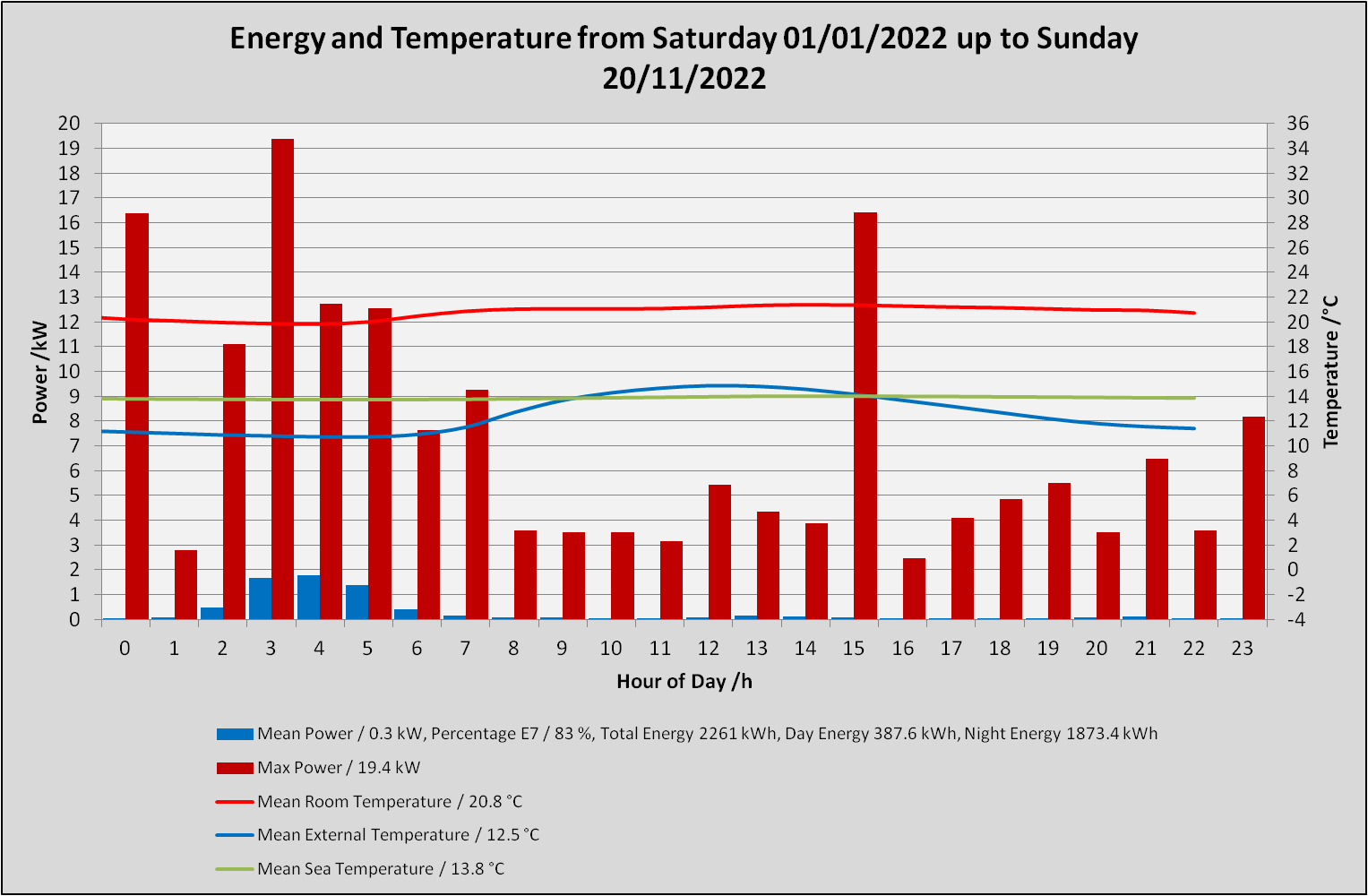

LaCurandera Posted November 29, 2022 Share Posted November 29, 2022 Hi, This might be a REALLY stupid question, but I've always lived in houses that were (relatively) much cooler at night, warmed in the day through heating/solar gain. Going to a hotel etc and having a 19/20C temp in the room overnight has affected sleep, preferring it cooler. Our scheme is probably not passive, but it's planned on being better insulated and thought about than any house I've stayed in, so I was wonder if those that have moved from a traditional house to one with much more stable temps and how it's affected them / time to adjust. Has anyone got graphs of their house temp over a 24hr cycle at different points in the year? As, I guess it's stupid to open windows to cool overnight, defeats the object! Link to comment Share on other sites More sharing options...

SteamyTea Posted November 29, 2022 Share Posted November 29, 2022 1 hour ago, LaCurandera said: Has anyone got graphs of their house temp over a 24hr cycle at different points in the year? Yes, but not sure it will help much as it is my house, not yours. Do you have trouble sleeping usually, have you thought of a cheap sleep monitor, it may show that you don't actually have a problem. Follow the red line. Scale is on the right. Link to comment Share on other sites More sharing options...
LaCurandera Posted December 1, 2022 Author Share Posted December 1, 2022 Thanks @SteamyTea! Link to comment Share on other sites More sharing options...
