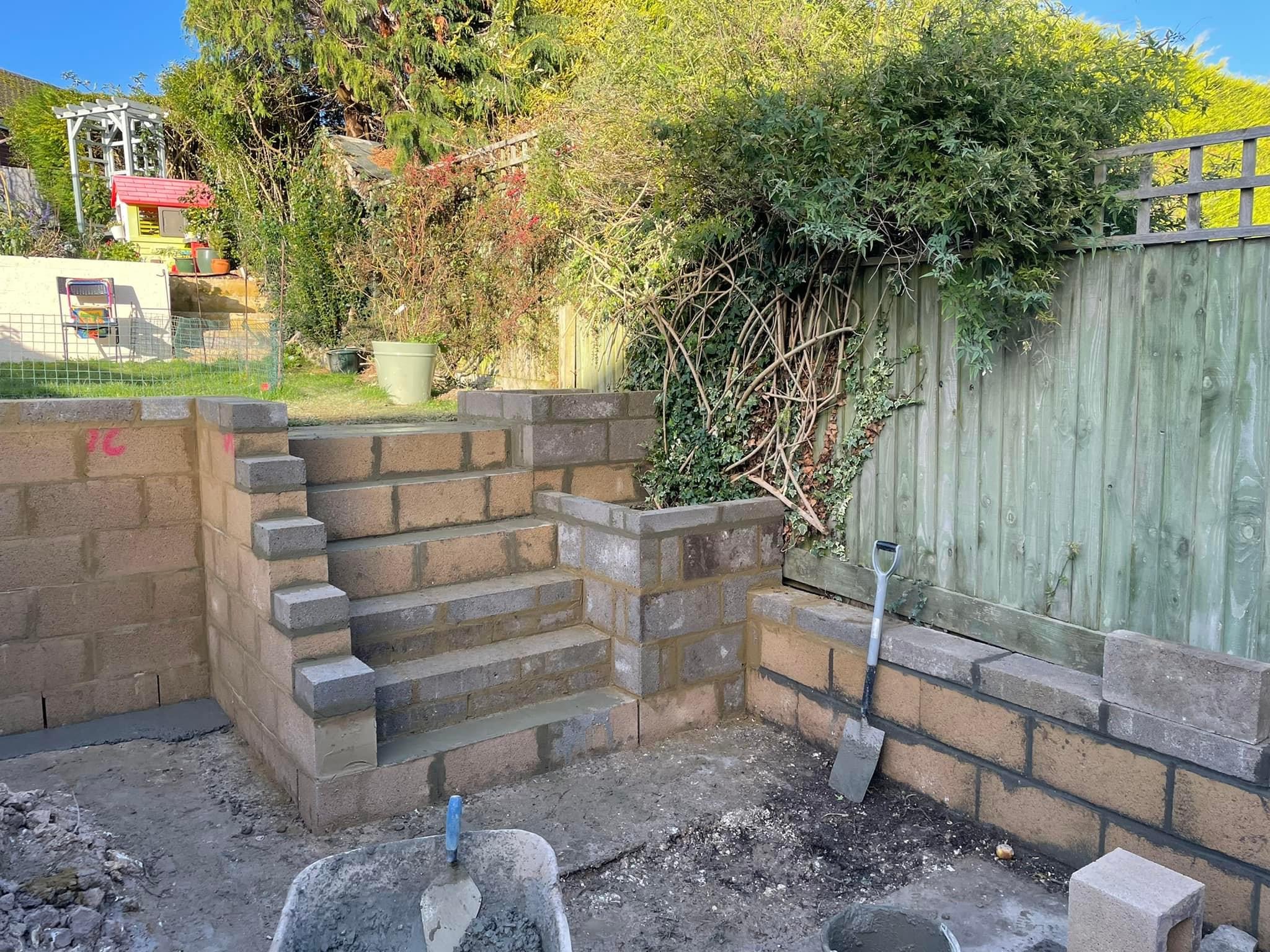

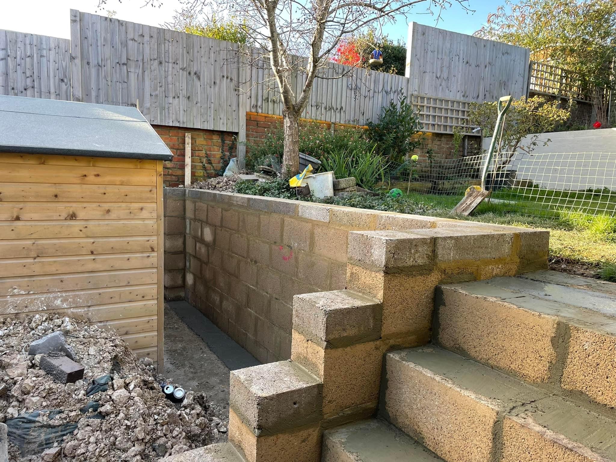

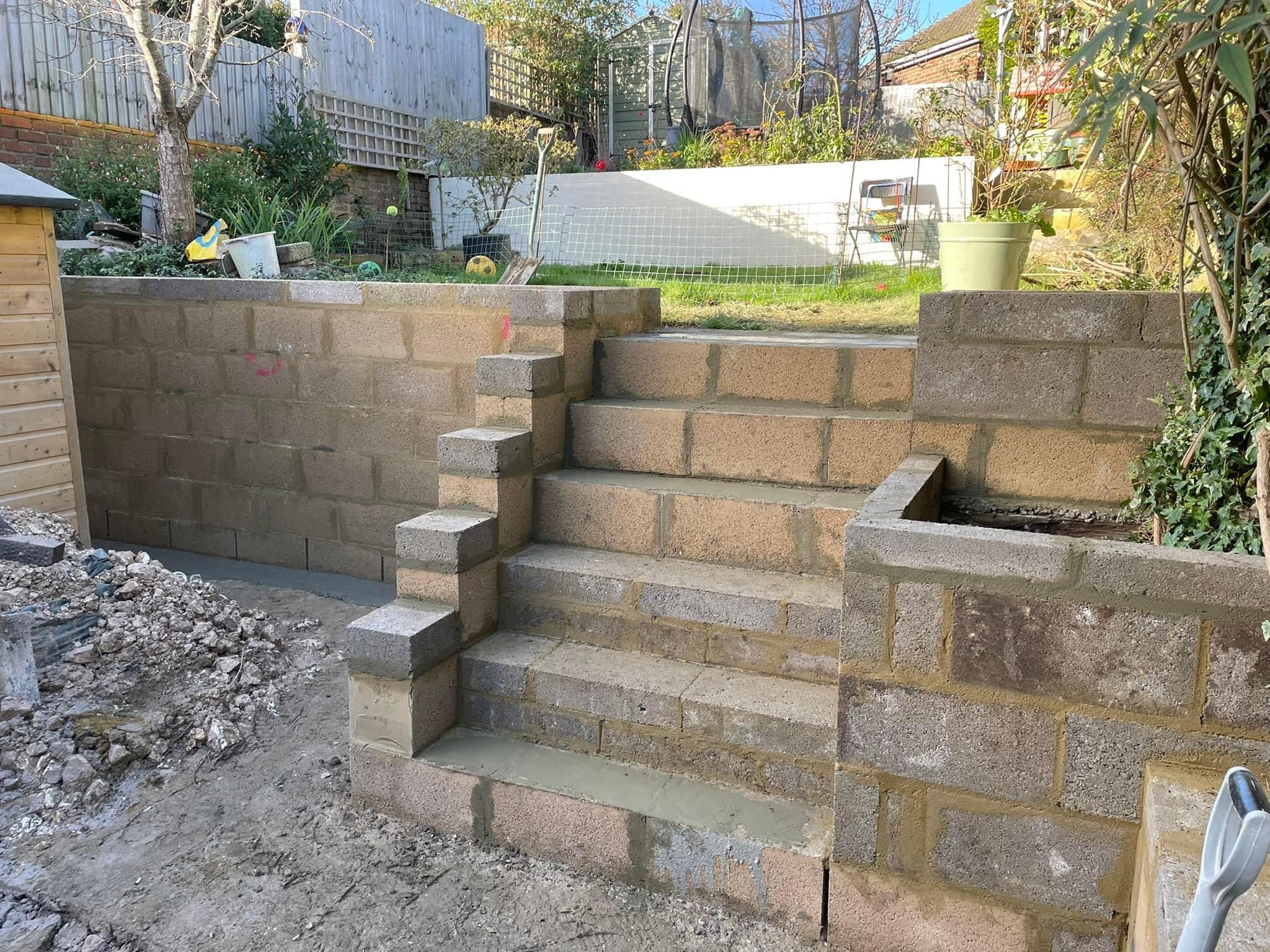

OllyIB Posted November 28, 2022 Author Share Posted November 28, 2022 Good shout, should have though of that! Photos attached, I’ll also be laying a patio so the walls and steps will be topped to match the patio. Not a small area and lots of angles so should be a steep learning curve! Link to comment Share on other sites More sharing options...
Gus Potter Posted November 28, 2022 Share Posted November 28, 2022 (edited) Hey that looks ok.. seen a lot worse.. looks like you have something to work with here. Firstly the perpendicular joints at the bottom.. are they open and do you know how the wall is drained at the back? You'll get loads of folk chipping in on BH.. the more photos you post the more info / suggestions you'll get. The length of the wall looks ok in terms of retaining the soil as it has some good returns to brace it. If you want to finish it yourself I would start with the steps. What do you want to put on top? Could be slabs or at the high end a porcelain tile? Next is the risers to the steps.. how do you want to finish that? Then the copes at the side of the steps any thoughts? Is BC involved? Do you need a hand rail as the change in level is more than 600mm? Once you have nutted that out then turn to the render... that is the last bit. Any copes need a good drip so they need to be at least 40mm wider than the wall on each side.. after any render. I'm sure @nod will pitch up with the best solution. Main thing here is to sort the drainage behind the wall so you don't get frost blowing off the render. Once you have nutted out this then yes you could render it yourself.. but it takes a bit of practice so it may be that when you look at all the other bits it's worth getting someone else in to make it all a top job.. the money lies in finishing the steps and the copes / maybe hand rail. I think that is where you could learn to do it yourself and save the money.. one step at a time.. where as rendering.. you only get one go! Edited November 28, 2022 by Gus Potter Link to comment Share on other sites More sharing options...

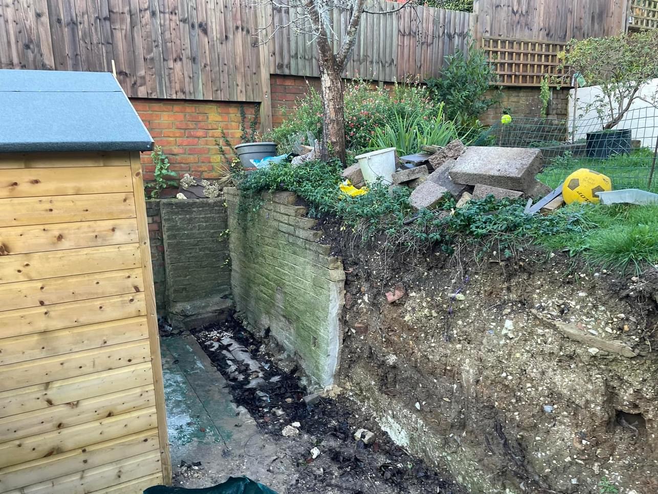

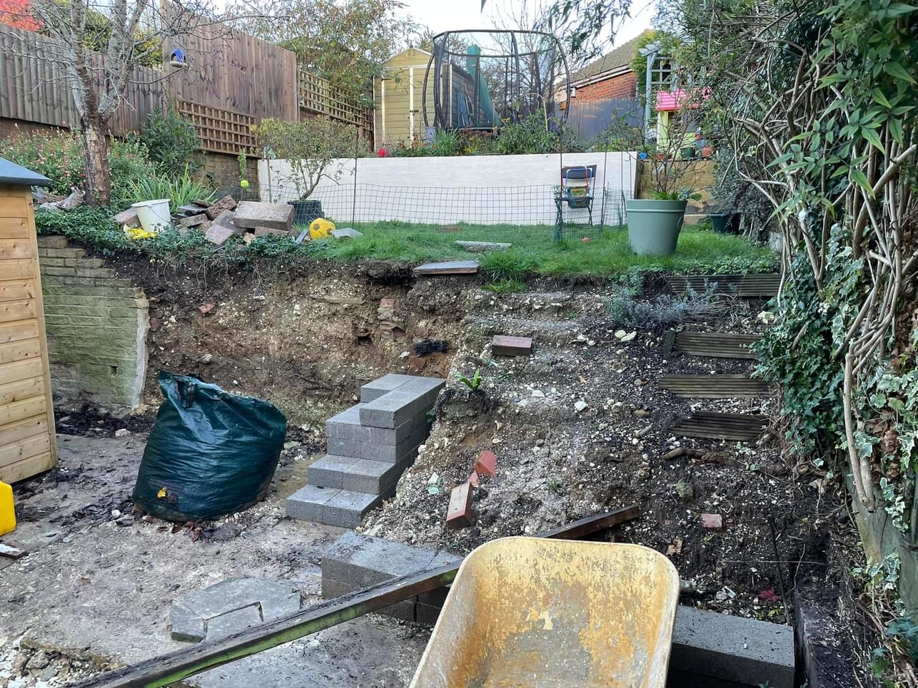

OllyIB Posted November 28, 2022 Author Share Posted November 28, 2022 Thank you for such a great response The guys we got in to do the wall and steps have done a great job (have included photos of how it had been left by the cowboys we had in the first time). It’s hollow block with rebar and filled with concrete so unlikely to go anywhere! The joints at the bottom are open for drainage, there is a gap at the back that has been backfilled with rubble and gravel for drainage. Not sure on BC, not an acronym I’ve come across. However, we will need to add a hand rail and something along the top of the wall as it’s over a metre drop and we want to keep the kids and puppy safe. For the steps the plan was to use porcelain on the tops, doing the same on the wall tops. Ideally I’d like to render the risers but am aware this could be a fiddly job, especially for a beginner, so backup would be to use porcelain on the risers as well. From what I’ve read it seems it’s best to render before laying the patio, although don’t know if the steps/copes need to be done first or if I can just use a straight edge/feather board to get the render right. Would love to be able to get someone in to do the job but quotes have been £900-1200 and we just don’t have that at the moment 😢 Link to comment Share on other sites More sharing options...

Conor Posted November 29, 2022 Share Posted November 29, 2022 Second to the painting option above. Is there a drainage system/gravel/membrane behind the new wall? I see gaps in the bottom row of blocks which should do the job. If not, the wall will be permanently damp and whatever you face it with will degrade over time. Link to comment Share on other sites More sharing options...
Jenki Posted November 29, 2022 Share Posted November 29, 2022 (edited) My biggest concern would be what is at the back of the walls. Is there any tanking / damp proof membrane between the soil and the new block? If not, then the blocks will soak up the moisture and WILL come through to the front. If you render, then as @ProDave , suggests the render will pop off or at least blister before failing. If above could be an issuer, you could consider securing fence panels to the walls? or cladding. Steps could be paving / tiles. Edited November 29, 2022 by Jenki Link to comment Share on other sites More sharing options...
OllyIB Posted November 29, 2022 Author Share Posted November 29, 2022 2 hours ago, Jenki said: My biggest concern would be what is at the back of the walls. Is there any tanking / damp proof membrane between the soil and the new block? If not, then the blocks will soak up the moisture and WILL come through to the front. If you render, then as @ProDave , suggests the render will pop off or at least blister before failing. If above could be an issuer, you could consider securing fence panels to the walls? or cladding. Steps could be paving / tiles. There is a void behind the main wall that has been filled with rubble and gravel to allow drainage. The smaller wall at the side has next doors patio on the other side with a small amount of soil at one end from a border. There is no membrane but hopefully what has been done will avoid the walls getting too damp. 1 Link to comment Share on other sites More sharing options...
