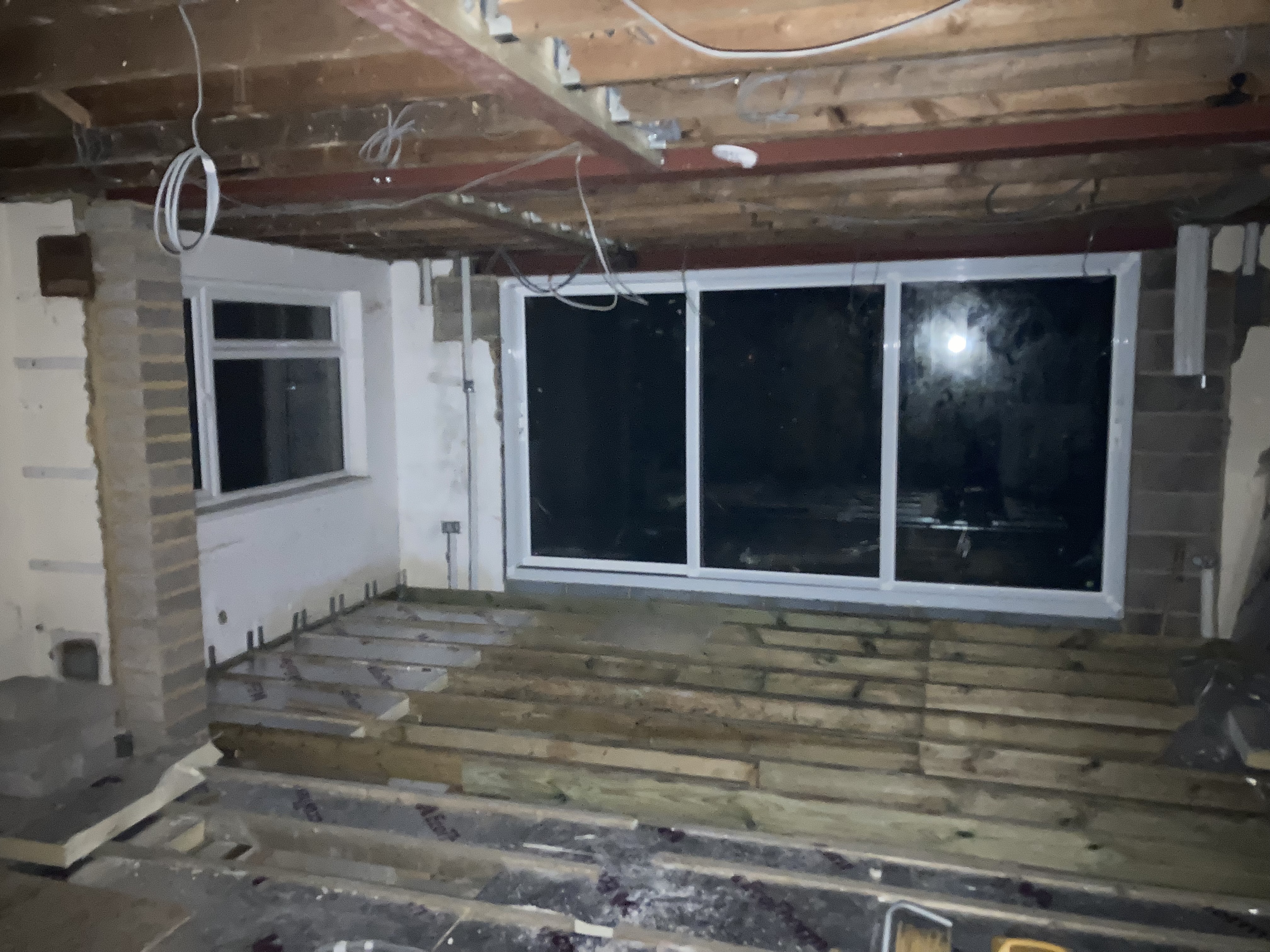

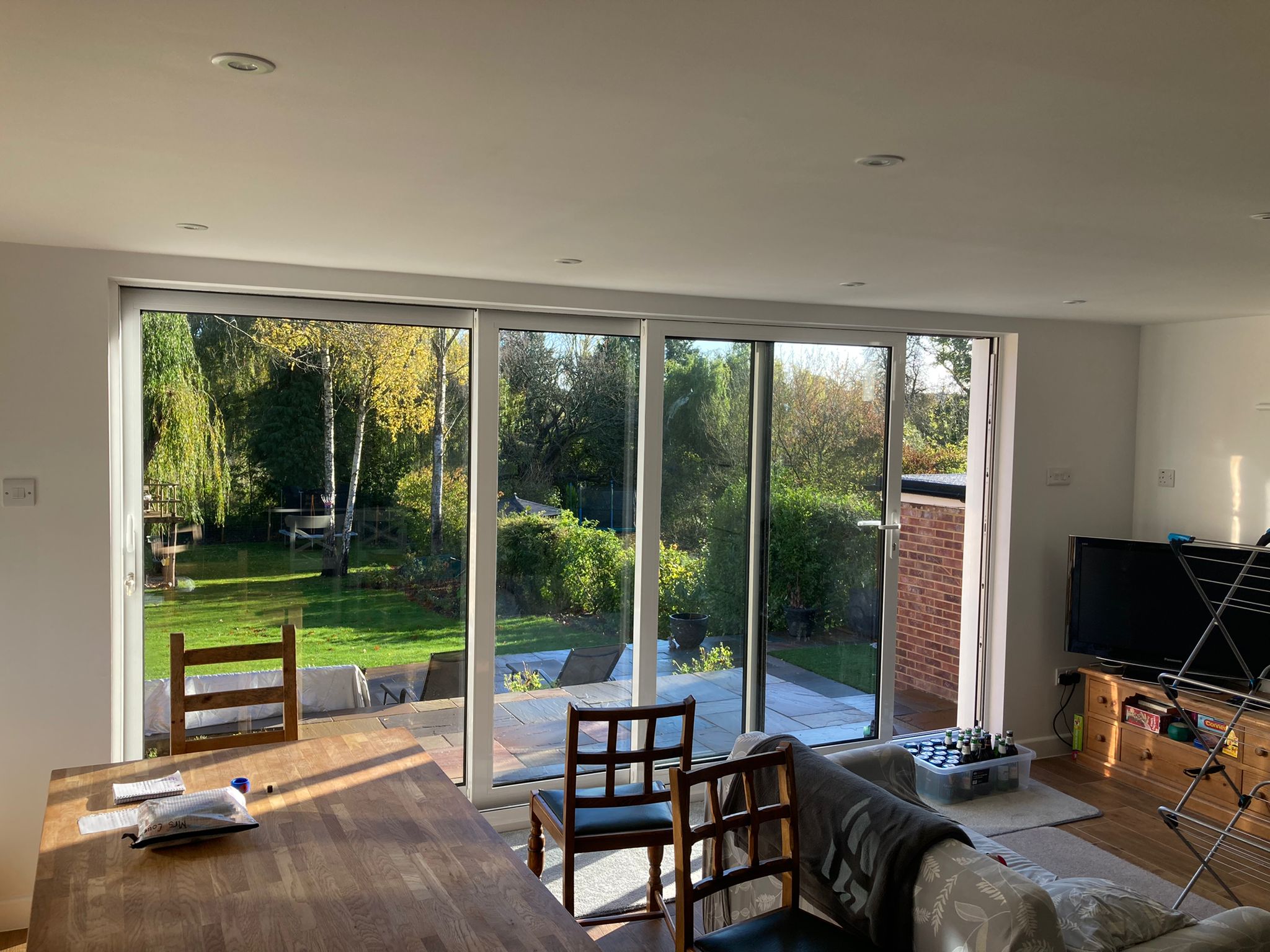

sirpatchuk Posted November 28, 2022 Author Share Posted November 28, 2022 @Radian you are talking me into it… just the worry! we also have these big patio doors which we didn’t plan on getting curtains for but guessing this is a big heat loss? It’s an east face garden. Link to comment Share on other sites More sharing options...
SteamyTea Posted November 28, 2022 Share Posted November 28, 2022 13 minutes ago, sirpatchuk said: we didn’t plan on getting curtains Get curtains. While there may be some solar gain in the winter mornings, it is the colder side of the house, especially if an easterly blows in at night. Link to comment Share on other sites More sharing options...

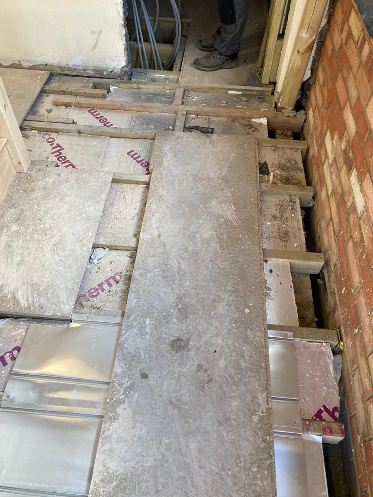

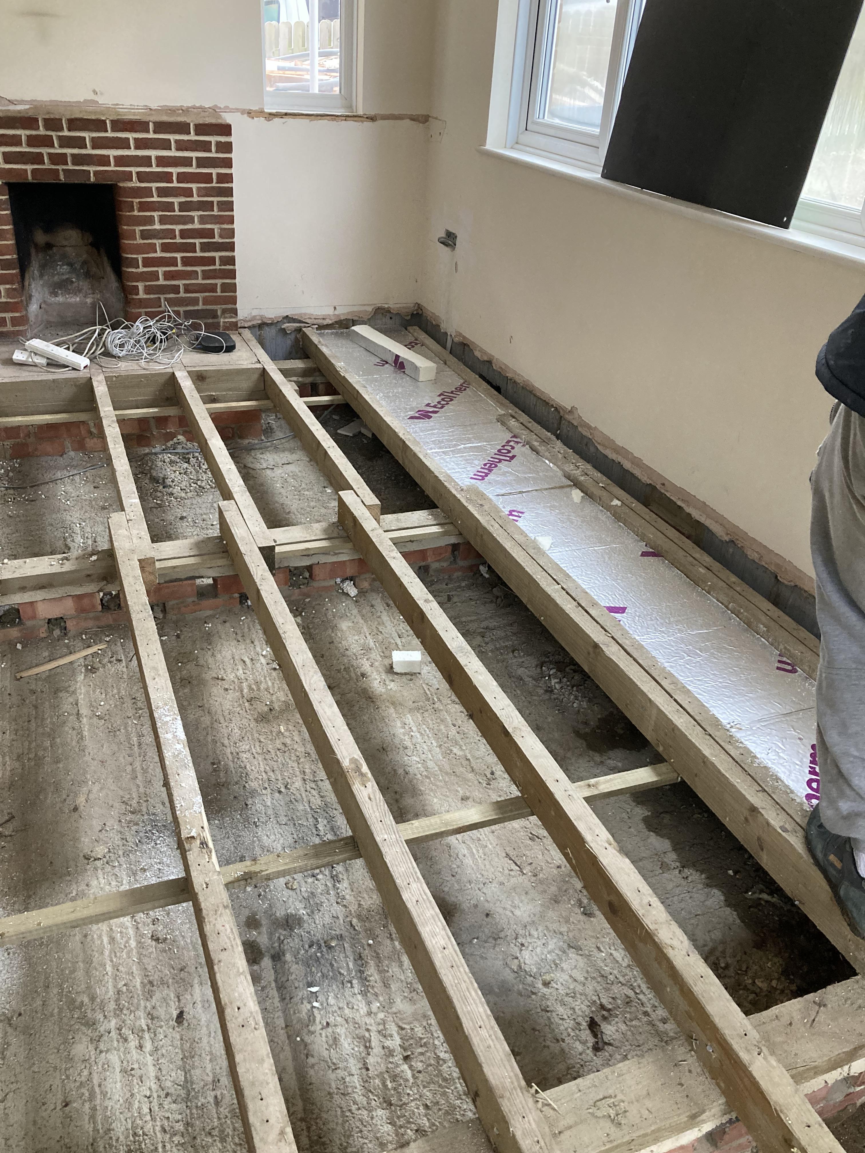

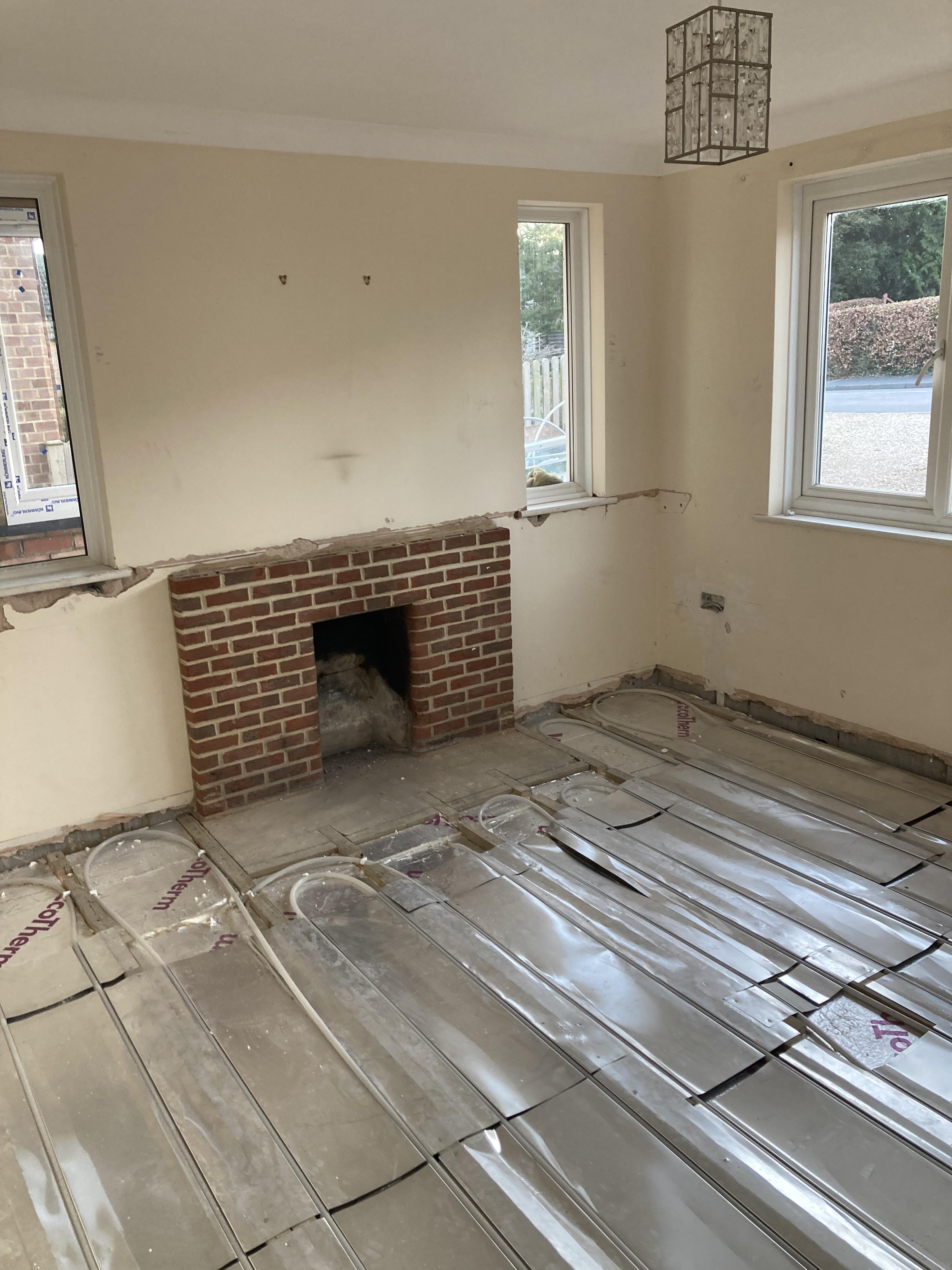

HughF Posted November 28, 2022 Share Posted November 28, 2022 It’s highly likely that your Grant ashp has been installed with too many zones and on/off thermostats. The Grant (Chofu) controller is quite good, but grant decide to try and make it as easy to install as an oil boiler, so fit it with on/off controls that cripple the COP. Ideally you’d have the WC setup for the rads, and a separate WC’d Esbe valve (with associated Esbe controller) on the UFH manifold. Your UFH, did you say that was a spreader plate system? Any photo’s of how well (or badly) it was installed? Link to comment Share on other sites More sharing options...
sirpatchuk Posted November 28, 2022 Author Share Posted November 28, 2022 20 minutes ago, HughF said: It’s highly likely that your Grant ashp has been installed with too many zones and on/off thermostats. The Grant (Chofu) controller is quite good, but grant decide to try and make it as easy to install as an oil boiler, so fit it with on/off controls that cripple the COP. Ideally you’d have the WC setup for the rads, and a separate WC’d Esbe valve (with associated Esbe controller) on the UFH manifold. Your UFH, did you say that was a spreader plate system? Any photo’s of how well (or badly) it was installed? hi, this is probably the only photo I have which will give some idea Link to comment Share on other sites More sharing options...
HughF Posted November 29, 2022 Share Posted November 29, 2022 Quality workmanship there 🤦♂️ Link to comment Share on other sites More sharing options...
ProDave Posted November 29, 2022 Share Posted November 29, 2022 11 hours ago, sirpatchuk said: hi, this is probably the only photo I have which will give some idea Yes sorry to say that is not good. The ends are open to the cold under floor space, and that means the cold air can get between the spreader plates and the insulation. Your insulation will be a lot less effective than it should be because of that and you will waste a lot of heat, lost to the under floor void. We keep on about attention to detail being necessary for good performance, and that is sadly a good example of how performance has been degraded by a basic lack of understanding or just plain can't be bothered. Link to comment Share on other sites More sharing options...
sirpatchuk Posted November 29, 2022 Author Share Posted November 29, 2022 32 minutes ago, ProDave said: Yes sorry to say that is not good. The ends are open to the cold under floor space, and that means the cold air can get between the spreader plates and the insulation. Your insulation will be a lot less effective than it should be because of that and you will waste a lot of heat, lost to the under floor void. We keep on about attention to detail being necessary for good performance, and that is sadly a good example of how performance has been degraded by a basic lack of understanding or just plain can't be bothered. To be fair that wasn't the best photo as the brick wall on the right was plaster boarded so I think / hope they filled in the other insulation. More photos I have found. Link to comment Share on other sites More sharing options...

JohnMo Posted November 29, 2022 Share Posted November 29, 2022 Amazing how a photo can mislead you. Looks good. Link to comment Share on other sites More sharing options...
PeterW Posted November 29, 2022 Share Posted November 29, 2022 With no cavity wall and the spacing on those pipes I’m surprised you’ve not got bigger bills ..! Get the insulation in, nothing you can do about spacing now. Also - is that filled with a pug mix or just spacers as the spacers shouldn’t be hanging down between the joists. Basically you need to get them tight up against the boards above, looking at that they are draped. Link to comment Share on other sites More sharing options...
