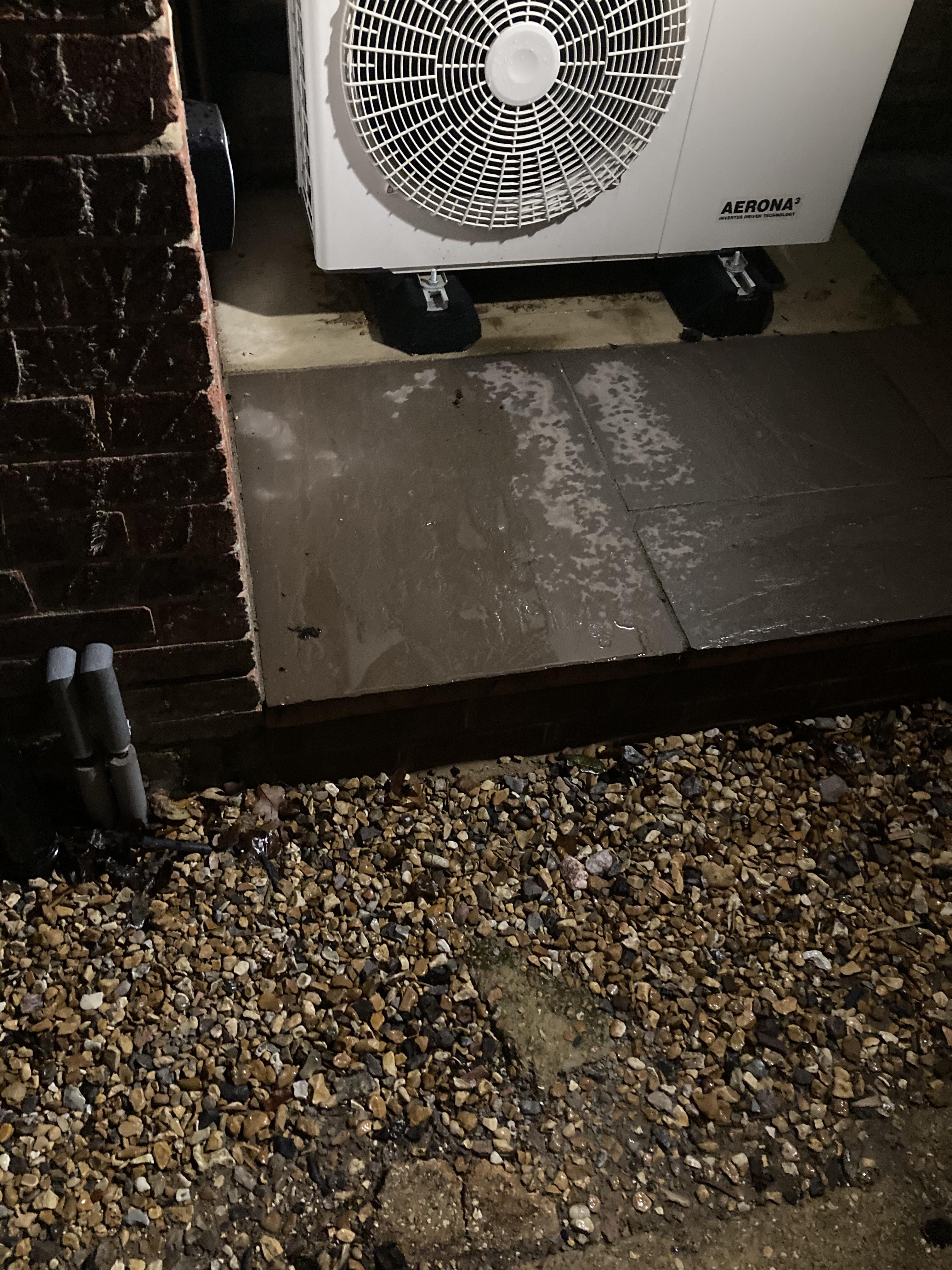

sirpatchuk Posted November 28, 2022 Author Share Posted November 28, 2022 I have also seen that the patio slabs are very wet (not from rain!) around the ashp… can anyone explain is this is normal… Link to comment Share on other sites More sharing options...

Miek Posted November 28, 2022 Share Posted November 28, 2022 The moisture on the slabs could be the HP entering its defrost cycle. This happens at low outdoor temperature and high humidity and reduces the COP somewhat. If the unit is short cycling then go out and watch the rear of the heat exchanger to see if it's frosting up. Link to comment Share on other sites More sharing options...
JohnMo Posted November 28, 2022 Share Posted November 28, 2022 Just looking at the position where your pump is mounted does not seem to comply with Grants defined clearance requirements. Which are, to the left 100mm that looks ok, but to the right they are looking for 600mm. The issue you could have the heat pump is constantly recycling cold air which will affect the performance. I would also make sure you don't have too many zones (areas with thermostats). Did the installer, also install a buffer? Link to comment Share on other sites More sharing options...

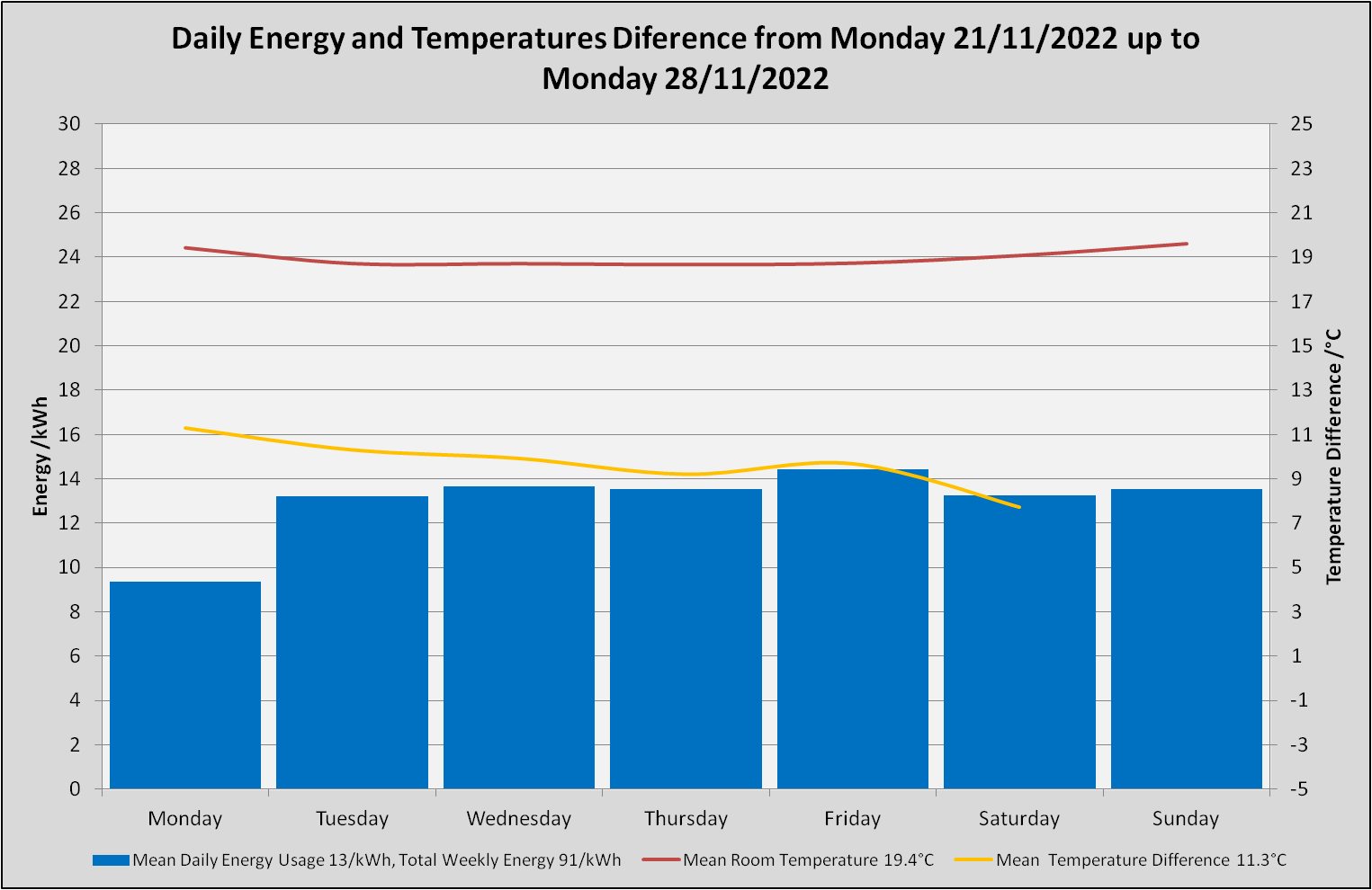

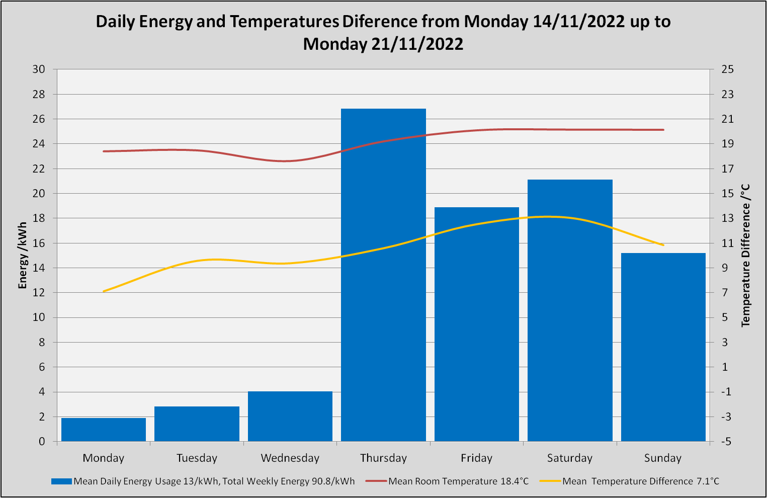

SteamyTea Posted November 28, 2022 Share Posted November 28, 2022 Just to elaborate on initial high heat demand when first turning on the heating. Here is the last couple of weeks data for my place, turned the heating on 17th November. Settles down to around 14 kWh/day. This includes DHW and everything else. 2 Link to comment Share on other sites More sharing options...

sirpatchuk Posted November 28, 2022 Author Share Posted November 28, 2022 31 minutes ago, SteamyTea said: Just to elaborate on initial high heat demand when first turning on the heating. Here is the last couple of weeks data for my place, turned the heating on 17th November. Settles down to around 14 kWh/day. This includes DHW and everything else. @SteamyTea This is with your storage heaters as opposed to an ashp? Link to comment Share on other sites More sharing options...

SteamyTea Posted November 28, 2022 Share Posted November 28, 2022 (edited) 52 minutes ago, sirpatchuk said: @SteamyTea This is with your storage heaters as opposed to an ashp? Yes, but it highlights how the whole building, as well as the air in it, needs to be heated up from a lower temperature. 51 minutes ago, ReedRichards said: You may have heard that UFH and an ASHP is cheaper to run than radiators and an ASHP Bit more complicated than that. It is the ratio of heated areas to heat loss areas and that governs temperature difference. But agree that you need relatively sophisticated control and monitoring to make a mix of UFH and radiators work well. Edited November 28, 2022 by SteamyTea Link to comment Share on other sites More sharing options...
