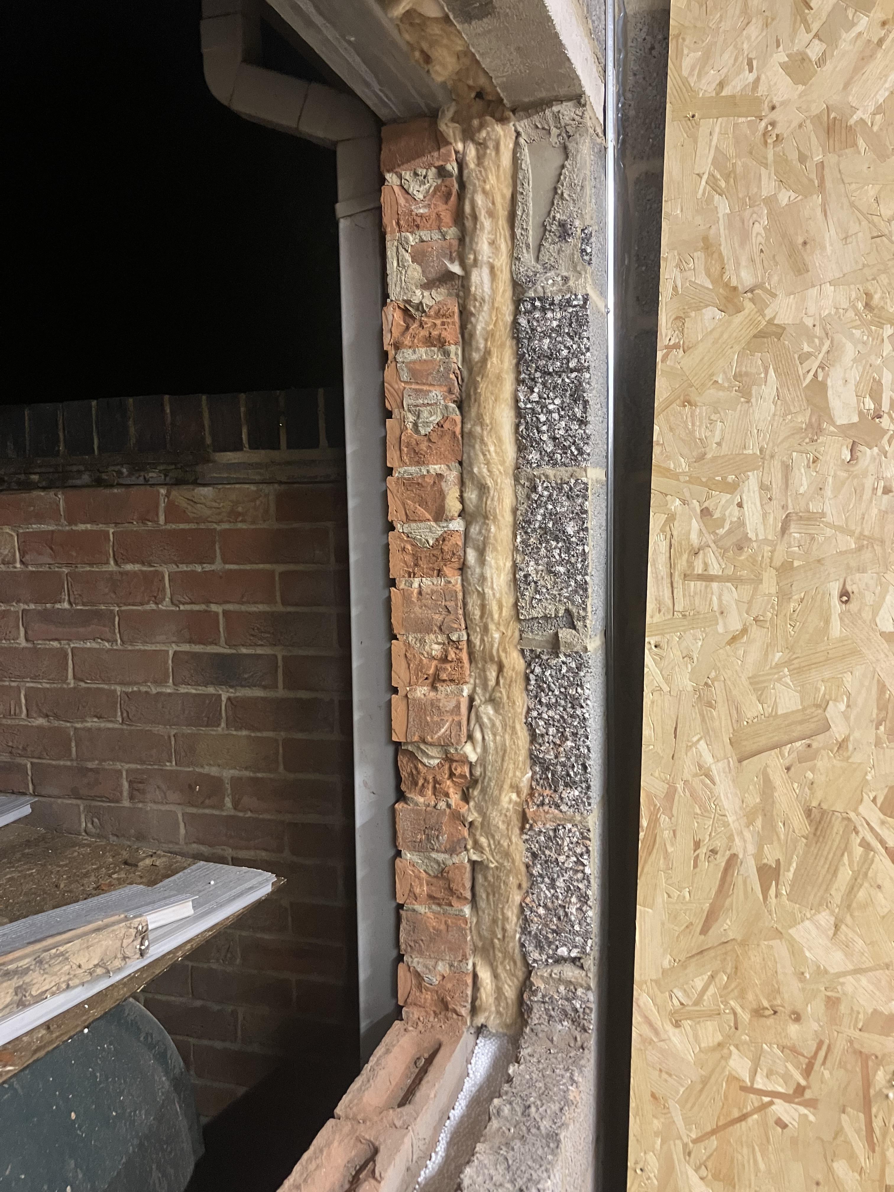

Jinglish Posted February 27 Share Posted February 27 I was thinking to do this myself and found this post. This is exactly what I need to do now and great to see the details of someone else, so well done and thanks for sharing! I have a double detached garage I'm splitting in half with a dividing wall however the envelope of the garage is 100mm brick then 70mm cavity then 100mm block. The current U-Value is around 1.1W/m2K, it would cost too much to insulate on the inside and lose precious volume so I'm going to fill it this way. I already have a leaf blower, compost bin and 32mm swimming pool flex hose. Luckily for me I can access the entire length of the cavity from the inside without having to drill any holes. I only need to insulate 2 walls as the front garage door is being replaced by glazing and the internal partition will be 75mm Kingspan stud wall so I calculate I need 1.6m3 of polystyrene beads. Building control regs says I need to meet 0.7W/m2K threshold for an "existing" element. I calculate it should be 0.39W/m2K after I finish so when the inspector comes round if he does look at this "existing insulated wall done by the previous owner" he will see it's insulated but more so I don't want to waste energy when we heat the new repurposed space. I'll come back and attach some images of my setup maybe in a few months time if I remember 1 Link to comment Share on other sites More sharing options...
Jinglish Posted April 11 Share Posted April 11 That’s to the OP for the inspiration My setup… >1800W leaf blower >70mm to 45mm silicone hose >45mm pipe >45mm to 32mm silicone hose >Henry hover adaptor >2m of 30mm swimming pool hose >Jubilee clips Hopefully the videos work and says it all. Thanks to this thread I hope my helps others too. IMG_2350 (online-video-cutter.com).mp4 IMG_2349 (online-video-cutter.com).mp4 1 Link to comment Share on other sites More sharing options...

Jinglish Posted April 12 Share Posted April 12 (edited) This was just me testing out that my setup works. Sure I'll come back in due course and share the finished result. That wall in the video is going to have a window cut out so I don't want to fill it yet or beads will go everywhere when we do the cut. There are YouTube videos of people in the USA doing the same thing with what appears to be cellulose. Edited April 12 by Jinglish Missed the cellulose question Link to comment Share on other sites More sharing options...

Jinglish Posted April 17 Share Posted April 17 Romeo Done! IMG_2479 (online-video-cutter.com).mp4 IMG_2487 (online-video-cutter.com).mp4 IMG_2480 (online-video-cutter.com).mp4 1 Link to comment Share on other sites More sharing options...
