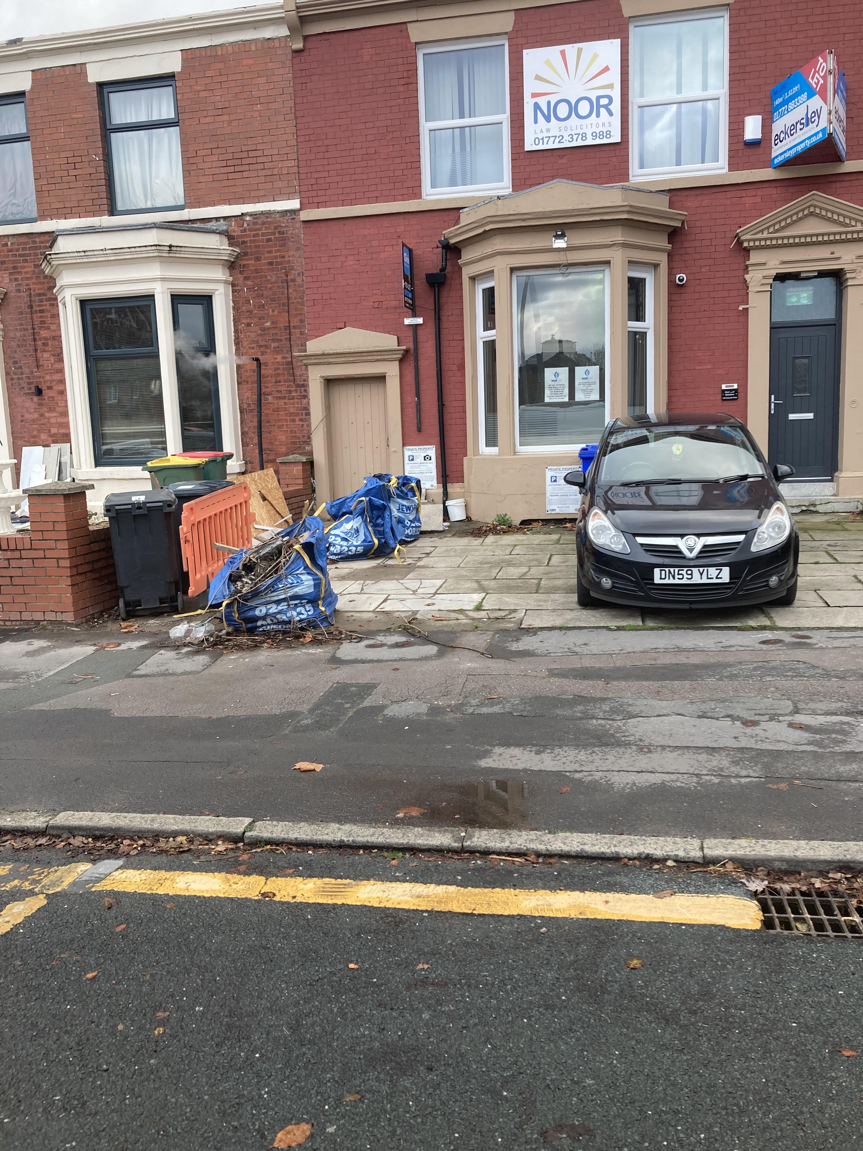

nod Posted November 18, 2022 Share Posted November 18, 2022 I drove past this today Newly fitted boiler in a basement 1 Link to comment Share on other sites More sharing options...
Pocster Posted November 18, 2022 Share Posted November 18, 2022 Doesn’t “look” legal ! . Can’t imagine that’s allowed!!! Link to comment Share on other sites More sharing options...
ProDave Posted November 18, 2022 Share Posted November 18, 2022 What are you looking at in that picture that is "illegal"? Link to comment Share on other sites More sharing options...
Mr Punter Posted November 18, 2022 Share Posted November 18, 2022 The flue / plume kit? Link to comment Share on other sites More sharing options...
ProDave Posted November 18, 2022 Share Posted November 18, 2022 You mean the house on the left not the one for sale? I wondered what that "periscope" was. Link to comment Share on other sites More sharing options...
jayc89 Posted November 18, 2022 Share Posted November 18, 2022 I believe it's legal to install a gas boiler in a cellar - we plan to do exactly this. I suspect the flue being at head hight, and not covered, and it being so close to the window do not comply with the regs though. Link to comment Share on other sites More sharing options...
Radian Posted November 18, 2022 Share Posted November 18, 2022 Flow & return temperatures too high if supposed to be condensing.🙄 Link to comment Share on other sites More sharing options...
JohnMo Posted November 18, 2022 Share Posted November 18, 2022 Not sure it matters too much where you locate the boiler, as long as the flue is installed correctly. If it's legal or not? But looks a bodge, it's not even straight. Link to comment Share on other sites More sharing options...
PeterW Posted November 18, 2022 Share Posted November 18, 2022 Boiler install in a cellar or basement is legal as long as it’s not LPG. Also has to meet all the regs for the flue which bizarrely that would as it is 300mm to an opening window… it does look though that someone has not bothered with a spirit level or enough flue supports !!! Link to comment Share on other sites More sharing options...
