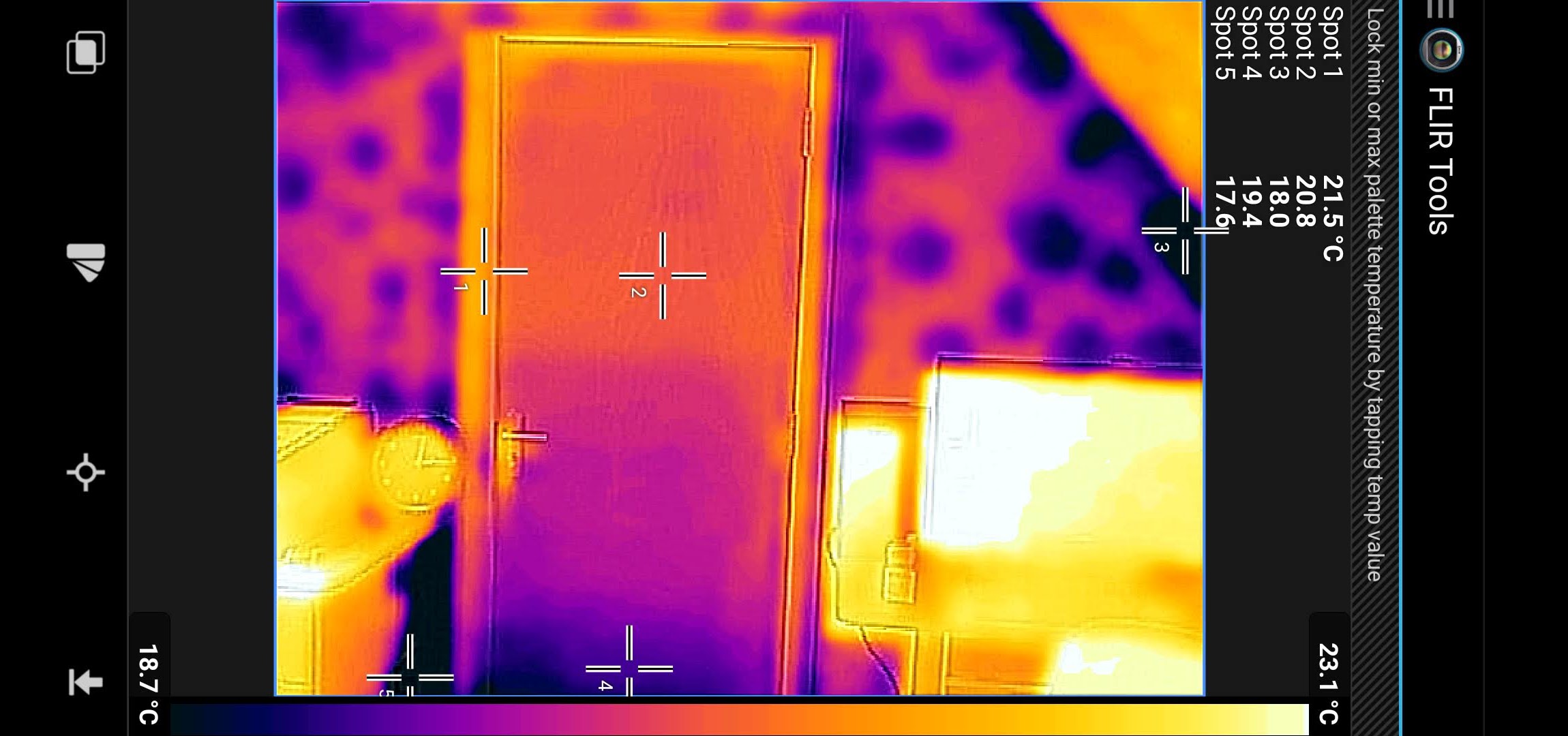

Just now, Thorfun said:
while I await a response from the SE I thought it'd be interesting to post a photo of our lovely warm (and dry!) floor in the basement taken with my new FLIR ONE Gen 3. 🙂
The Flir app ecosystem is a bit of a mess so In case you don't know, the Flir Tools app can be used to connect to the camera (not in all cases though) and provide multiple spot temperature readings - which can be positioned retrospectively.
  • Thanks 1
I thought multiple spot temperature readings was just on the Flir ONE Pro camera?
Link to comment
Share on other sites
I have the 1st gen Fir one and while the Flir tools app won't connect, I can use the image gallery to view photos I take with the bog standard app and call up additional spot readings at any time.
Link to comment
Cool. Will check it out. Thanks.
