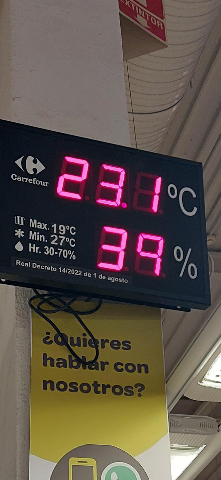

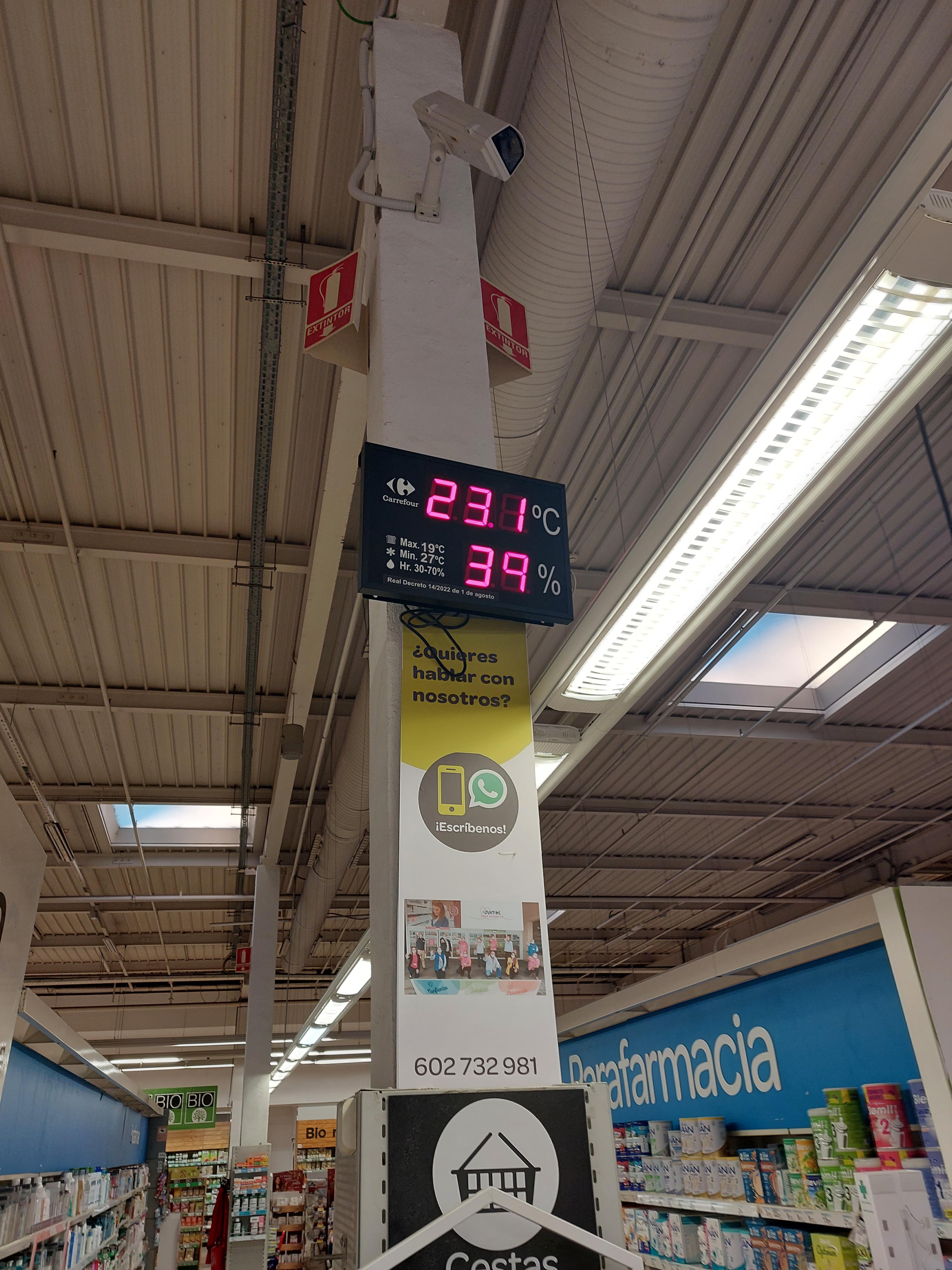

saveasteading Posted November 17, 2022 Posted November 17, 2022 To me this is very sensible. I took this picture in a Spanish supermarket. It confirms that it is the law (royal decree) to use sensible heating and cooling. No heating allowed above 19C and no cooling below 27C. Everyone seems happy with it all year, although it helps when the natural temperature indoors is 23C in November, aided by chiller waste heat of course. In fact I suspect that the heating/ cooling is seldom used as I have never seen the temperature being 19 or 27. If I was in charge in UK I would apply this immediately and permanently. 19C is just fine. A good idea to make it public too. 1
Thedreamer Posted November 17, 2022 Posted November 17, 2022 I totally agree with this. I apply a similar approach in my house. I don't need a constant temperature. I can live between 18c and heat the house to 23c with my wood stove. People are too soft, needing a consistent temperature all the time or the need to have warm feeling on their feet when they come out of the shower. Slippers and a jumper are fine even in a modern self build.
Redbeard Posted November 17, 2022 Posted November 17, 2022 I dream of 18 degrees! Lots of pullovers, and fingerless gloves. Definitely +1 to no silly temps, but at the other end of the scale for less mobile people there is the matter of safety, and potentially hypothermia if they cannot move much. Another argument for proper, sensible schemes of thermal improvement carried out by properly-trained contractors.
Radian Posted November 17, 2022 Posted November 17, 2022 Agreed. Caring for a 92 year old and 22oC is needed otherwise necessary clothing becomes too restrictive and creates mobility issues.
