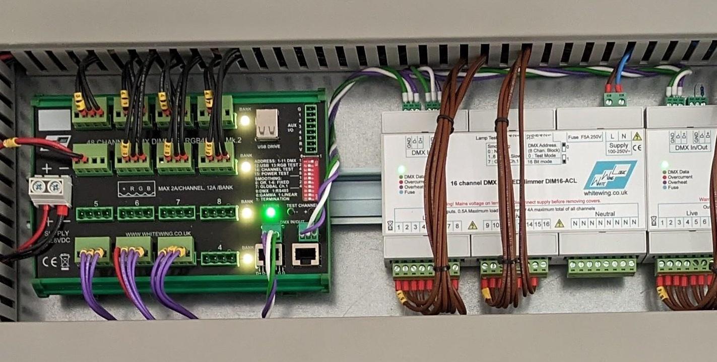

Thorfun Posted March 14 Author Share Posted March 14 qq. in the screenshot below from @joth's install I see it looks like he's using 1.5mm tri-rated cable for the DMX control wires. is there any reason to use this thickness of cable or will Cat6A cable suffice? if it's just a control signal then surely it doesn't need to be so beefy? Link to comment Share on other sites More sharing options...

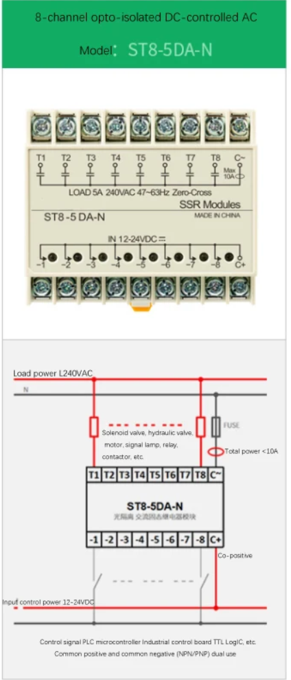

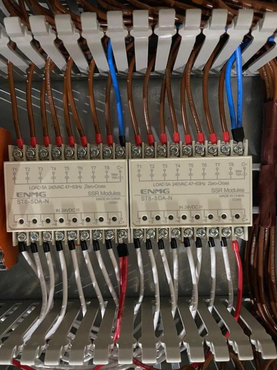

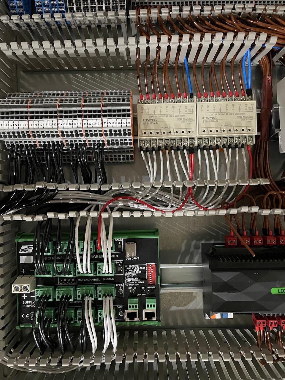

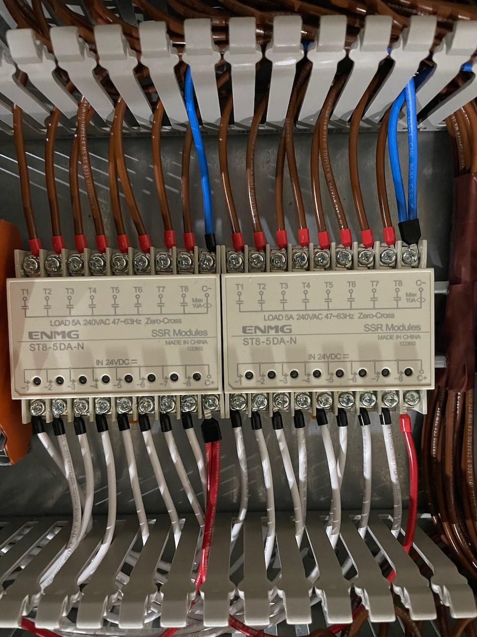

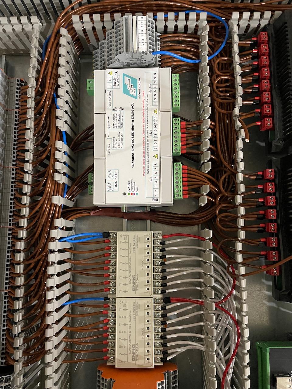

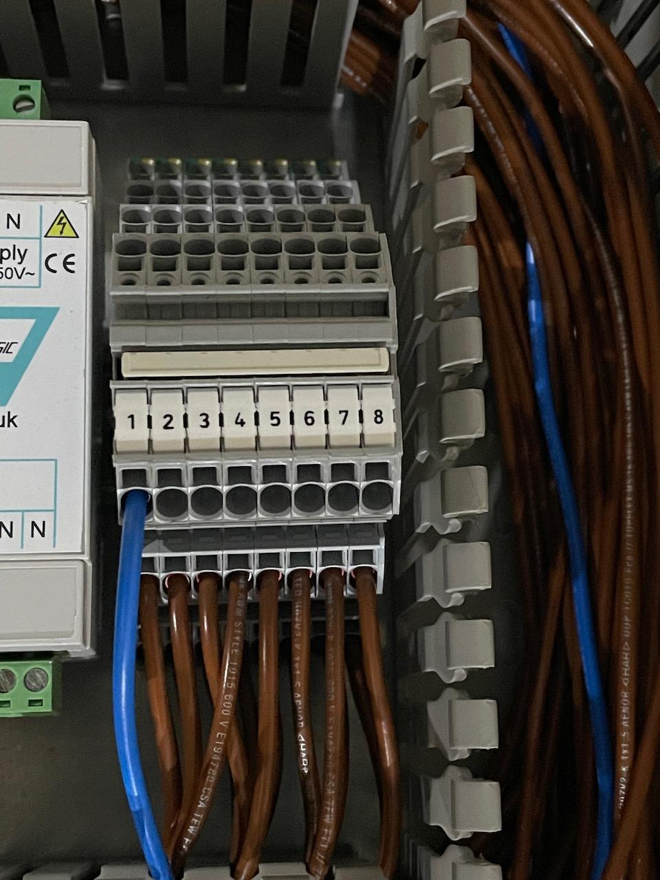

Thorfun Posted March 14 Author Share Posted March 14 afternoon all. I am nearing the end of my internal wiring for the cabinet but I need some help and error checking again please. (I'm sure you're not surprised). wiring up the blinds to be controlled by the Whitewing DMX 24V controller which trigger SSR relays. this is the wiring diagram for the SSRs all seems to make sense and here is my wiring of them. the SSR on the left is switching L1 for each blind and the SSR on the right is switching L2 for each blind where L1 and L2 are the 'up' and 'down' lives of the blind motors. all blinds will be run off the same RCBO. what I would like checking is: 1. the red wire from the WW DMX to the SSR. is what I've done correct? taken a +ve from a WW block to the common +ve of one SSR and then looped through to the other one. 2. the blue wire from the topside of the SSRs (labelled C~) loops from one SSR to the other and then heads off to the terminal blocks where it is commoned across all the TBs with a jumper. is that correct? Finally, I am confused as to the live outputs at the top of the SSRs. the diagram shows them joining a 240V feed. how, in practice, would I achieve what is in the diagram? the lives from the SSRs end up in the terminal blocks (photo above) with L1 being on the second level of the TB and L2 being the bottom level of the TB. do I add an extra terminal block to bring in the perm live feed from an RCBO and then jumper that across the lives on both L1 and L2? do I bring the live in to the SSR with a double ferrule at the 1st screw terminal and then do something with it there, i.e. double ferrule it along each screw terminal? Link to comment Share on other sites More sharing options...

joth Posted March 17 Share Posted March 17 (edited) On 14/03/2024 at 16:18, Thorfun said: the blue wire from the topside of the SSRs (labelled C~) loops from one SSR to the other and then heads off to the terminal blocks where it is commoned across all the TBs with a jumper. is that correct? No this is wrong. The SSR should have all brown (or all blue) wires on the 240v side, not a mix. Assuming you use them to switch the L rather than N then it should go: BROWN.= Rcbo L -> SSR common in -> SSR switched out -> TB -> load L BLUE= Rcbo N -> TB N (interconnected) -> load N Edited March 17 by joth Link to comment Share on other sites More sharing options...
Thorfun Posted March 18 Author Share Posted March 18 19 hours ago, joth said: No this is wrong. The SSR should have all brown (or all blue) wires on the 240v side, not a mix. Assuming you use them to switch the L rather than N then it should go: BROWN.= Rcbo L -> SSR common in -> SSR switched out -> TB -> load L BLUE= Rcbo N -> TB N (interconnected) -> load N thanks @joth for setting me straight. it's not surprising I get confused with all this stuff when the diagram for the SSRs show a Neutral coming out of the C~ terminal! I don't understand why the diagram would show that. it's more confusing that it says 'Total Power <10A' on the C~ connector with a fuse and joining the 'N' labelled wire. so confused. 1 Link to comment Share on other sites More sharing options...
dpmiller Posted March 19 Share Posted March 19 it's not unusual to switch on the neutral like that, means each item's supply can be individually fused. Plus there's something in the back of my head that it's electrically "quieter" but I'm not sure where I'm recollecting that bit from, lol. 2 Link to comment Share on other sites More sharing options...
joth Posted March 19 Share Posted March 19 12 hours ago, Thorfun said: thanks @joth for setting me straight. it's not surprising I get confused with all this stuff when the diagram for the SSRs show a Neutral coming out of the C~ terminal! I don't understand why the diagram would show that. it's more confusing that it says 'Total Power <10A' on the C~ connector with a fuse and joining the 'N' labelled wire. so confused. The main error in their diagram is showing the switched wires from SSR to load as red (hot) colour, they should be neutral colour if it's illustrating switched neutral. But as you've already done them in brown I'd keep with switched live, which effectively means just swap the N and L labels on their diagram. Use brown for everything on the live side on the load, blue for everything on the neutral side of it. Switched live is more common in UK as it means a light bulb that is off does not live at it's (handily finger sized) bulb holder, etc. Switching neutral is just as valid electrically, but I think what makes more difference for making them electrically quieter is that they are zero-crossing switching 1 Link to comment Share on other sites More sharing options...
Thorfun Posted March 19 Author Share Posted March 19 8 minutes ago, joth said: The main error in their diagram is showing the switched wires from SSR to load as red (hot) colour, they should be neutral colour if it's illustrating switched neutral. But as you've already done them in brown I'd keep with switched live, which effectively means just swap the N and L labels on their diagram. Use brown for everything on the live side on the load, blue for everything on the neutral side of it. Switched live is more common in UK as it means a light bulb that is off does not live at it's (handily finger sized) bulb holder, etc. Switching neutral is just as valid electrically, but I think what makes more difference for making them electrically quieter is that they are zero-crossing switching 2 hours ago, dpmiller said: it's not unusual to switch on the neutral like that, means each item's supply can be individually fused. Plus there's something in the back of my head that it's electrically "quieter" but I'm not sure where I'm recollecting that bit from, lol. thanks guys and it kind of makes sense. will update the cabinet wiring accordingly. 🙂 Link to comment Share on other sites More sharing options...
