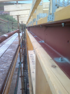

PeterW Posted June 26, 2017 Posted June 26, 2017 Can anyone point me at the latest wisdom on attaching timber roof plates to steel beams ..? We have two purlins that have the rafters up against them and I was expecting a small birdsmouth on each to slot onto the top plate attached to the RSJ. Previously I've used a spit/Hilti gun to pin them to the top webs however I've been told that's no longer the correct approach ... So I am assuming it's drill and Coach bolt but is that correct and what spacing ..? SE can't help as he just did the steel sizings and doesn't do domestic work anyway.
Nickfromwales Posted June 26, 2017 Posted June 26, 2017 Pilot drill and then fire these straight in, being careful not to catch the web. 1
jamiehamy Posted June 26, 2017 Posted June 26, 2017 I used a magnetic drill and put through M12 coach bolts with washers. Bit footery but ain't going anywhere. 1
PeterW Posted June 26, 2017 Author Posted June 26, 2017 1 hour ago, Nickfromwales said: Pilot drill and then fire these straight in, being careful not to catch the web. Perfect thanks @Nickfromwales
ToughButterCup Posted June 26, 2017 Posted June 26, 2017 The pilot drill size is critical Pete. Got it wrong once and the roof (lean-to) got wrenched off. There might be guidance somewhere about the correct pilot hole size.....
Nickfromwales Posted June 26, 2017 Posted June 26, 2017 12 minutes ago, recoveringacademic said: The pilot drill size is critical Pete. Got it wrong once and the roof (lean-to) got wrenched off. There might be guidance somewhere about the correct pilot hole size..... Deffo. Tbh, you just undersize by 1.5-2mm and the self cutting tip is the right size for the final pilot . Used these to put steel tubular stairs and handcrails in an ind unit. Worked a dream. It won't hurt to put a bead of summat but if you can fix both sides it'll go nowhere. Do you need SE spec for the thickness of the fixings for BC approval?

vfrdave Posted June 29, 2017 Posted June 29, 2017 My SE specified 8mm diameter bolts at 600 centers staggered either side of web
