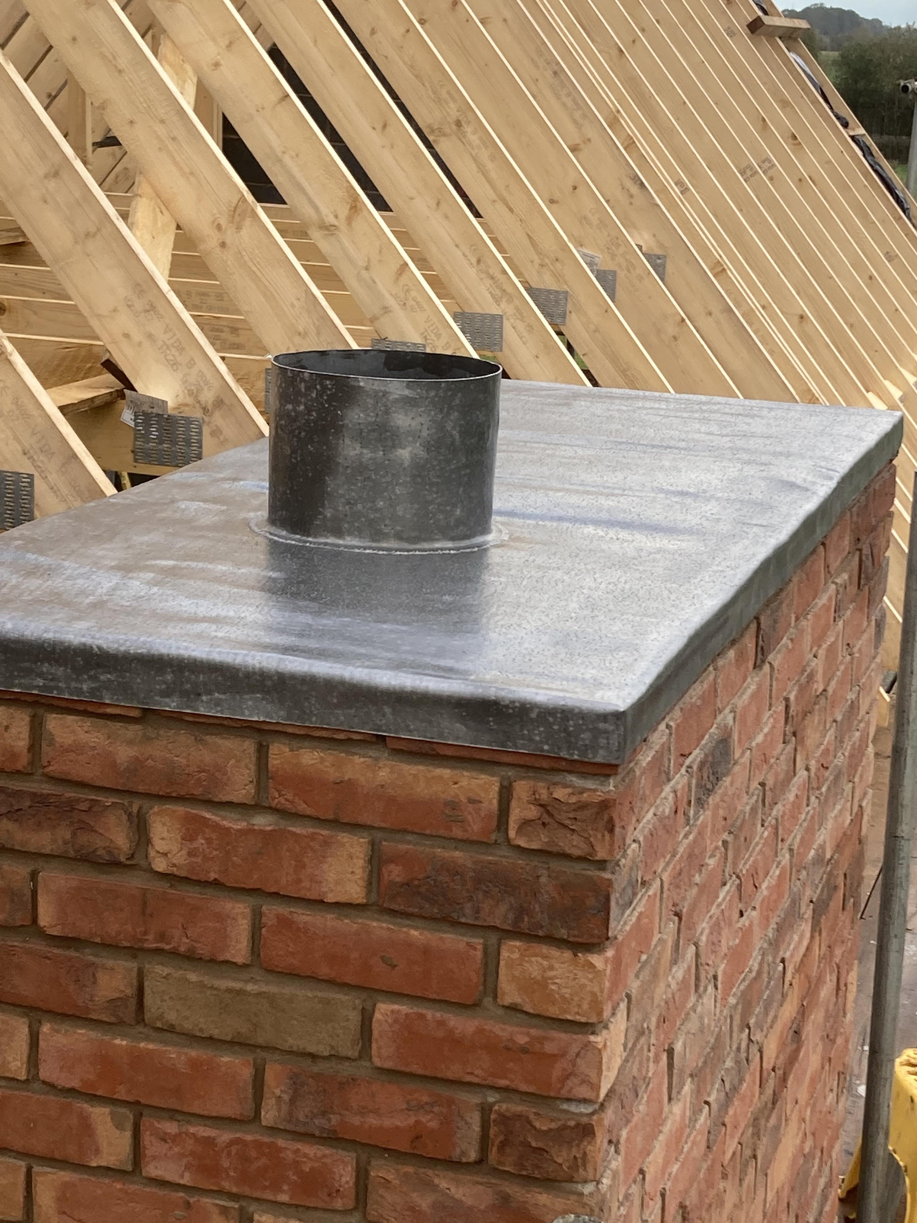

nod Posted October 28, 2022 Posted October 28, 2022 My friend Vash turned up this morning and made me a lead ray in the back of his van Very skilled 4
joe90 Posted October 28, 2022 Posted October 28, 2022 That’s an art, lead welding, I have tried it, very difficult, 👍

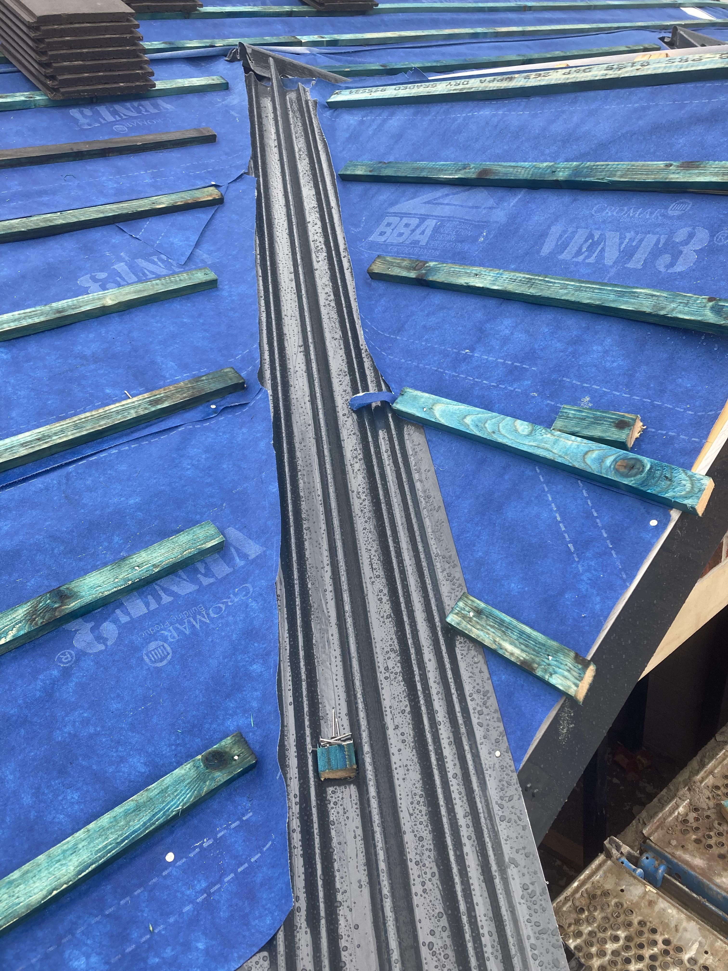

nod Posted October 28, 2022 Author Posted October 28, 2022 I can still remember the plumbers doing the lead work Now the roofers do this

nod Posted October 28, 2022 Author Posted October 28, 2022 39 minutes ago, Gus Potter said: Ah.. appreciate your frustration. That chimney cap leadwork is great.. lifts your spirits.. then.. next day your "baw is burst" You'll know that lot needs lifted, the battens and vapour barrier sorted etc. I get it too, one day great work from the builders.. next day they have put the wrong brain when going to work. But we all have "off" days! This is on a site with 33 staff in the site office Five quality control guys wandering around Leas slate on our first build No reason to change
Dave Jones Posted October 29, 2022 Posted October 29, 2022 10 hours ago, nod said: I can still remember the plumbers doing the lead work Now the roofers do this Klober have new closers to go with the dry vallys, very nice they are too. https://www.roofgiant.com/grp-valley-troughs/dry-valley-closure/
PeterW Posted October 29, 2022 Posted October 29, 2022 10 hours ago, nod said: I can still remember the plumbers doing the lead work Now the roofers do this Not quite sure how they have cocked all that up but it looks messy !!! Right hand side membrane is under the tray at the bottom but should be over the edge of it. Tray should have its own underlay too - can’t see if that’s been done. Hard to see too if battens run to the edge of the tray correctly. another 5 mins spent on that and they would have done a decent job.

Mr Punter Posted October 29, 2022 Posted October 29, 2022 That lead must weigh a fair bit. What is underneath to support it?
