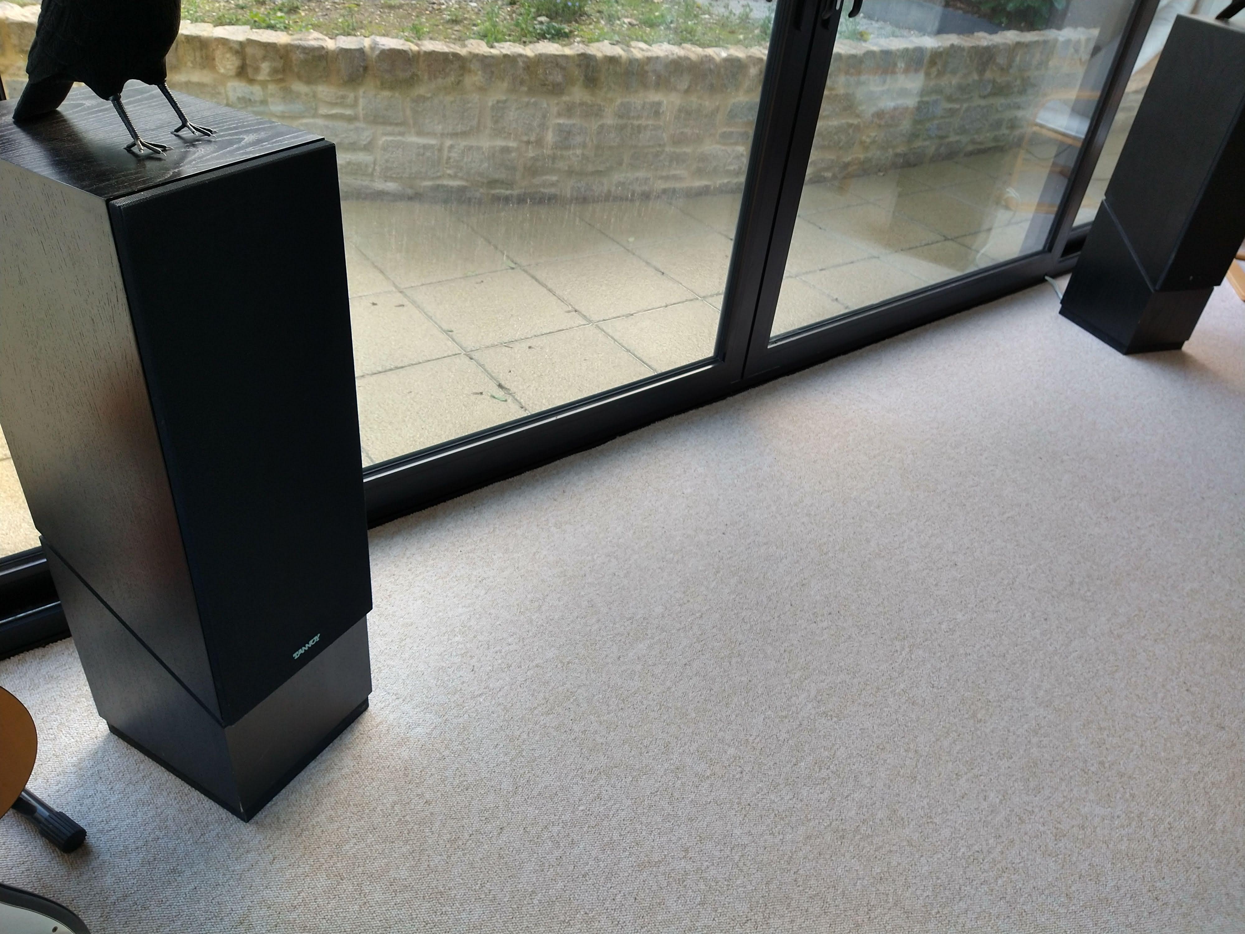

Radian Posted October 27, 2022 Posted October 27, 2022 Problem:- the speakers in our cinema room are not against a wall but sit in front of a 6m wide glazed sliding door unit. The central two sliders are the main way in and out of the building and up until now we've been regularly tripping over the speaker cables lying loose along the floor. Not any more! So I finally plucked up courage and attacked my aluminium framed sliders with a 20mm drill bit 😱 Having seen the profile of the aluminium extrusion when I visited the factory that produced them, it struck me that there was a continuous channel running the entire length. It's been playing on my mind ever since. I did toy with the idea of sticky-backed black trunking but it would have been just too vulnerable on the threshold area. So what if they cost a few thousand quid, it's only a few holes. I finally caved when I drilled the first (test) hole and checked I could pass a conduit draw tape the full length. The 20mm holes I've made also accept standard electrical box grommets and blanking plugs and was reassured by how well the blanking plug disguised the holes if I ever change my mind. Thought I'd share this hack in case it gives anyone else the courage to make use of their frames in a similar fashion. Not that anyone else would be daft enough to build a cinema room with fully glazed walls like this. 3

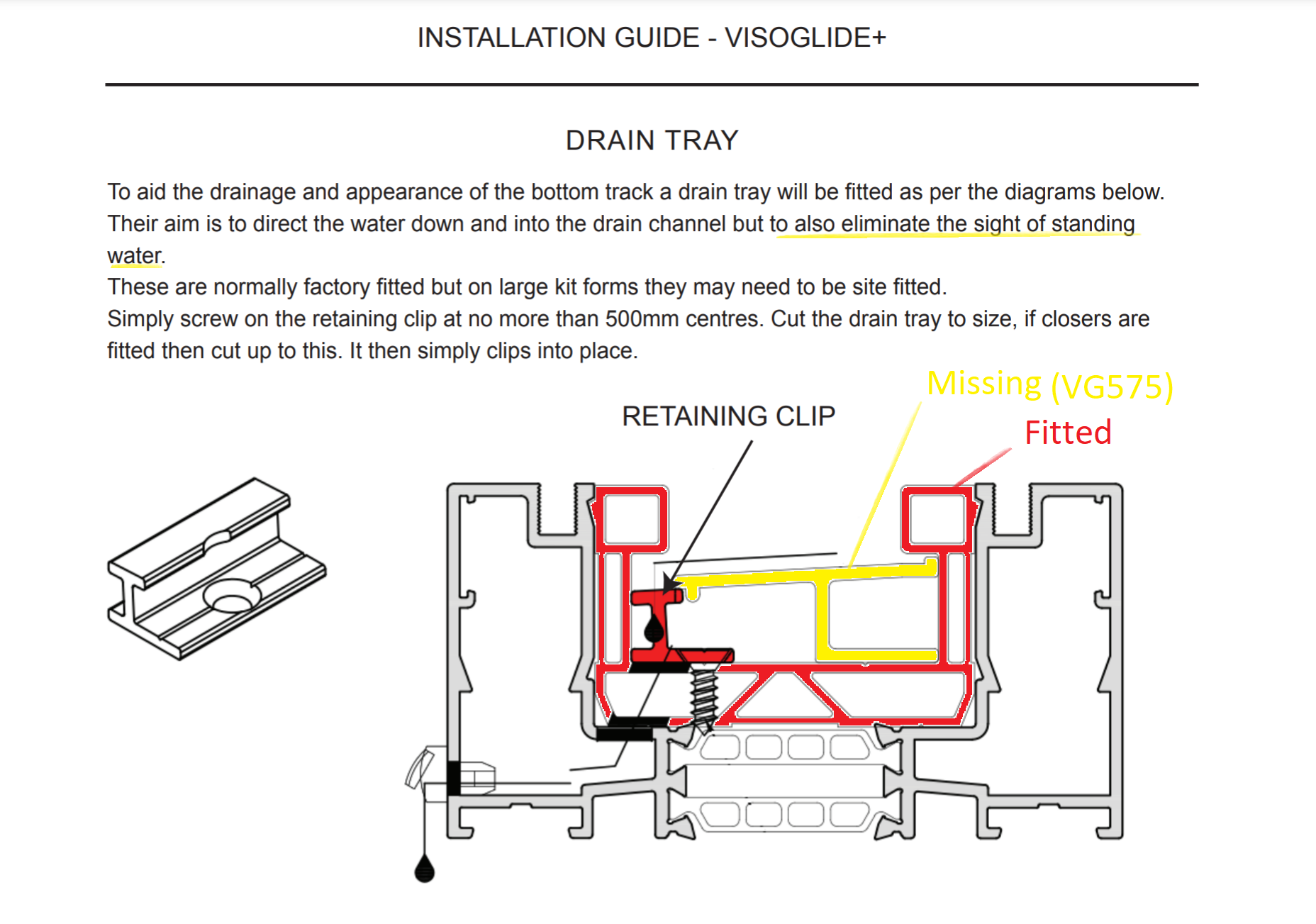

Nickfromwales Posted October 28, 2022 Posted October 28, 2022 @Radian Check with the window profile to make sure that’s not a drainage channel, as you may get water in it if there’s a downpour if so. If that section is purely a threshold you should be good 👍 The super flat speaker wire is another solution. Lay it next to the carpet grippers, and it’s ok to take a bit of traffic if you tape it well. Only prob is you can’t go round bends with it so point-to-point only, or bend it over itself to turn at your own discretion ( strictly no traffic at that point btw ). Biggest regret for my home audio days was selling my Kef Ref 104.2’s. 😑.😥 Kept my Yamaha DSP A2, just too good to punt out at the couple of hundred I’d struggle to sell it for today. Monster power out of that thing!
