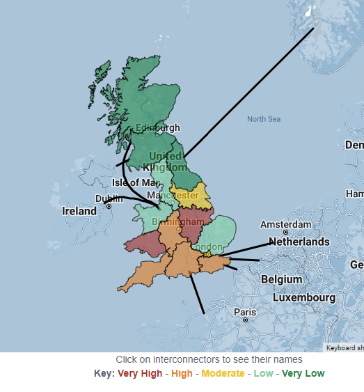

JamesPa Posted October 27, 2022 Posted October 27, 2022 (edited) 2 hours ago, nod said: ASHPs Are they greener than gas NO Not at the moment Because most of the electricity generated to run them are relying on gas Er - your conclusion is simply incorrect. It is true that grid electricity is currently very slightly more 'dirty' than gas per unit of energy (kWh) input (https://www.gov.uk/government/collections/government-conversion-factors-for-company-reporting). However an ASHP uses between one third and one quarter as much energy for a given energy output. So for each kWh you put into an ASHP you get between 3 and 4kWh out. This overwhelms the slight difference between the emissions per unit of energy input, and as a consequence an ASHP heating system has roughly a third the carbon footprint (or better) of a gas one. The comparison with oil or resistance electric heating is similar. So to be crystal clear, ASHP reduces the carbon footprint of a traditional home heating system (gas, electric or oil) by a factor of 3-4. That's a pretty spectacular reduction. Edited October 27, 2022 by JamesPa 1

Green Power Posted October 27, 2022 Author Posted October 27, 2022 4 hours ago, JamesPa said: Er - your conclusion is simply incorrect. It is true that grid electricity is currently very slightly more 'dirty' than gas per unit of energy (kWh) input (https://www.gov.uk/government/collections/government-conversion-factors-for-company-reporting). I´m not sure even that is true. If the grid is a mix of gas and renewables, surely it is a cleaner than gas. (There is hardly any coal.) Couldn´t quite find the answer in your source, although I only had a couple of minutes to spare to check. But, this is a question about whether heat pumps are 70% better on climate change or 85% better, but it´s clear that they are better. I have done a calculation for my specific case which I can share another day in a separate article.

JamesPa Posted October 27, 2022 Posted October 27, 2022 38 minutes ago, Green Power said: I´m not sure even that is true. If the grid is a mix of gas and renewables, surely it is a cleaner than gas. (There is hardly any coal.) Couldn´t quite find the answer in your source, although I only had a couple of minutes to spare to check. But, this is a question about whether heat pumps are 70% better on climate change or 85% better, but it´s clear that they are better. I have done a calculation for my specific case which I can share another day in a separate article. As you say electricity is a is largely of renewables and gas, so prima facie you might expect it to be cleaner than gas. I'm guessing, however, that electricity system losses are much bigger, so by the time its delivered to the consumer that counteracts the 'at source' benefit. The official conversion factors are on the 'fuels' tab (natural gas - gross - 0.182 kg(e) per kWh and on the 'UK electricity' tab ().191 kg(e)/kWh. The electricity figure has come down (got better) in each of the four years I have had a reason to look at these numbers. As you say this makes a difference between heat pumps being something like 70% better or something like 85% better. At this stage that's not a material difference, what is material is that this is a factor of 3 or 4 and will improve during the lifetime of the unit, because the electricity grid is decarbonising. My personal calculations on relative lifetime cost have gas and heat pump coming out roughly equal to within the quite considerable uncertainty on the figures (even more uncertainty since energy prices are essentially artificial). 'Roughly equal' is definitely good enough given the environmental benefits, particularly as the gas boiler is reaching the end of its useful life. Mind you I'm doing some of the work myself!

Green Power Posted October 27, 2022 Author Posted October 27, 2022 Steamy Tea, thanks for the carbon intensity graph. However, it shows carbon intensity now or tomorrow. What would be more useful would be the average for 2021, and the average for 2022 so far. Hugh F, Your 86 Baxi lasted longer than my 2011/2012 Baxi. Thanks for all the comments on boiler longevity. I may have been pessimistic on my gas boiler longevity by the look of all your feedback. But note that however long gas boilers last will have a minimal effect on the relative cost vs heat pump, since the running costs are the majority of the costs.

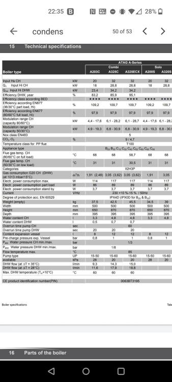

JohnMo Posted October 27, 2022 Posted October 27, 2022 The only thing to say in defence of a gas boiler is the 80% efficiency, is not always the case. If you compare it on a like for like basis i.e. on low flow temperatures, a part load efficiency is being quoted for our boiler (Atag A325ECX) of 109.2%, with a flow temp of 36/30 return. When looking at DHW with flue gas heat recovery it is being quoted as annually 95%.
HughF Posted October 27, 2022 Posted October 27, 2022 22 minutes ago, JohnMo said: The only thing to say in defence of a gas boiler is the 80% efficiency, is not always the case. If you compare it on a like for like basis i.e. on low flow temperatures, a part load efficiency is being quoted for our boiler (Atag A325ECX) of 109.2%, with a flow temp of 36/30 return. When looking at DHW with flue gas heat recovery it is being quoted as annually 95%. Yep, but we need to remember the great condensing boiler con 🤣 I would wager that 80% of condensing boilers are installed on rads that require deltaT50 and they’ll be setup with on/off controls. They for sure won’t be running at your exemplary 109.2%
