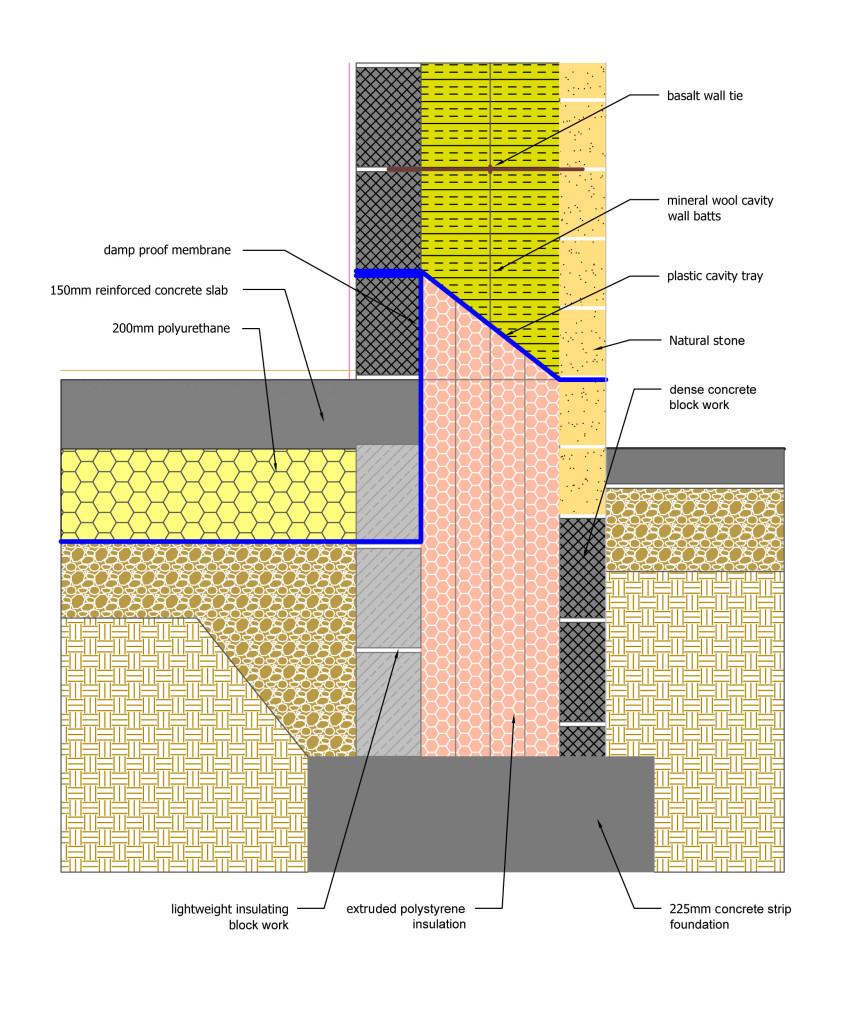

joe90 Posted October 21, 2022 Share Posted October 21, 2022 I had a quote fir a raft just fir my garage and it was huge so went with strip foundations. Fir the house I also went this way as no SE involved, BC okayed the trench and used this method to avoid thermal bridges. (My builder altered it slightly to reduce the “slip plane” above the skirting board). Link to comment Share on other sites More sharing options...

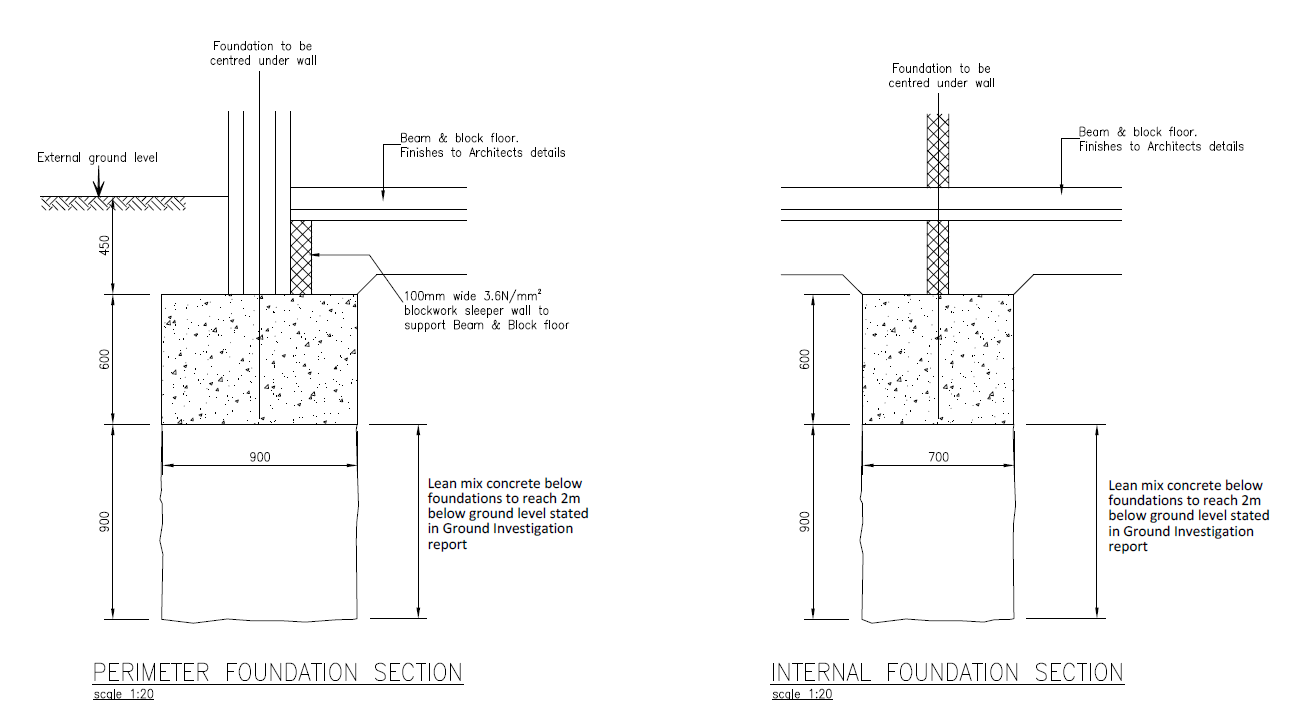

Selfbuildnewbie Posted November 11, 2022 Author Share Posted November 11, 2022 This is what has been designed using strip foundations. Looks pretty straightforward to me but I know nothing about this sort of thing. Won't there be thermal bridging where the ICF walls meet the foundations? Looking at what @joe90 posted (cavity wall rather than ICF but not sure why that should make a difference), should there be some insulation to remove the thermal bridges? Also is some blockwork below ground on the outside of the ICF walls? Above ground will be brick slips, not shown on drawings. Link to comment Share on other sites More sharing options...

IanR Posted November 11, 2022 Share Posted November 11, 2022 1 hour ago, scottishjohn said: block and beam can be every bit as effective with UFH Agreed, if only considering the performance of the floor. The air temp under the B&B being a lower temp than the ground under a raft won't have that much effect on the overall performance. The external walls and internal load bearing walls however, will perform far less well in a strip foundation with B&B setup due to the cold bridging. 1 hour ago, scottishjohn said: i beleive block and beam will be cheaper to do and if self build a job you can do yourself Probably worth pricing both out to check on that. You'd need to include the cost of insulation and screed on the B&B floor to compare to an insulated raft. An insulated raft is not difficult to do, well, at least up to the pour. On your first one it would be worth getting a ground works team in to help with the pour and power-float to de-risk that part. That would be a days work for a team of 3 or 4. AFT will come and do it with 1 person, if you supply a couple of labourers. 1 Link to comment Share on other sites More sharing options...
scottishjohn Posted November 11, 2022 Share Posted November 11, 2022 50 minutes ago, IanR said: The external walls and internal load bearing walls however, will perform far less well in a strip foundation with B&B setup due to the cold bridging I would like to see you quantify the real difference remeber that fully insulated foundation rafts to pour your floor and wall footing into come from countries with much harsher climates or even permo frost my average winter temp in s/w scpt;and is +3c not -15c or worse for months at a time likein northern european countries where these came from I doubt the extra 10K for the insualted raft will ever pay itself back just my view and full concrete raft floor will be more expensive than B+B hence why B+B they are used so much in uk they are cheaper to and if DIY it don,t get any easier and you have to option to correct any mistakes on drainge penetrations until you screed it I have no issues with the insulated raft system other than it seems OTT for this country Link to comment Share on other sites More sharing options...

saveasteading Posted November 11, 2022 Share Posted November 11, 2022 Please excuse if I have missed something but my thoughts are.. The cross sections are a bit vague. Where is the floor insulation/dpm? Why an extra block to support the beams, is the outer wall existing? Yes there is a cold bridge..this can be sorted but needs more detail. 2m deep footings. Presumably there are trees about 10m away , at all sides. Ask the local concrete company what their cheapest mix is. Leanmix is fine, but I would just ask in case they have a mix with bigger stones, or single sized, etc that might save a lot. I don't follow what the line under the beams denotes. It looks like a slab but it perhaps is ground....it should say on the drawing. 700 and 900 seem very wide trenches. Others tell please...Scottish regs used to require a solum ( stone or something) below a suspended floor. Does that apply? Link to comment Share on other sites More sharing options...
IanR Posted November 11, 2022 Share Posted November 11, 2022 29 minutes ago, scottishjohn said: I would like to see you quantify the real difference Only by doing the heat loss calcs, which I did for my current property, but I never compared insulated raft v. B&B with all else equal, so could not pick out the delta for that comparison. Mine was a walk from a heat loss of around 55kWh.m²/year for a "traditional" conversion (from a cow shed) to a little under 15kWh.m²/year for what I eventually built. The big factors in that improvement was good floor/wall/roof insulation levels, high performing windows and doors, no cold bridges and very low infiltration rate. What percentage of the improvement is down to the insulated raft + elimination of cold bridges I don't know. The decision was made easy for me as when I actually costed both options, and included insulation and screed costs for the B&B option, the insulated raft was cheaper. Link to comment Share on other sites More sharing options...
