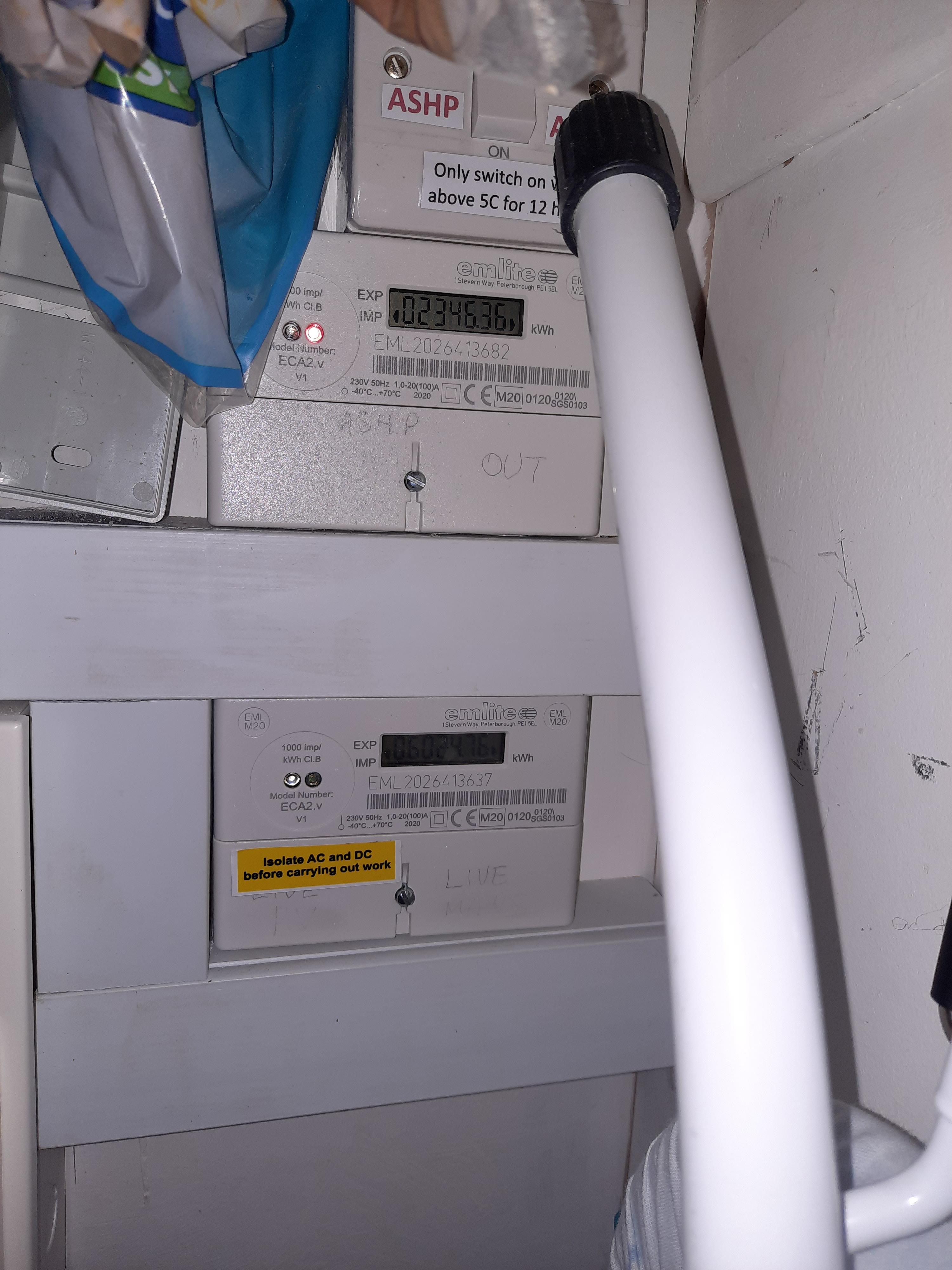

PhilT Posted October 19, 2022 Posted October 19, 2022 quote from a supposedly reputable manufacturer "...power consumption in standby mode should only be measured by use of a Watt hour meter to give a true figure, due to the nature of an inverter driven unit. Measuring current with a clamp meter and then calculating using P = V I pF will give higher readings than the system is actually consuming..." so to get a representative measurement you would need to switch absolutely everything off except the HP and watch your main meter reading over at least an hour.
Marvin Posted October 19, 2022 Author Posted October 19, 2022 (edited) On 19/10/2022 at 13:39, PhilT said: quote from a supposedly reputable manufacturer "...power consumption in standby mode should only be measured by use of a Watt hour meter to give a true figure, due to the nature of an inverter driven unit. Measuring current with a clamp meter and then calculating using P = V I pF will give higher readings than the system is actually consuming..." so to get a representative measurement you would need to switch absolutely everything off except the HP and watch your main meter reading over at least an hour. Expand Yes like this set up with a separate meter altogether : Edited October 19, 2022 by Marvin clarification
SteamyTea Posted October 19, 2022 Posted October 19, 2022 (edited) On 19/10/2022 at 13:39, PhilT said: quote from a supposedly reputable manufacturer "...power consumption in standby mode should only be measured by use of a Watt hour meter to give a true figure, due to the nature of an inverter driven unit. Measuring current with a clamp meter and then calculating using P = V I pF will give higher readings than the system is actually consuming..." Expand While true, there is a difference between showing under 20W and 200W. It is too easy to say that because something is not 100% accurate it is not worth doing. There are also statistical methods that can reduce the uncertainty. Edited October 19, 2022 by SteamyTea
Radian Posted October 19, 2022 Posted October 19, 2022 (edited) On 19/10/2022 at 14:28, SteamyTea said: While true, there is a difference between showing under 20W and 200W. It is too easy to say that because something is not 100% accurate it is not worth doing. There are also statistical methods that can reduce the uncertainty. Expand Sorry to say the power factor may be such as to make VA look ten times as much as real (actual) power. A clamp really isn't good enough. A revenue grade meter like @Marvin uses is perfect but a bit of an overkill. Any meter that displays PF (possible example) should also report real power. Edited October 19, 2022 by Radian
Kevm Posted October 20, 2022 Posted October 20, 2022 On 19/10/2022 at 15:28, Radian said: Sorry to say the power factor may be such as to make VA look ten times as much as real (actual) power. A clamp really isn't good enough. A revenue grade meter like @Marvin uses is perfect but a bit of an overkill. Any meter that displays PF (possible example) should also report real power. Expand Can you explain why a clamp meter doesn't work? I assume these meters measure current and then work out power from an assumed 240v?
SteamyTea Posted October 20, 2022 Posted October 20, 2022 On 19/10/2022 at 15:28, Radian said: Sorry to say the power factor may be such as to make VA look ten times as much as real (actual) power Expand In very rare circumstances. To get an idea as to how much energy is being used, they are adequate in this circumstance, especially if the crankcase heater is resistive, or acting as a resistive load. On 20/10/2022 at 10:16, Kevm said: Can you explain why a clamp meter doesn't work? I assume these meters measure current and then work out power from an assumed 240v? Expand It is because with AC, the current and the voltage are out of phase. When voltage is crossing the zero voltage point, current is infinite. To find out true power there is a lot if calculating to do during each cycle to find out, at any given point, what the actual power is. Root Mean Square is one method that is fairly easy as it, in effect, makes all the numbers positive. So less calculations to do. Another method is to take the area under each curve during a cycle, then multiple those areas. That is the integration method. Hard work if calculated manually. What usually happens with cheap clamp in meters is that a power factor gets assumed, often between 90 and 95%. So the meter over reads sometimes, and under reads others. But on average, it evens out. 2
Radian Posted October 20, 2022 Posted October 20, 2022 On 20/10/2022 at 10:34, SteamyTea said: To get an idea as to how much energy is being used, they are adequate in this circumstance, especially if the crankcase heater is resistive, or acting as a resistive load. Expand I've not been paying particular attention to what's being measured because it's best not to assume the type of load. Some of these compressors use DC PWM to double-up the motor windings as heaters and that would sure as heck give a misleading reading.
SteamyTea Posted October 20, 2022 Posted October 20, 2022 On 20/10/2022 at 13:25, Radian said: I've not been paying particular attention to what's being measured because it's best not to assume the type of load. Some of these compressors use DC PWM to double-up the motor windings as heaters and that would sure as heck give a misleading reading. Expand Probably all explained here. https://www.tek.com/en/documents/application-note/power-analysis-pwm-motor-drives
Radian Posted October 20, 2022 Posted October 20, 2022 In an AC inverter driver the rectification and capacitive smoothing stage upstream of the PWM switching transistors typically has a power factor of around 0.65 or less.

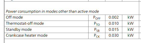

PhilT Posted October 24, 2022 Posted October 24, 2022 Just did another check over 2 hours with everything else switched off. Main meter readings give 40W per hour total which is 15W for the compressor heater (per data sheet) and by difference must be 25W for the control system. Model is Ecodan R32 11.2kW
SteamyTea Posted October 24, 2022 Posted October 24, 2022 On 24/10/2022 at 10:34, PhilT said: Main meter readings give 40W per hour total Expand Now it isn't. W is the power and is multiplied, not divided, by time.
PhilT Posted October 24, 2022 Posted October 24, 2022 On 24/10/2022 at 11:00, SteamyTea said: Now it isn't. W is the power and is multiplied, not divided, by time. Expand yes sorry picking up bad habits. Power draw = 40W. Daily = around 1kWh

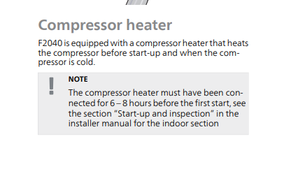

Marvin Posted October 26, 2022 Author Posted October 26, 2022 On the Samsung ESH ones the crankcase heater kicks in when below 10C!!
Marvin Posted October 26, 2022 Author Posted October 26, 2022 On 24/10/2022 at 10:34, PhilT said: Just did another check over 2 hours with everything else switched off. Main meter readings give 40W per hour total which is 15W for the compressor heater (per data sheet) and by difference must be 25W for the control system. Model is Ecodan R32 11.2kW Expand For your information. I think the 112 is the 11.2kW model Manufacturer Model Numbers Date of manual Page on manual comment Mitisibishui Ecodian PUHZ 50, 85, 112,140 ? 2 and 7 Turn on at least 12 hours before operation.
dpmiller Posted November 2, 2022 Posted November 2, 2022 So I finally have an instance of the heater coming on. Displayed external temp was <9C and the crank heater was noted to come on for a short time during startup and as the unit ramped to capacity. The chassis (anti-ice) heater was called for a while too *after* startup I can't be sure whether these events occurred purely at the 9C threshold or if coil or evap temp was relevant too so will continue to monitor. Certainly the unit didn't appear to be sitting with the crank heater on for hours on this occasion... 1
